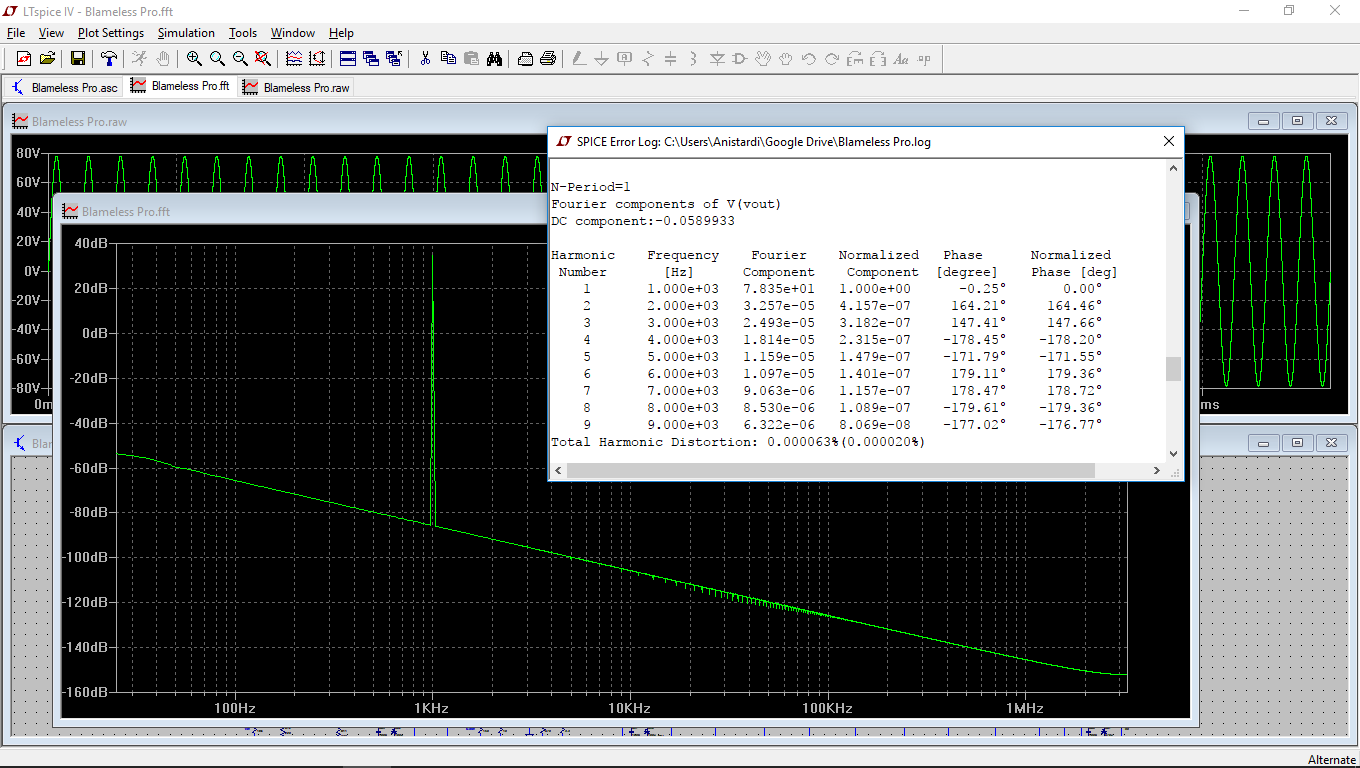

I simulated my circuit it in LTSpice, and was surprised that the effect of input current distortion was much much lower in the simulation than what is found in Self's book...

So then I was thinking again: Self says that it is the nonlinear Ib (base current) that creates this distortion as it flows through the serial input resisitor (or the feedback network). Now LTSpice MUST account for that, don't you think? Isn't the exponential Ib-Vbe curve the basic equation of a BJT?
So this would be my question. Is it possible that the simulation is right that input current distortion is really not of major concern as long as I don't aim for ultra low distortion? But then what did Mr. Self measure in his book?
If you ever start thinking that a simulation proves the measurements wrong, alarm bells should start ringing. THD measurement is very straightforward with the right equipment and it's not hard to do it right.
On the other hand, SPICE simulation, while an extremely powerful tool, has to be wielded with great care. All semiconductors of the same type are absolutely identical, which is not how the real world works, and can lead to some subtle errors.
SPICE also uses approximations to model the variation of hfe with Ic, and Early effect, in BJTs.
I think these factors are enough to explain any differences between your simulations and my measurements.

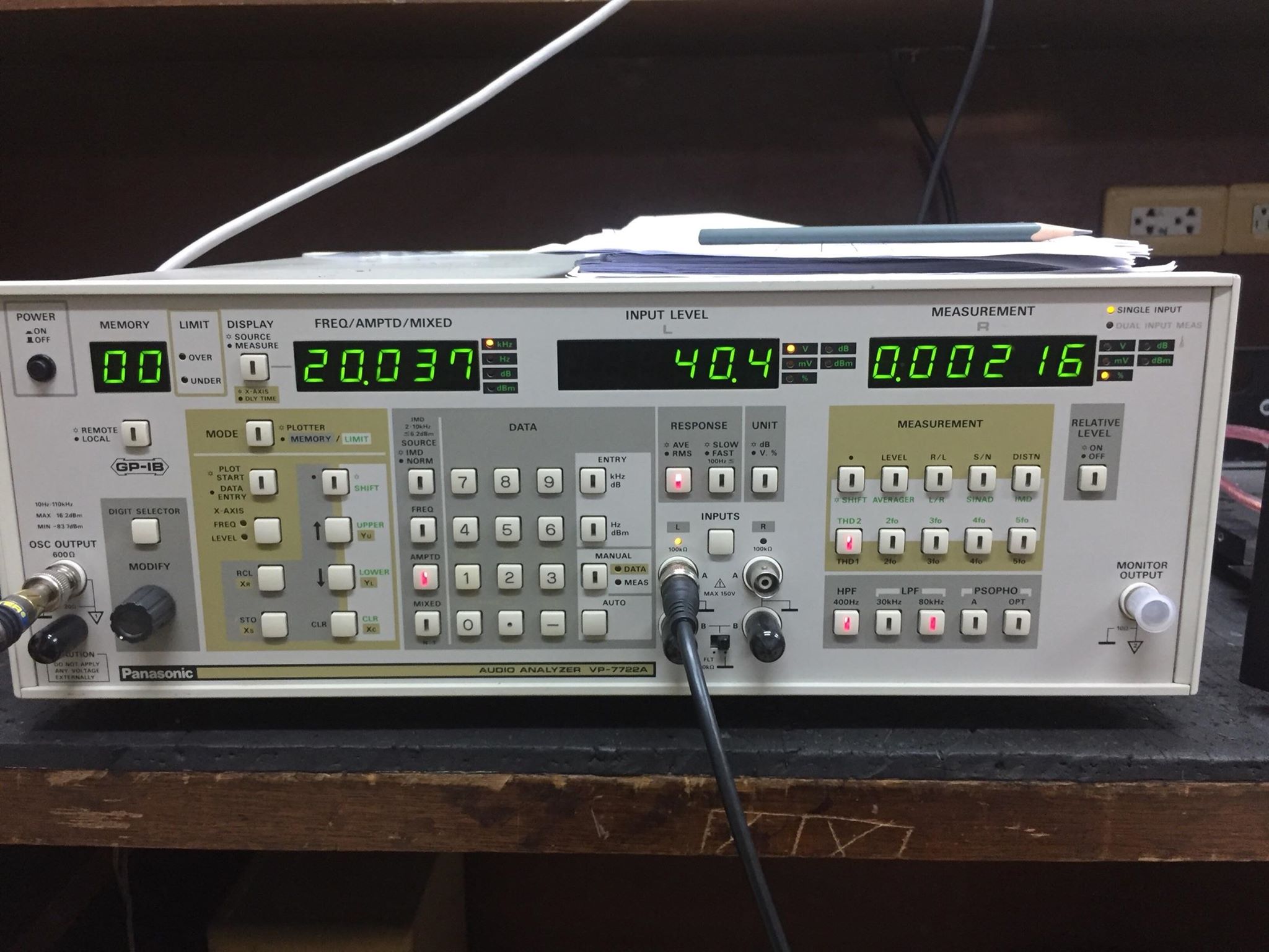

I use 90VDC PSU and got THD at 384W/8Ohm, 1kHz -> 0.000061%
H2 was slightly reduce.

Hi bimo,
This came from your simulated circuit. In real life it will not be as good, no matter how good implementation is.
I have built enough circuits and measured them to know, and I do match my transistors very closely using a jig I designed for that very purpose.
Notice that I am not saying the design isn't good. All I am saying is that your quoted "measurement" will not reflect real life. It would help if you didn't post such optimistic figures. It doesn't do anyone any good.
-Chris
Hi bimo,
I don't think it will be close to simulation given those extraordinary low THD numbers. Maybe not 100X worse (but it could be depending on the circuit layout).
There are too many factors that can reduce performance. Devices differing from each other and from the bogey device the simulator uses for one. PCB layout can destroy performance easily. Even voltage dependence resistors and capacitors have will prevent reaching such a low level of THD. If your simulation indicates 0.004 %, I can see it being close, but you are quoting 0.000061%. Even the ability to measure distortion that low is beyond any normal test procedure. It doesn't take much to throw off a circuit that is supposed to perform at levels like that.
I'm reasonably certain that the real circuit will not perform anywhere near the numbers you quoted. Not because it is a bad circuit, or you aren't a good builder. It's because extremely high performance is very difficult to actually achieve.

I agree, it is very difficult to achieve. But it is possible to achieve 0,0001% PGP. Although, my amplifier THD in 20kHz is much higher than that amplifier. But for high power amplifier, it is good enough.
The increase in distortion you described with source impedance of 1k compared to nearly zero was not subtle, and SPICE, even with its approximations to the real world, should have picked it up, especially if decent transistor models are being used. SPICE and real-world measurements each have their individual shortcomings, and to blindly believe in either one's results alone is unwise. When they conflict significantly, it is important to drill down to find and understand the source of the difference. It was never clear from your discussion in the book as to what you thought the specific technical reason was for the increase in distortion with the increase in source impedance. An increase in source impedance at some point will not surprisingly lead to an increase in distortion, but why it led to an increase of the degree you reported at the source impedance of only 1k was not explained by you. Tell us what you think the cause was and we can look at it more closely.
