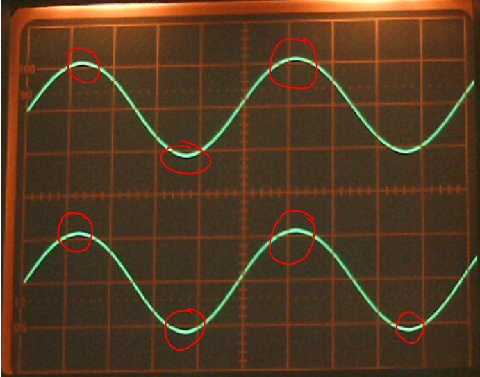

Low level male speech can be very revealing of crossover distortion I used to find. Its quite educational to take an amp down to zero bias if you have never done so and actually hear for yourself what the distortion sounds like. Once heard, never forgotten, and you would instantly recognise the characteristic sound again. Not all amps will allow the bias to be turned to zero though... a piece of wire across the vbe multiplier might be needed to force it to zero.
Our hearing is incredibly sensitive to this type of distortion. Take a look at the image here (which I grabbed from one of my threads). This is 1kHz from a function generator and the top and bottom of the sine have a small glitch... bit hard to see in the picture... but this is immediately obvious when listened to as a harsh edge to the sine. Switch to a wien bridge osc (or CD test disc) and the sound is pure.
Thanks for the kind words re the O2. I can't quite remember how I got roped into that thread 😉
Brings memories of my first function gen. Typically for a square wave gen that is turned into a triangle wave through a current source charging/discharging a cap, than a weighted diode network for sine shaping.
ICL8038 or XR2206 I would guess? 😎
