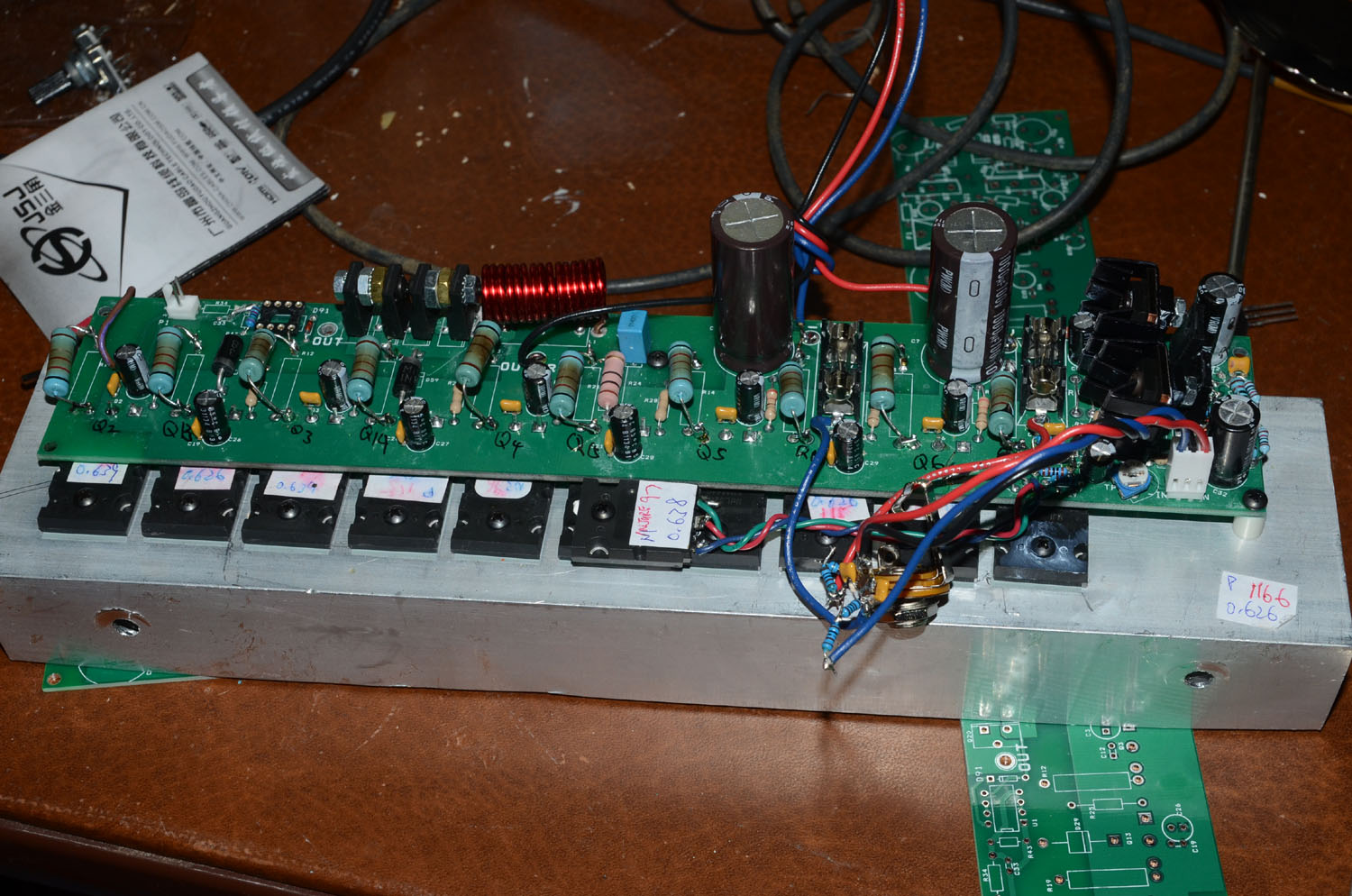

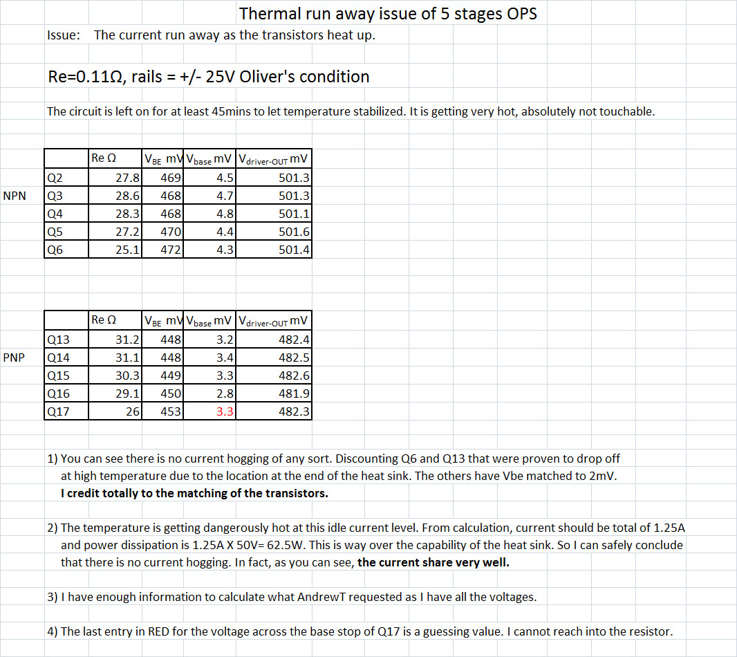

Hi
As promised, I redo the testing using Re=0.11ohm. Here is the result.
1) I adjust to Oliver's condition which is about 250mA/stage and total of 1.25A.
2) I run 25V rail, it is getting dangerously hot as it is 62.5W on this small heat sink.
3) I waited for 45mins for the circuit to get hot and stablized before I did the measurement.
4) The circuit is ROCK STABLE from room temp to untouchable hot. The voltage across the Re did not vary more than 2mV from cold to hot. Using the MJW transistor works perfectly.
5) There is absolutely no current hogging, as from yesterday, Q6 and Q17 being at the cooler side, pulling a little less current than the others. The Vbe of the rest of the 4 NPN and 4PNP both have Vbe matched to 2mV.
6) The first column of the table is the voltage across the Re, second column is Vbe of that transistor, third column is the voltage across the base stop resistor.
7) The 4th column is the sum of the first three column. This is what AmdrewT wants to plot the graph.
8) The voltage of base stop for Q17 in RED is my guess, I could not reach it.
My conclusion is you can use 0.1ohm as in my case of 0.11, there is absolutely no current hogging. I believe you have to match transistors. I credit the good result to transistor matching.
I only have 7zip, I don't have zip program, if someone can give me a link to a zip program, I can zip it and post the two excel files.
Alan, the problem occurs when the devices get really hot before the Vbe multiplier can kick in - 150C in worst case. Furthermore, thermal gain is proportional to Vce so 25V is not enough to show dangerous behavior. These results aren't applicable to 60V rails.
I don't think you can go 60V rail!!! I did a lot of calculation, even with my real chassis, I doubt I can do 40V rail. 1.25A X 80V = 100W per side and 200W total for a stereo. You are going to have air conditioning for the room!!!
To do any better than my chassis, you are going to have to dole out $500 for a better one!!! AndrewT and others know my chassis, I can't get over 70W idle per side. And from what I saw, I truly believe it....In fact, I won't go beyond 60W.
The Vbe spreader works perfect. As I wrote already, there is no current hogging, the current did not vary over 5% from room temperature to very hot. The thermal compensation works perfect. Chuck it to beginner's luck, I hit it on the nail using the MJW as spreader that match the tempco.
This is an experiment since everyone is talking about the 0.1ohm. Now at least we have some solid data to look at.
I have no intention using 0.1ohm at all. It is scary. You'll be scare if you are in the room feeling the heat and the smell!!! I might.....just might go 0.18 or 0.15. Not 0.1.
