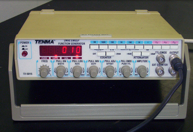

Brings memories of my first function gen. Typically for a square wave gen that is turned into a triangle wave through a current source charging/discharging a cap, than a weighted diode network for sine shaping.
ICL8038 or XR2206 I would guess? 😎
Jan
Yep, plenty of diodes but the generator is a Tenma 72-5015, mainly discrete (quite a few transistor arrays- CA4046/56 from memory) and quite complex actually, but it does have the diode strings easily visible on the pcb.

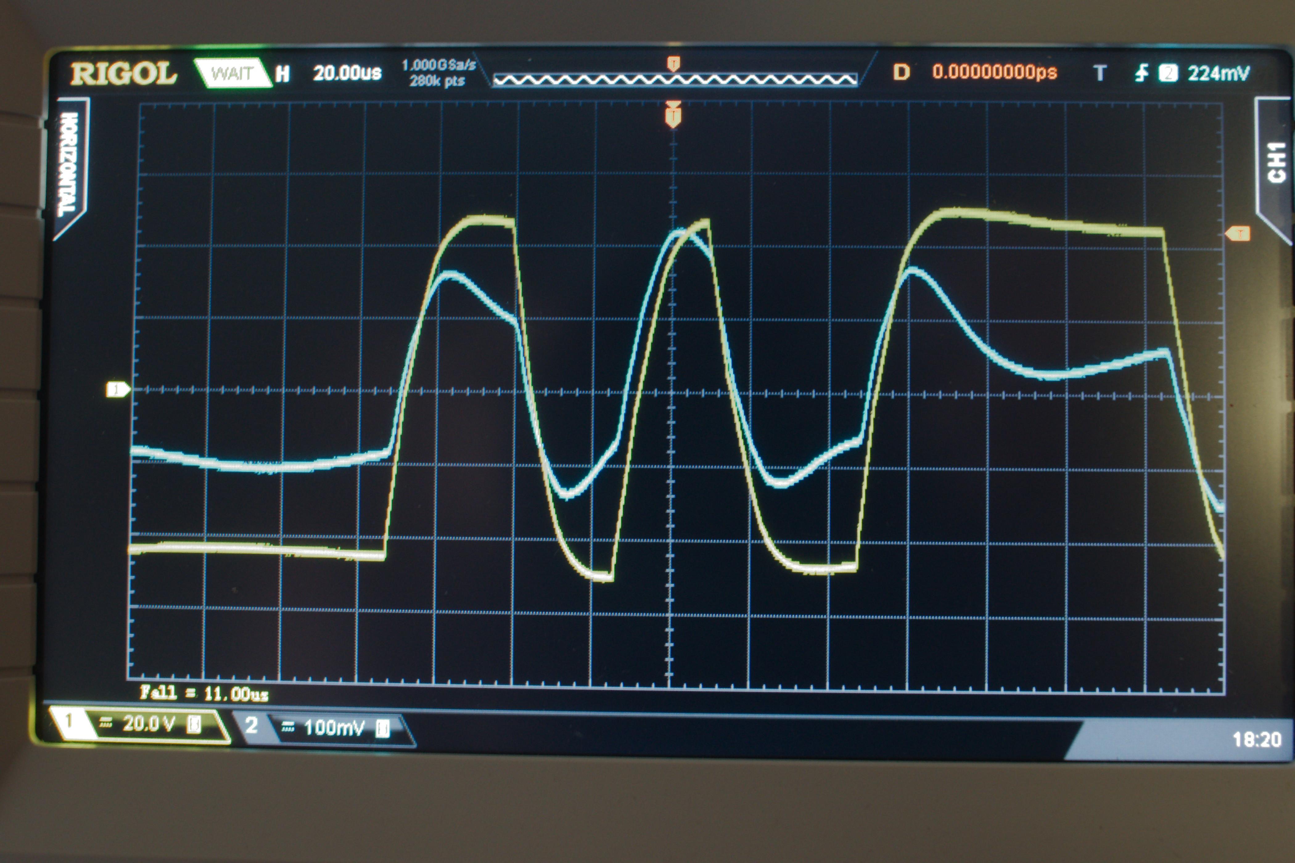

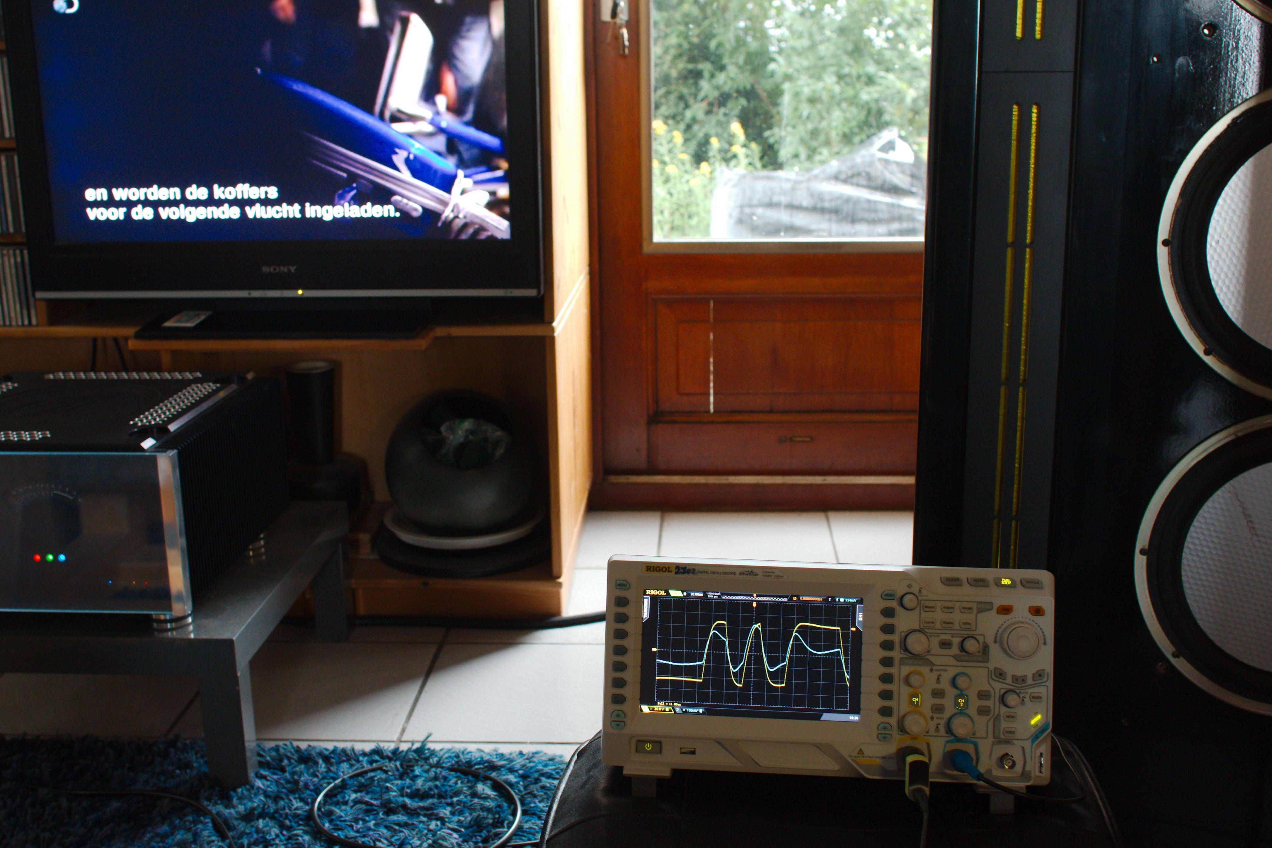

This is a 100W (+-50Vcd PSU) amplifier in normal operation. The blue trace is from the current probe and measures 10A/div (the maximum current shown is about 22A). Braking even normal operation, with an relay, is difficult under stress it will be even more difficult.
What is the load during this measurement?
100W into 8r0, or 8ohms(with some L&C), or 4r0, or 4ohms(with some L&C)?
The load is a 8-ohm (nominal) loudspeaker system. Carver Amazing Platinum Edition. This is an magneto stat (2 pcs 70cm(28") line sources) with 4 cone (25cm(10") diameter) woofers in a panel.
There it is 🙂 A picture telling more than a 1000 words. The 'load' can also be seen 🙂

The 22Apk from a 100W amplifier into 8ohms speaker indicates an effective impedance of 1.82ohms., (40Vpk/22Apk = 1.82ohms)
If I change the driving voltage to 47Vpk, then the effective impedance becomes 2.14ohms.

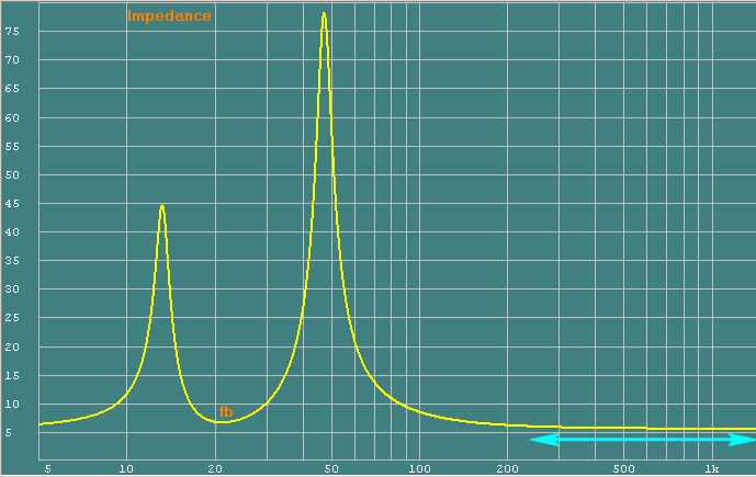

I'm sure it is back-emf that creates the behavior. I did try to find the measured impedance graph of the loudspeaker but could not find it, the impedance meter is at the moment not here. So one has to give this a bit of time.
If I understood the non believers correctly, then you don't need an impedance value. They claim that the DC resistance defines the worst case peak current demand.

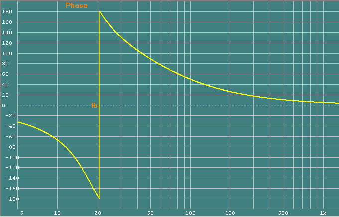

But if they meant the minimum impedance just above the resonant impedance peak where reactance is now zero (phase has returned to zero degrees), then impedance at this frequency will need to be measured.
By the way it's a fairly easy value to find and measure. Just look for and measure the lowest voltage across the speaker after feeding the test signal in via a 1k0 resistor.
Because phase has returned to zero the reactance is also zero and thus the value measured is the non reactive impedance.
The low point is likely to occur in the frequency range from 100Hz to 300Hz. And it will be quite a broad minimum so even a small frequency error still allows one to get a reasonably close estimate of this impedance low.
