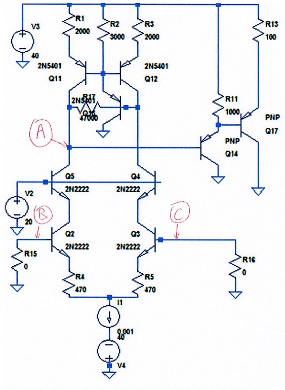

I used LTspice to simulate and experimented to see what is the most sensitive part. Attached is the LTspice schematic file and a JPEG film with points where I measured. I have two schematics, the right side is used as control. I change components in the schematics on the right only.
The main thing I am looking at is point A as this translates directly to the current of VAS. I use only one side of the complementary LTP. The result should be the same with the other side in as it can only add error, it will not subtract even if you think the other side is PNP and reduce the offset. It's the deviation of the offset, not the absolute offset that matters. Here is the result:
1) Q2=Q3=2N2222, R15=R16=25K, point A=37.996V point B=-52.19mV point C=-52.19mV.
2) Q2=2N4124, Q3=2N2222, R15=R16=25K, point A=38.6V point B=-61.5mV point C=-54.5mV.
3) Q2=2N2222, Q3=2N4124, R15=R16=25K, point A=37.4V point B=-54.5mV point C=-61.5mV.
Next I grounded the base of Q2 and Q3 to eliminate the offset due to base current:
1) Q2=Q3=2N2222, R15=R16=0K, point A=38V
2) Q2=2N4124, Q3=2N2222, R15=R16=0K, point A=38.32V
3) Q2=2N2222, Q3=2N4124, R15=R16=0K, point A=37.68V
Next I test the effect of changing of Q11 and Q12 with Q2=Q3=2N2222. I keep R15 and R16=0ohm to concentrate on the contribution of mismatch of Q11 and Q12 only.
1) Q2=Q3=2N2222, R15=R16=0K, Q11=Q12=2N5401 point A=38V
2) Q2=Q3=2N2222, R15=R16=0K, Q11=2N3907, Q12=2N5401, point A=37.86V
3) Q2=Q3=2N2222, R15=R16=0K, Q11=2N5401, Q12=2N3907, point A=38.125V
Conclusion:
Mismatch of Q2 and Q3 with input resistance of 25K is +/-0.6V
Mismatch of Q2 and Q3 with input grounded is +/-0.32V
Mismatch of Q11 and Q12 with input grounded is +/-0.137V
From the data, I concluded that Q2 and Q3 mismatch is the major problem. Half of the problem is due to the input offset voltage due to the base current.....Which is the Beta difference.
Q11 and Q12 mismatch only contributes relative minor problem.
The result is very discouraging. I am glad I took the time to do the simulation. The only way to reduce the problem is to use
1) Matched pair for Q2 and Q3 as well as the PNP counter part. The match pairs are expensive.
2) reduce the R17 ( R14 in Mr. Cordell's book) to much lower resistance like 10K. but the gain will be reduced.
3) Lower the resistance to the base of the input differential transistors. But that will load down the circuit that drive the power amp. Maybe it's acceptable.
