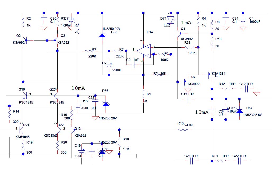

Hi Alan,
I've revisited the circuit of Figure 7.10, and I now do not believe that circuit is reliable with the values of 47k in the differential shunts across the current mirrors. I re-did sensitivity simulations by placing offset voltage sources in series with various bases. Although I do not believe that beta mis-match is the big problem, Vbe matching is a big enough problem to make that circuit, with 47k, not recommendable.
It looks like any one offset of 1mV in any of the differential or current mirror pairs can cause as much as 10% change in VAS standing current. And there are 4 transistor pairs where this can happen, resulting in a significant spread of VAS idle current, especially when the worst-case combination of offsets occurs. The problem simply is that the 47k load allows too much gain for the offsets to be amplified by.
Reducing the 47k resistors by a factor of about 10 to perhaps 4.7k should make the circuit adequately reliable with reasonably matched transistors, but with correspondingly much less DC open-loop gain for the amplifier. This will reduce the open-loop gain to the vicinity of that achieved with the ordinary resistive load instead of a current mirror. Although huge amounts of open loop gain at low frequencies is not the be-all and end-all of amplifier design, this does bring into question how much value this circuit brings to the table.
I have not looked into it, but the current mirror circuit with the smaller value of differential shunt resistance may still help keep the differential pairs in balance as compared to the simple resistive load approach.
It is notable that the simple resistor approach will also have tolerance problems in setting the VAS standing current for all of the same reasons. It is tempting to speculate that if the DC gain of the input stage to the VAS input node is the same, then the sensitivity to differential pair mismatch may be about the same for the simple resistor approach and the shunted current mirror approach.
All of this gives more pause in regard to using the full complementary input stage that has been used by so many in the past - without a more sophisticated approach like Edmond's.
Finally, with regard to IPS gain, which is at issue here, we do need to be mindful that too low an amount of IPS gain will invite increased input-referred noise from the VAS circuitry. Where possible, it is nice to have IPS gain of 10 or more to swamp out VAS noise.
Most of these issues go away when we use a unipolar input stage, foregoing the full complementary architecture. I have always been more comfortable with the unipolar IPS, but it is certainly not as pretty to look at.

Hi Mr. Cordell
Thanks for taking the time. I am disappointed, BUT I am not totally given up on this. I am actually looking into expensive matched transistor pairs like MAT01 and MAT02 and others for the input differential pairs. From my simulation, the current mirror is not nearly as sensitive to mismatch.
Also, one other thing that I looked into and was really surprising was how much the base current affect the bias current of the VAS. A slight difference in beta between the diferential pair can create a few mV of offset and cause the imbalance current to flow through R14. I simulated to verify the imbalance ended up going through the R14 to cause all the problems. I am actually consider using match JFET pairs to do away with all the input current.
Now, I am also looking into single differential pair IPS instead of complementary. Many of the designs do that. BUT there is a potential problem in using single ended LTP as IPS. There is a lot of ways to implement symmetrical VAS.........But I have question about implementing miller cap in symmetrical VAS.I am looking at Fig.7.15 of page 145. C1 is the miller cap. But notice this only on one side of the two output from the IPS. So it is not like you have symmetrical miller caps on both sides. Also the miller effect is on the top side of the bias spreader, so the other side(collector of Q14) really does not have the true pole splitting as there is a the bias spreader in between. Can I count on the impedance across the bias spreader is low enough that it's like an AC short circuit? If miller cap on only one side like this works, then there is hope!!!
I read your book on how miller cap lower the output impedance of the VAS as higher frequency, this will lessen the effect of the input impedance change of the OPS at large signal. Do you think 3EF can give high enough input impedance to avoid loading the VAS?
I am re-reading your book over and see what I missed the first time. Also I want to read the Spice simulation also.
Engineering is an art of compromising, so far, there is no perfect solution!!! Question is what to give up.

Hi Mr. Cordell
I really like the idea of complementary LTP with current mirror and symmetrical VAS. I am thinking along the line of DC servo that put a simple circuit that control the voltage at the emitter of Q10 in Fig.7.10. I should be able to do the same thing at the bottom also. It does not have to be accurate, all it matters is to keep the voltage so the current of the VAS is about 10mA. The GNFB should be able to come in and balance the rest. I am thinking in terms of floating a cheap opamp to the rail to do the job. Something like a TL081 jFET input. No need to get fancy ones.
Then we won't need R14 and truly make the current mirror load high impedance. Might have to eliminate Q13 and connect Q5 as diode. The DC servo feedback then connect to the base of Q5 and Q6. The idea is same as yours in Fig.7.16 where Q7 and Q8 set the voltage at the base of Q6 and Q7 to control the voltage.
Hi Mr. Cordell
It's too late to edit the last post, but this is kind of what I am thinking. I just throw in the opamp, have not really thought out the detail, but that the rough idea and see whether there is any hope.
Basically, I try to force the emitter of Q7 to about 1.9V to set the current of the VAS. Do the same think at the bottom half of the LTP and use GNFB to balance the whole amp.
