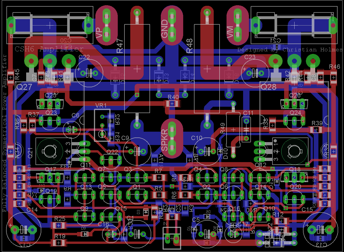

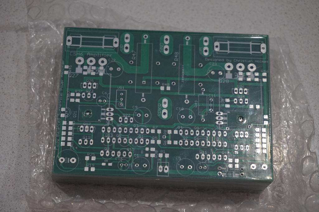

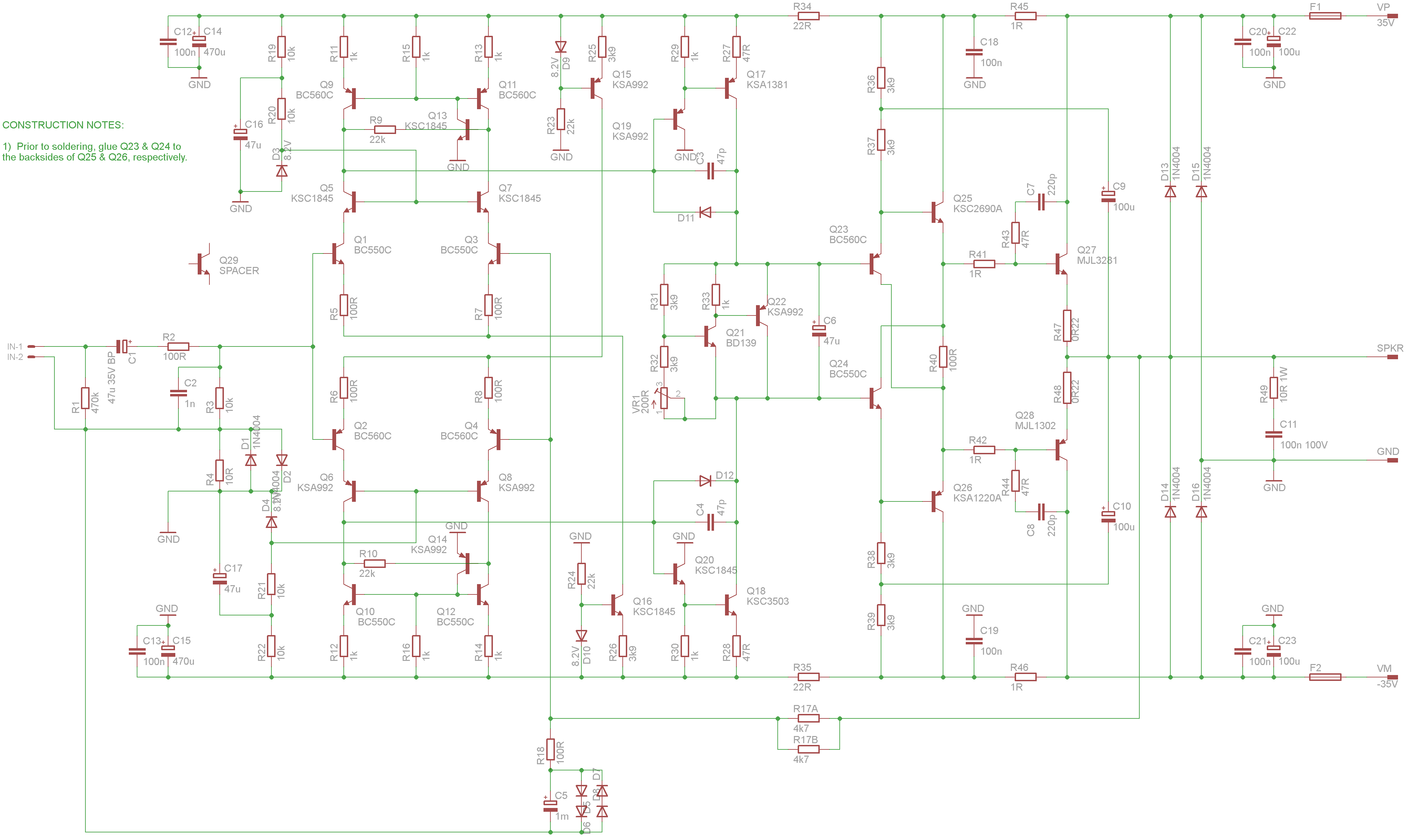

Hi guys
My boards arrived today however I'm not convinced that it is worth pursuing this project given the recent conversation re. Figure 7.10.
If the gain has to be reduced to the point where a simple LTP collector load is able to close in on its performance, I'd probably just build a Leach or jump into Edmond's Super TIS.
Any thoughts?
Cheers
Christian
Any thoughts?
Cheers
Christian
I still think you should at least hand pick transistors and build just the IPS and VAS like I suggested in post 5078. The only thing you need to look for is the max current from both the top and the bottom VAS when you ground the middle. They don't even need to be balance, just make sure they are within 7.5mA to 12.5mA. You are in the ball part. The GNFB will take care for the final balance.Hi guys

Are you trying to sell the amp? If not, there is nothing wrong with hand pick transistors. OR even adding a trim pot. It would be a waste to dump the stack of boards.
I am on my 4th designs, everyone has good and bad points, none is perfect. I would experiment with the pcb if I were you. What make you think you won't encounter problem with the other designs?

Hi guys
Any thoughts?
Cheers
Christian
Nice looking board! I'd build it with the 47k resistors reduced to perhaps 4.7k. With this circuit, you are still ahead of the game as compared to a simple resistive IPS load. In referring to the Leach, IIRC, he just uses the full-complementary input stage with simple resistor load.
If need be, verify that the Vbes of each relevent transistor pair are close. Devices that come out of the same tube are often remarkably well-matched.
Bob

OK, thanks guys.
I guess that I am philosophically against the idea of hand matching transistors; to my mind a circuit should yield small improvements from matching, but not require it.
If I reduce the shunt resistors to 4k7 as suggested then what of the current mirror degeneration and VAS emitter degeneration resistors? In my circuit I had already reduced the shunt resistors to 22k to reduce sensitivity and set the current mirror degeneration and VAS emitter degeneration resistors to 1k and 47R. If I reduce the shunt resistors even further then what of these other values? There is already quite a voltage drop across the CM resistors and unfortunately the front-end rails are fixed to the output rails, 35V, so there is not a huge amount of headroom.
EDIT: I have spec'd BC5x0 in the critical locations in this circuit, and the OnSemi parts I've bought in 1000 pcs cut tape and using in my Linn/Blameless/whateveryoucallit circuits resulted in 1.2mA offset in the last amp I built and 0.8mA in the one before that. So I think the same-sex parts are pretty well matched as they come off the tape.
Cheers
Cheers
