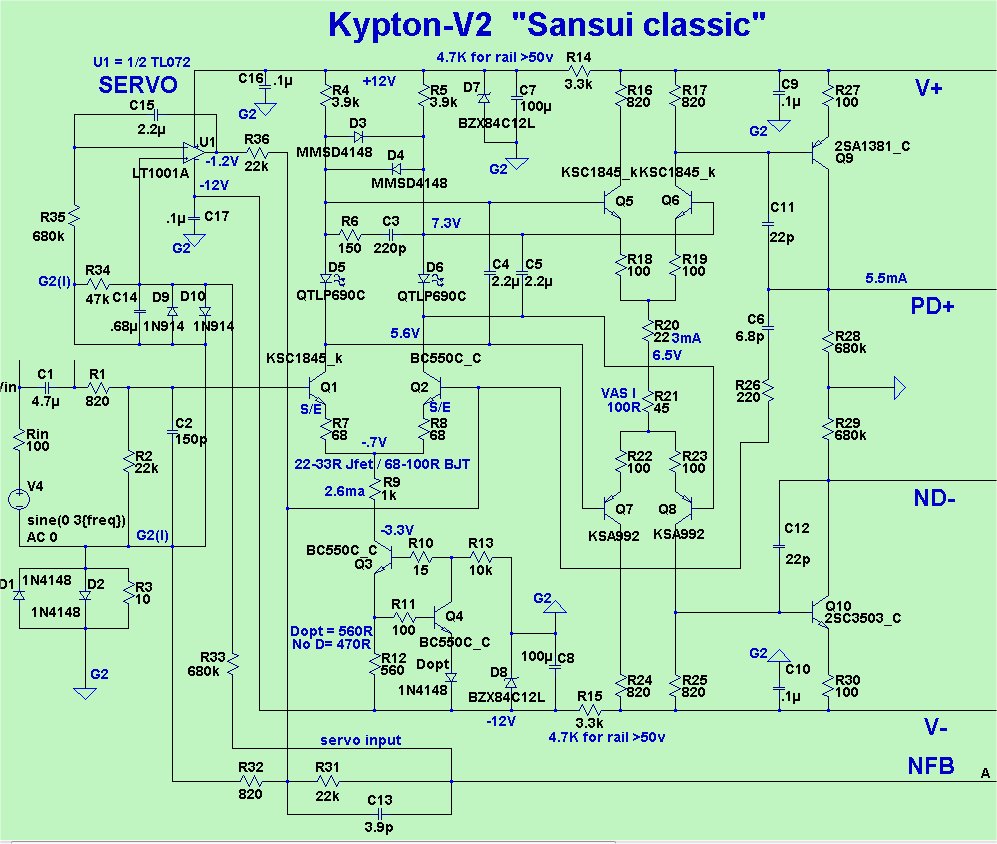

Neat circuit. Note that it is effectively a unipolar N-channel JFET input stage, what I like.
Also note it is really a four-stage amplifier; JFET LTP first stage, complementary "diamond" second stage, push-pull VAS third stage, Double EF output fourth stage.
Note also it is lag-lead compensated in 2 places.
Not truly symmetrical, but I like the cool look of that diamond 🙂.

Kypton V is this circuit (below attachment).
Another similar one by vzaichenko ....
http://www.diyaudio.com/forums/soli...erformance-yet-rather-simple-hybrid-more.html
Here , the first stage is actually a VALVE. One of the only IPS's that can do this !
My "kypton' is more typical - Jfet or bjt first stage.
Nice amp - wonderful sound was reported (after I worked a few bugs out -
I had a lot of trouble with this amp ... and learned a lot , as well !).
PS - VERY hard to properly compensate ...
Making for real low THD20K ....
OS

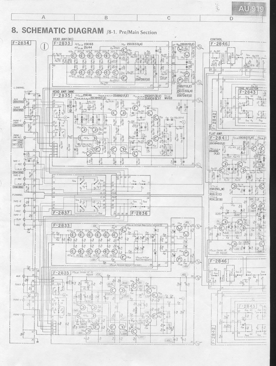

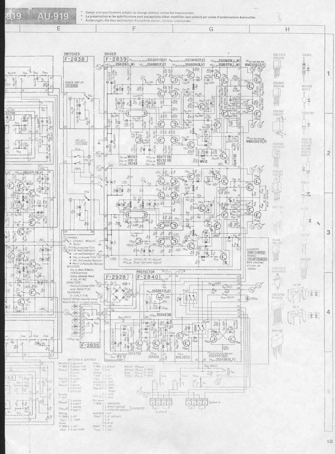

Hi Bob,
Thanks for your comments.
The Sansui diamond circuit is US patended by Takahashi-Chickashige,
patent # 4,229,705, October 21, 1980.
It was used in some of Sansui preamps and amps.
Attached are the schematics of the AU-919 model with the detailed values for the frequency compensation.
For a slightly better quality, ask me them through an MP precising your email address.
