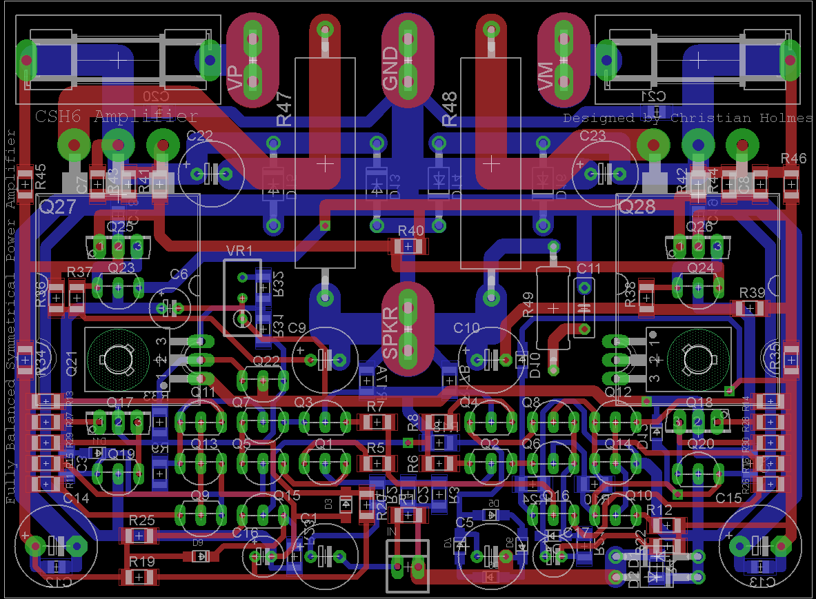

I attempted a similar topology design a while ago. The circuit certainly works in simulation. However in physical implementation you may have to pay special attention to the balance of the front end by selecting, screening, and matching the parts, as well as to the temperature balance and its compensation to the front end components that may have an impact to VAS operating current. As the standing current of the complementary VAS is sensitive to all those and a fluctuating VAS current is a bad news for OPS bias stability. Search the forum for meistersinger you may find that short thread. I was to give it up and has left the project alone for a good part of a year, then couldn't resist it and picked it up again, designed a layout using SMD dual transistors.
The amp is under construction, I hope with the matched components I will be able to have the VAS current fluctuation under control to a certain degree, then, if still not of satisfactory, I'll try the HK990 type of Vbe multiplier design that's immune to VAS current change.

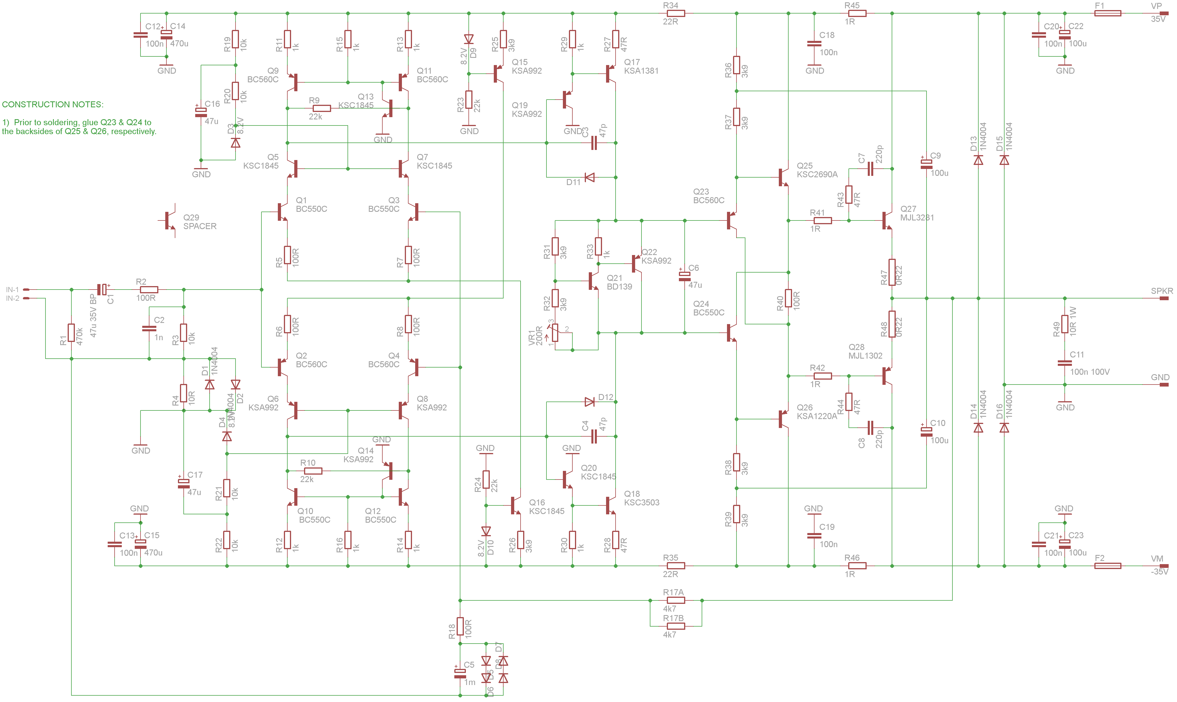

I have a question regarding to page 139 Fig.7.10. I designed the IPS/VAS just like Fig. 7.10 as shown in the attachment. I went through the theory and I am convinced this will work because like you said the 47K R14 stablized the voltage and set a stable current of the VAS.
BUT someone here claimed it does not work. He sited Sloan/Slone that it does not work!!! I don't see why. Can you confirm that Fig. 7.10 works? I am about to send out for pcb already, I have to put it on hold to confirm this.
Which circuit doesn't work? If you mean the original circuit of Sloan, it doesn't work, that common knowledge. Otherwise if you mean Bob's fig 7.10, it might work, though I consider R14/R16 a stopgap. See also nattawa's comments.

Hi Alan,
The key to this circuit working is the 47k resistors across the collectors of each current mirror. The analogous circuit topology in Slone does not work because the standing current of the VAS is undefined. The 47k resistors act to define it. However, there is a tradeoff. The 47k resistors reduce the low-frequency open loop gain somewhat, although there is still plenty. The smaller the value of these resistors, the better the VAS standing current is defined in the face of resistor tolerances and transistor mismatches. But the smaller the value of the resistors, the more open loop gain at low frequencies you give up.
I think I discussed this in the book. I did a crude sensitivity analysis using multiple SPICE simulations with various deliberate mismatches. We generally would like to keep the VAS standing current to within +/-10% of its designed value in the face of reasonable mismatches.

Well I hope it works; I'll find out soon enough, my boards will arrive any day now.
You should be fine. The Vbe multiplier transistor in your design works in a constant Ic of about 1 mA, a fraction of VAS standing current. Most part of the VAS current, including fluctuation, gets bled off by Q22. i'd say your bias control is largely immune to the unstable VAS current, as long as VAS current stays greater than, say 2 mA, under all circumstances.

Thank you very much Mr. Cordell. I designed for 10mA through the VAS, It does not matter whether it is 15mA or 5mA(+/-5mA). I think I have it covered. I used KSA1381 and KSC3503 with 50V max rail. I think I can take the variation.
Just for curiosity, I use 300ohm for emitter degeneration for all 4 of the transistors of both differential pair. Does that help a lot on the balance? I run 2mA tail current for each LTP.

It does work, but as I stated above, and in the book, the designer must make a tradeoff between very high open loop gain at low frequencies (fairly useless anyway) and the value of the resistor across the collectors of the current mirror. It is a compromise, like most of our engineering decisions. In engineering, one man's simple stop-gap can be another man's elegant simple solution.
We should also keep in mind that the reason for, and benefit of, the current mirror load is not just higher gain, but also its enforcement of balance in the differential pair. The addition of the current mirror shunt resistor allows a simple circuit to use the full complementary current mirror approach without seriously impeding the current mirror's balancing function. Those many designs out there that forego the current mirror load for a simple resistive load can be subject to significant LTP imbalance.
Your circuit solution to this problem is quite brilliant, and very effective, but a bit more complex than some would choose. We pick our poison 🙂.
