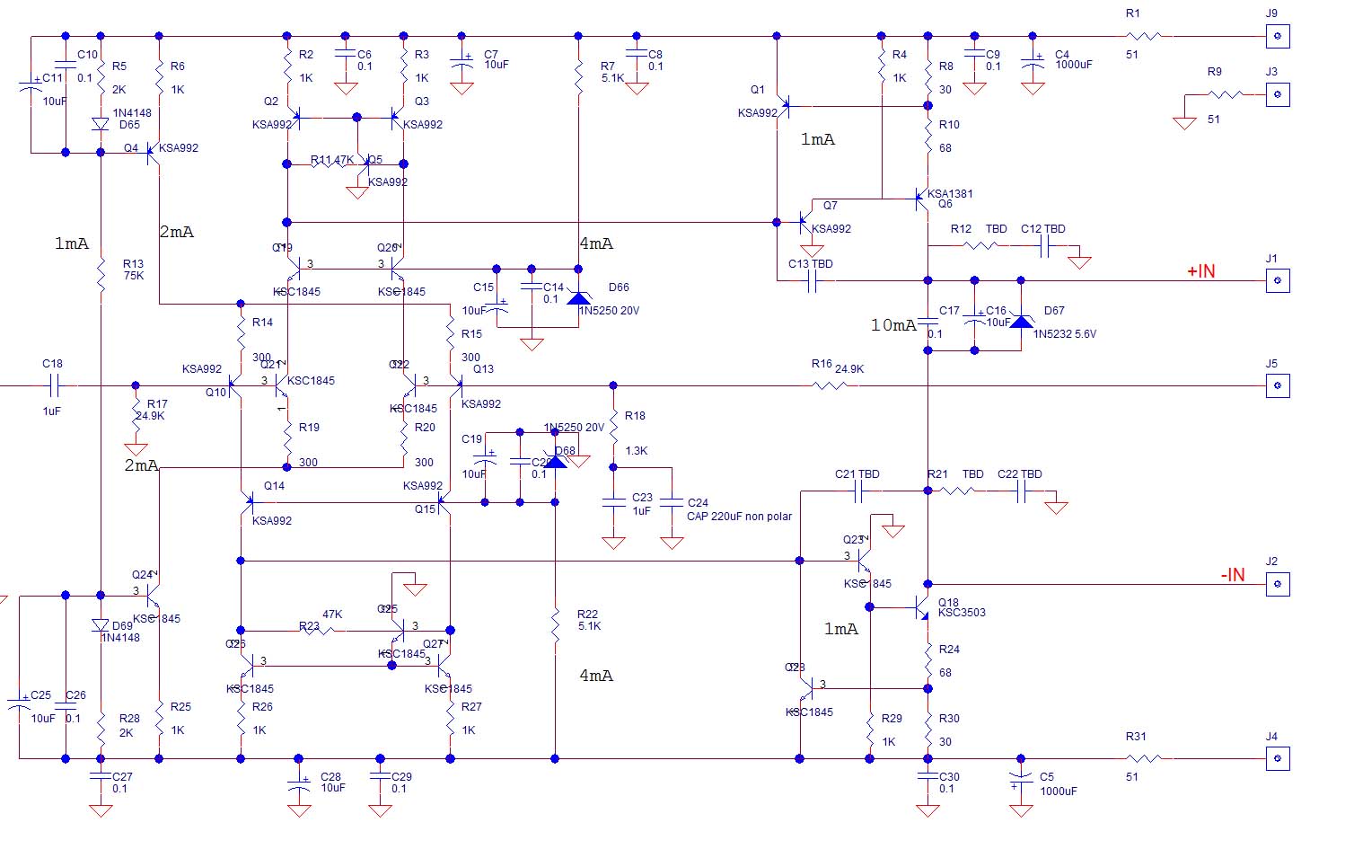

Hi Mr. Cordell
I have a question regarding to page 139 Fig.7.10. I designed the IPS/VAS just like Fig. 7.10 as shown in the attachment. I went through the theory and I am convinced this will work because like you said the 47K R14 stablized the voltage and set a stable current of the VAS.
BUT someone here claimed it does not work. He sited Sloan/Slone that it does not work!!! I don't see why. Can you confirm that Fig. 7.10 works? I am about to send out for pcb already, I have to put it on hold to confirm this.

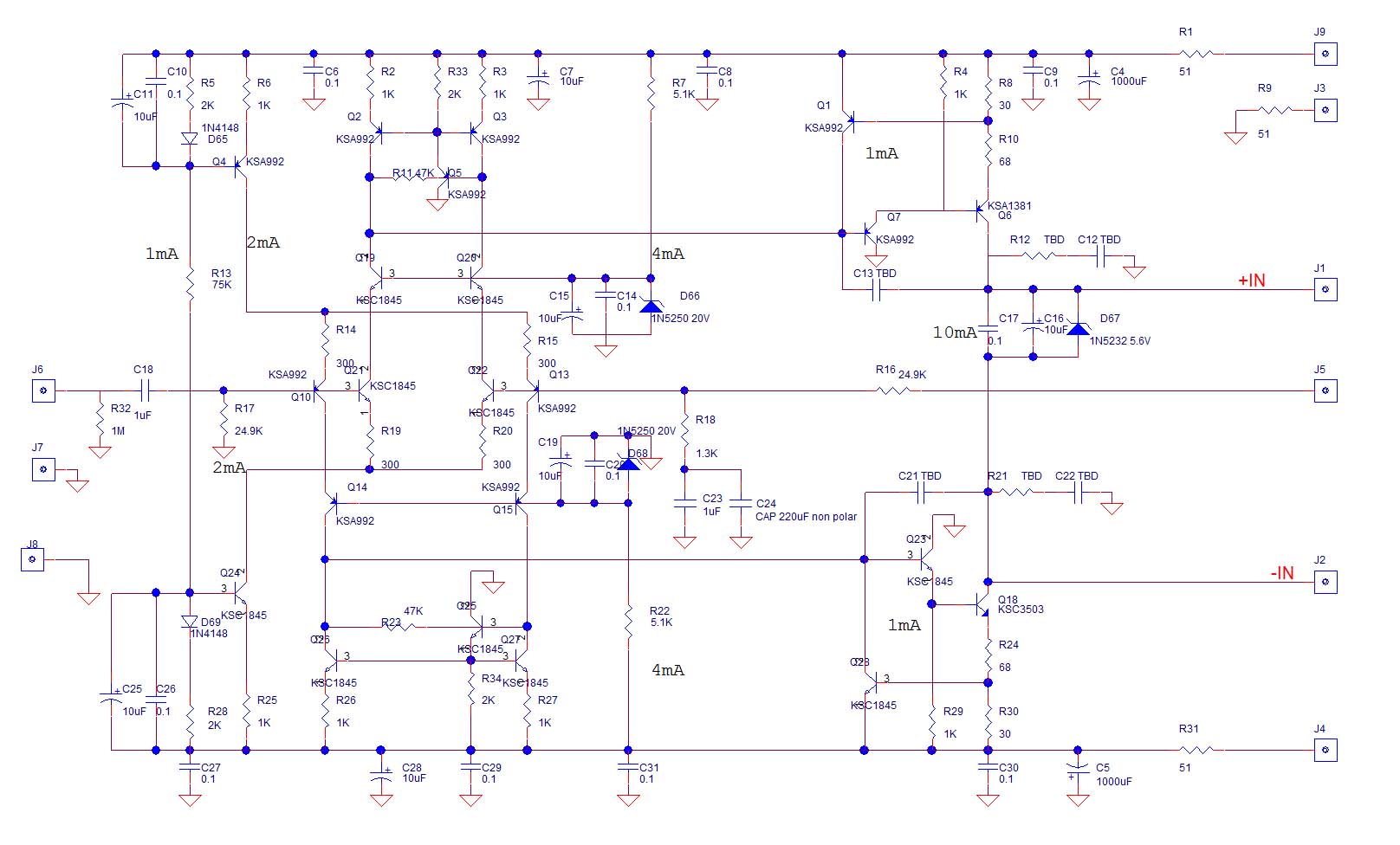

It's fairly well known on this forum that the Sloan CM'd complementary IPS doesn't work, which is why Bob Cordell added correcting devices, of which R13 and R15 are part. Shouldn't they be in yours?
Thanks, I overlooked that. I put it in and here is the updated schematic.
So it works? I think so. It's the R14 and R16 that set the current limit on the VAS. Then the GNFB that control the ultimate voltage of the VAS.
