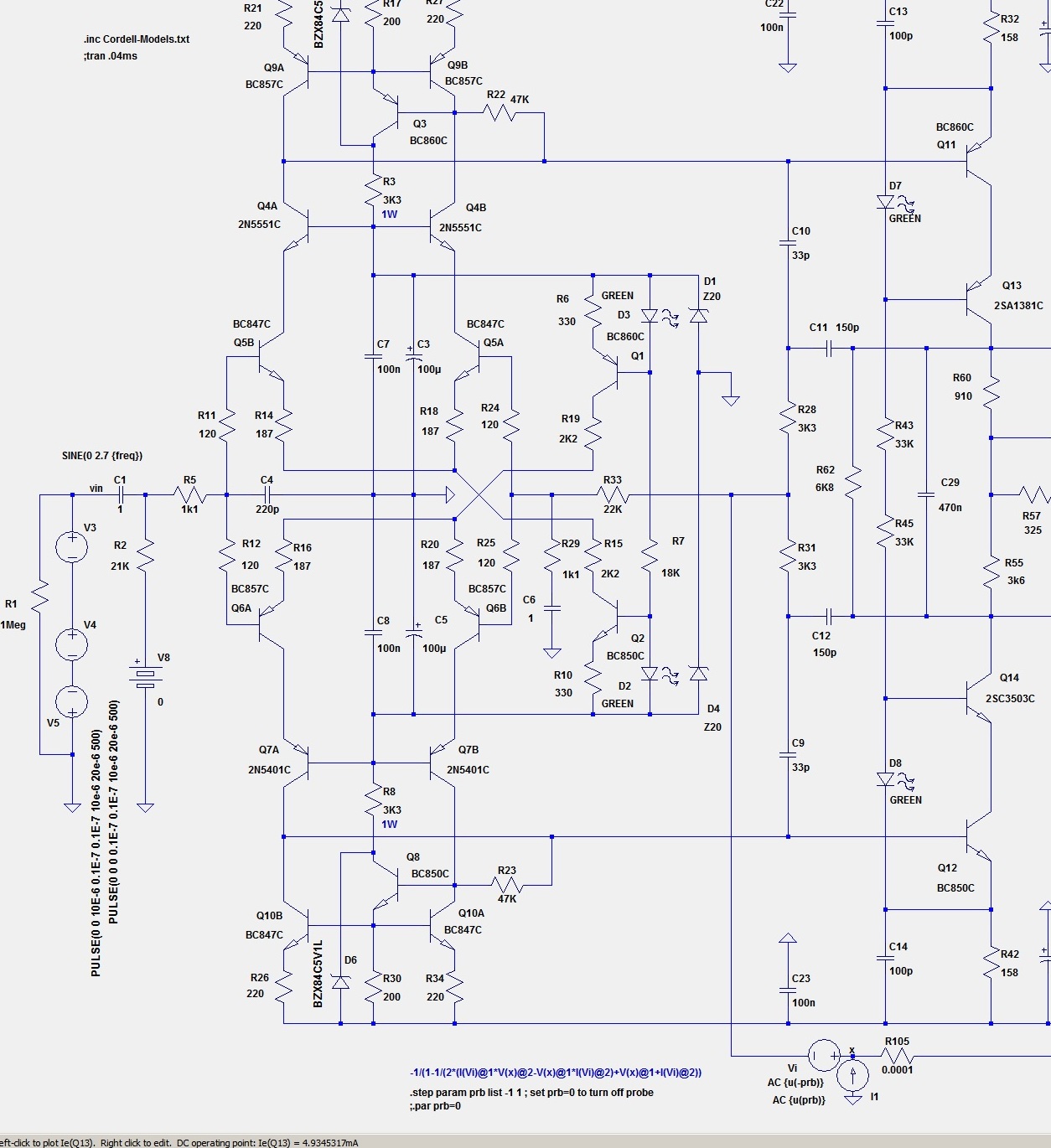

I did a quick-dirty simulation again just to show the VAS standing current responding the changes of a transistor in the IPS.

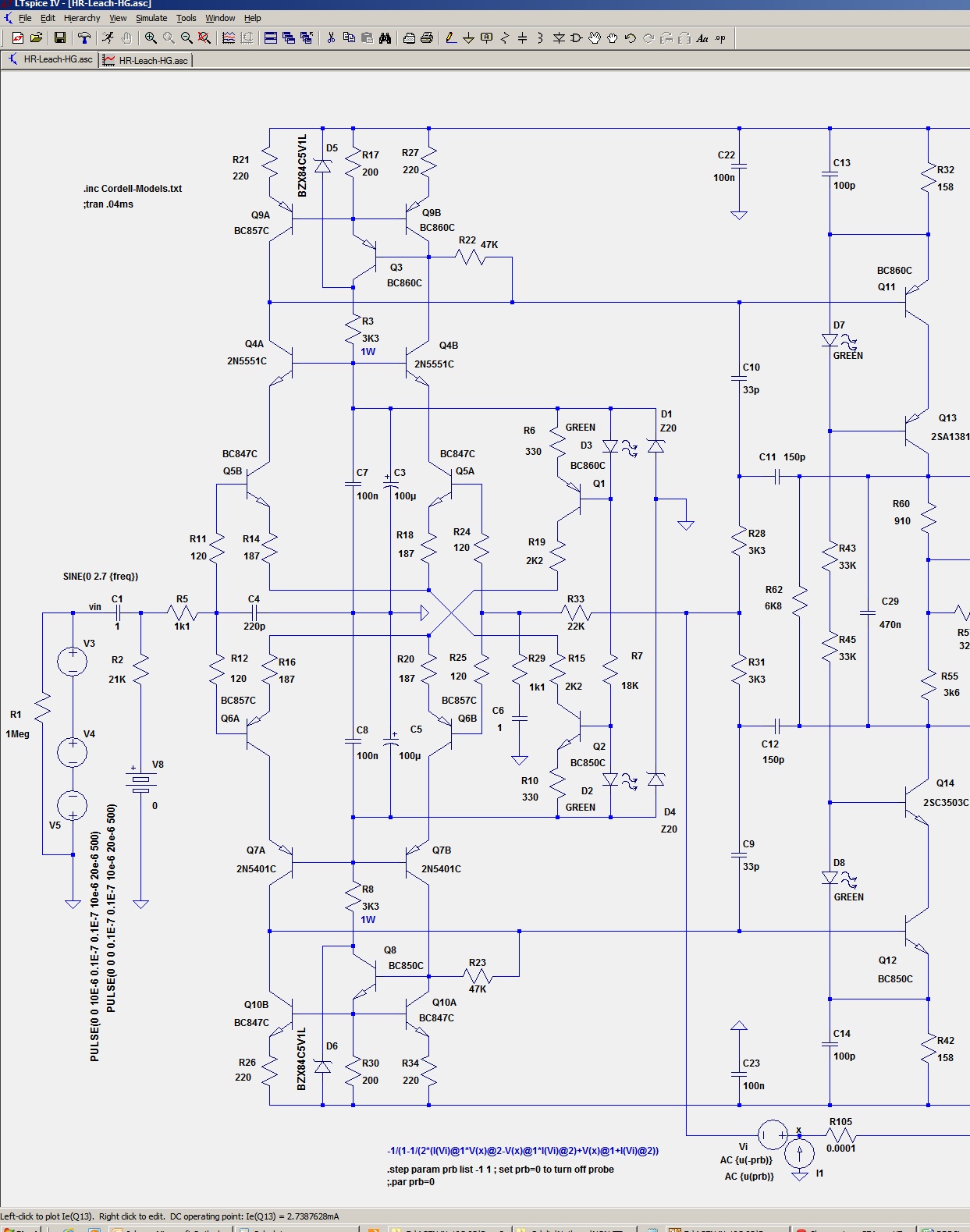

The first picture is before the changes, everything matches, the VAS Ie@Q13 is 4.9mA, the DC offset at output (not shown) is 0.23mV.
The 2nd picture shows one of the current mirror transistors, Q9B, was changed from BC857C (BF=515) to BC860C (BF=315), causing Ie@Q13 to become 2.7mA, and the DC offset at output (not shown) 6.5mV

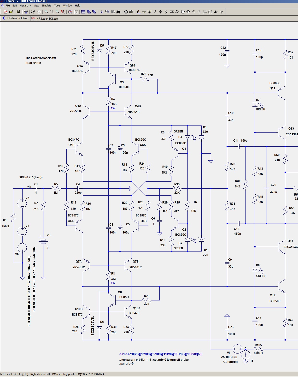

The 3rd picture shows the current mirror was changed back to where we started, but one of the input transistors, Q5A, was changed from BC847C (BF=524) to BC850C (BF=324), causing Ie@Q13 to become 7.3mA, and the DC offset at output (not shown) 52.3mV.

I am not familiar with the LED D4, how much voltage it drop to know the tail current. I assume it's 1V, so the tail current is about 1mA.I did a quick-dirty simulation again just to show the VAS standing current responding the changes of a transistor in the IPS.
Can you repeat the simulation with R14, R16, R18 and R20 = 300ohm. R21, R26, R27 and R34 =1K and see how the current change.
I don't think the offset voltage is that important as this is handle by the GNFB.
