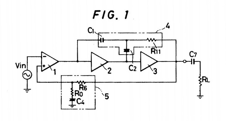

TMC patent
>Samuel Groner came up with an early reference for a TMC patent, from 1979 (Hitachi, Kunio Seki, US pat 4145666)
Unmistakably TMC !
Hi Arthur,
1Vpk. BTW, don't build this amp, as the OPS isn't really stable.
E.
Hello Edmond
I follow that the OPS is really not stable because it is missing base resistors and some collector resistors and some current sources are ideal types (I assume this is this what you mean).
But the point I am making is are you saying this arrangement has lower THD than a similar circuit that uses ETMC.
Regards
Arthur
Hi Arthur,
Hello Edmond
Yes. But maybe more is needed to make a triplet stable.
See for example: The YAP Output Stage
Regards
Arthur
The THD20 was simmed with only a relative light load and at 1/4 of full power. At 1dB below clipping THD20 rises to 6ppm. So it isn't better than ETMC, but rather worse.
E.

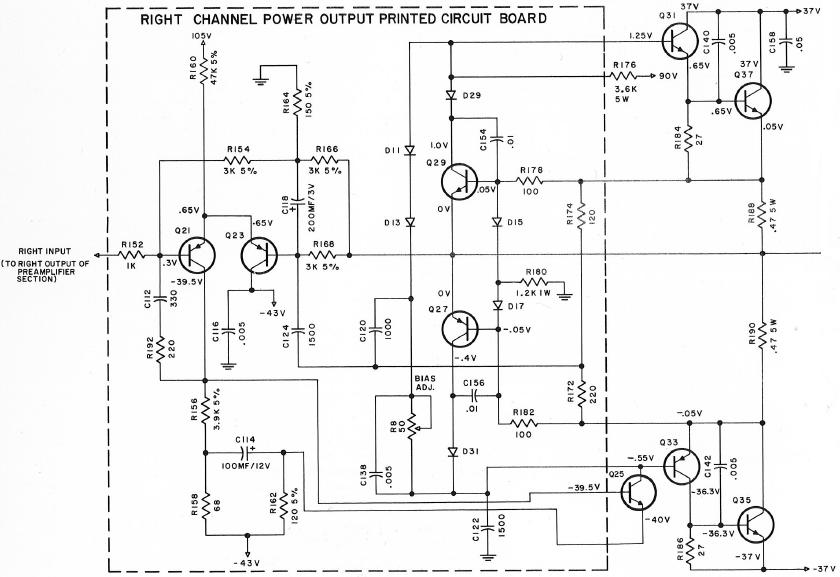

triplet
I assume the unlabled mustard-colored components pooged on the board in the bottom picture are the mentioned caps?
Hi Pooge,
I also don't see any caps across the driver BC junction in the schematic.
As for the "mustard-colored components" (the two through hole caps, right?), maybe these are the 470pF 'BC-caps'.
BTW, I wonder if this is the ultimate solution. Perhaps there are better ways to tame a triplet.
E.
