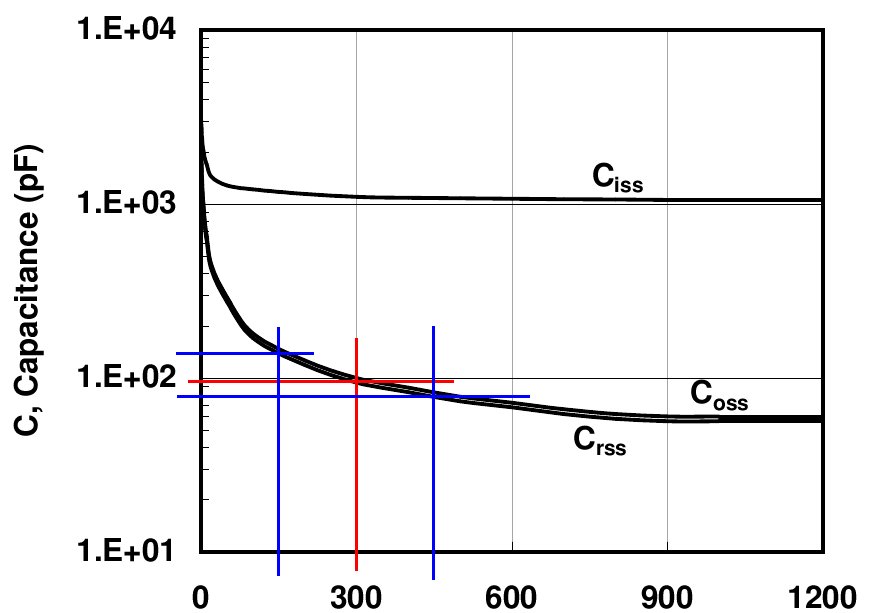

These SiC JFETs need to operate at some serious voltages in order to keep the internal device capacitances small and linear, and according to the spec sheet, 300Vdc looks good.
I like the isolation that an OPT provides between me and 300Vdc. You can also design with more conventional Si MOSFETs that use an OPT (Susan Parker's Zeus design) to avoid the necessity of "complimentary" N-Channel/P-Channel pairs that are a good deal less complimentary than NPN/PNP pairs, and the two floating supplies that the Circlotron topology requires.
