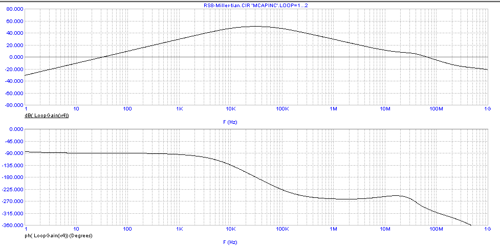

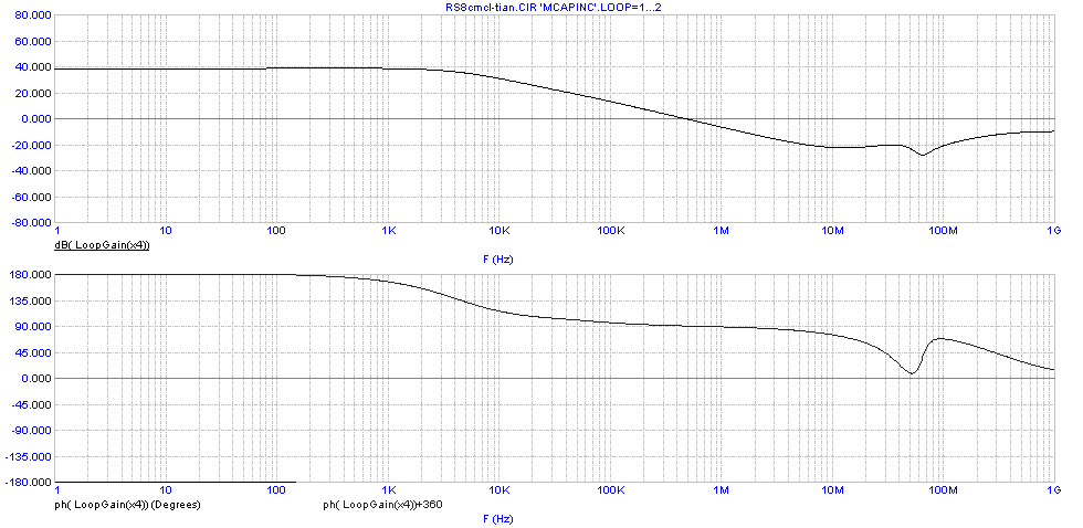

Hi Olivier,
You are driving me nuts. I just analyzed (simmed) the schematic in post 2258, and in the meantime you pop up with another one in post 2264. Shooting at moving targets makes things not easier.
Regarding the first schematic, I have plotted the gain/phase response of the CMCL (which looks okay) respectively the Miller loop (with disabled global NFB loop).
It's the latter that predicts trouble, as the ULGF is way too high: 65MHz.
Notice that this is a rough estimation, as parasitics were ignored. A real amp might give quite different results and/or might even oscillate.
If you don't mind, I'm not gonna investigate this any further, because you changed the circuit every time and it deviates too much from the starting point as depicted in this post: http://www.diyaudio.com/forums/soli...ogy-construction-troubles-17.html#post2268194
E.
PS1: The plots show the loop gain, thus not the return value, which is - (minus) loop gain.
PS2: @Walter cs. "simulation [...] used to AC analyze the loop gain - that's the type of analysis where simulators are shining." Clearly NOT !

I understand the trouble of me changing the circuit, but the one you analysed (2258) is the one on the test bench. So that's perfect. This PCB is foreseen for additional components. So in fact the PCB corresponds to the schematic in 2264 but is only equiped with the components of 2258.
The TMC part is just replaced with one 1 cap on each side 33pF for a simple dom. pole compensation (for now).
Some other part may differ like C12/C13 and C15/C16 but the real ones plugged in are according to 2258 (and not 2264).
About the deviation from the starting point, indeed it looks more to the circuit you posted just before the version you linked to.
Thanks for the info, I know now I should rather look into the Miller loop instead of the CMCL loop even if the affected nodes are around the CMCL and ML... But I guess this is normal...

Edmond, could you explain how to measure the millerloop AC analyses (& cmcl loop - will be the same logic i assume)
Cheers
Yes I can, but first I need to know what version of MC do you have?
E.

Hi Olivier,
Okay. That means we can't use the more sophisticated Tian gain probe (for the first time possible in MC10). So I will revert to a simpler (and slightly less accurate) method to assess to loop gain and phase.
Not sure if capacitive load on the output will bring trouble. I will test that too very soon.
At the moment, I wouldn't do that. There are better ways to tame the VAS.
Together with the schematics for assessing the loop properties, I will show you (soon) how to reduce the ULGF of the Miller to an acceptable value.
