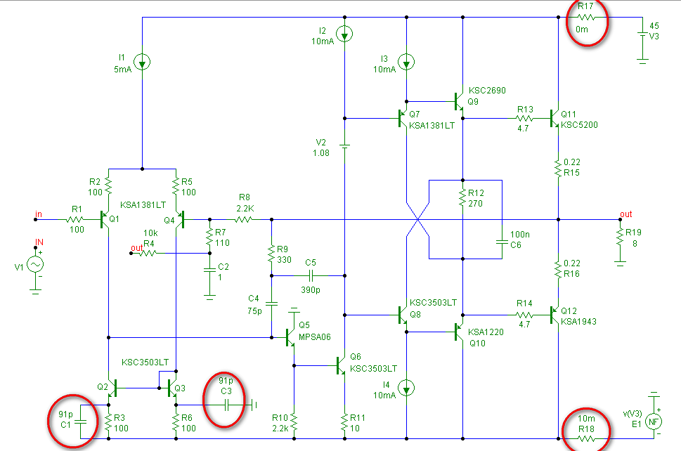

While fiddling with compensation caps in order to further improve the PSRR, I found another source of distortion. We know already that magnetic fields radiated by the power supply rails can have a serious impact on the distortion (see Bob's post). However, if the PSRR is inadequate, voltage fluctuation on the supply lines (as a result of half wave rectified currents in the OPS) may also degrade the performance. This is the electrical counterpart of magnetically induced distortion.
Please have a look at the example below and ignore C1 and C3 for the moment The PSRR of the negative supply rail is rather poor (38dB @ 10kHz). This is because the frequency compensation (TMC) is referenced to this rail (instead of gnd). With a perfect power supply (Ri=0) THD20=1.29ppm
If we increase Ri of the PSU by inserting a small 10mOhm resistor (see R17) in series with the positive supply rail, distortion is still 1.3ppm. Doing the same thing with the negative supply rail (see R18), distortion rises to 14ppm. More than ten times as much!
Clearly, this is a result of a poor PSRR. Of course we can filter the supply line. But strictly speaking, this doesn't improve the PSRR of the amp itself, rather the quality of the power supply. A more elegant (and cheaper) solution is the addition of two tiny caps: C1 and C3. Now the PSRR improves from 38 to 84dB. And the THD20? Well, it's back to 1.25ppm. Not that bad I would say.
Notice that, opposed to a previous version, I have added a second cap: C1. This one preserves the symmetry of the current mirror by equalizing the impedances in the emitter leads. Also notice that these caps have no effects on the (open loop) gain.

Cdom PSRR compensation is shown by Self, "Negative Supply-Rail Rejection" p290+ in the 5th ed of his amplifier book (and he's up to 11 in his numberd distortions)

compensating for 2-pole TMC network can be done by connecting to cascode or duplicating the network and connecting to gnd and mirror or cascode

Hi jcx,
I know this (of course), but I wouldn't call his methods 'compensation'.
The 1st method is simply a brute force RC filter in the power supply line. Thus improving the power supply, not the PSRR.
The 2nd method, tying Cdom to the cascode, isn't a compensation either, rather moving the reference to a quieter point.
Furthermore, as far as I know, Self didn't describe the effect on distortion figures as shown by me (correct me if I'm wrong).
So why quoting him anyhow?

Indeed, this document shows also this type of compensation, though in it's most simple form (fig. 6).
compensating for 2-pole TMC network can be done by just duplicating the network and properly connecting to gnd or rail and mirror or cascode
Sure, that was my very first idea as well. But in case of TMC (or TPC) you don't need an exact duplicate. One simple cap (between the current mirror input and ground) will do as well. Besides, because of several side effects, you will need a slight higher cap anyhow. So an exact copy makes no sense.
As Samuel Groner pointed out, this method affects the bandwidth (a little bit). It also disturbs the balance of the current mirror (a little bit). The compensation as shown in post 2162 doesn't suffer from these (not so gross) side effects.
BUT... I don't care which method is best and who invented it. As a matter of fact, all known methods are rather obvious, not worth a patent.
My point is that I was rather surprised by the relative large impact on the distortion of a non zero (10mOhms) source impedance of the PSU.

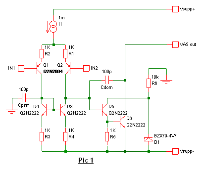

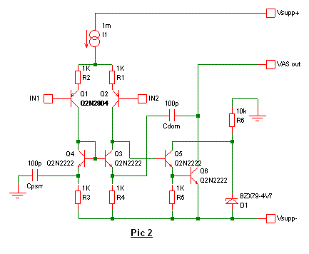

Hi all
The first pic below shows a simple front-end with Cdom compensation and an added capacitor (Cpsrr) to fix the PSRR.
Now, IIRC, Edmond showed a while ago that moving Cpsrr from the collector to the emitter of Q4, as shown in the second pic, improves performance.
I'm wondering if moving Cdom from the collector to the emitter of Q3 would also result in an improvement since this avoids adding the small but very non-linear signal voltage at the base of Q3 to the VAS output.
Since the local feedback current through Cdom is now being applied to a low impedance node, stability may be improved as well because the VAS output impedance will be lower at high frequencies.
Connecting Cdom this way should also do away with the need for the 3'rd capacitor that Edmond recently added, I think...:scratch1:...
As an aside, I think stabilizing Q5's collector voltage as shown is a good idea. It provides overcurrent protection for Q5 and also prevents Q5's Ccb adding to the PSRR problem.
Any thoughts on this?

Compensation
Hi Godfrey,
Tying Cdom to the emitter of the CM is a very interesting idea. So I immediately simmed it. Regrettable, the distortion increases.
In order to exclude other distortions, which could easily mask the improvement, I've used ideal components for the IPS and OPS, and a Hawksford cascode for the VAS, but to no avail.
Next, I've replaced the simple CM by a Improved Wilson Fudh current mirror. Again, to no avail. Tying Cdom directly to the VAS input still gives better results.
Clearly, I'm overlooking something. If time permits, I will try to figure out what's exactly going on.
