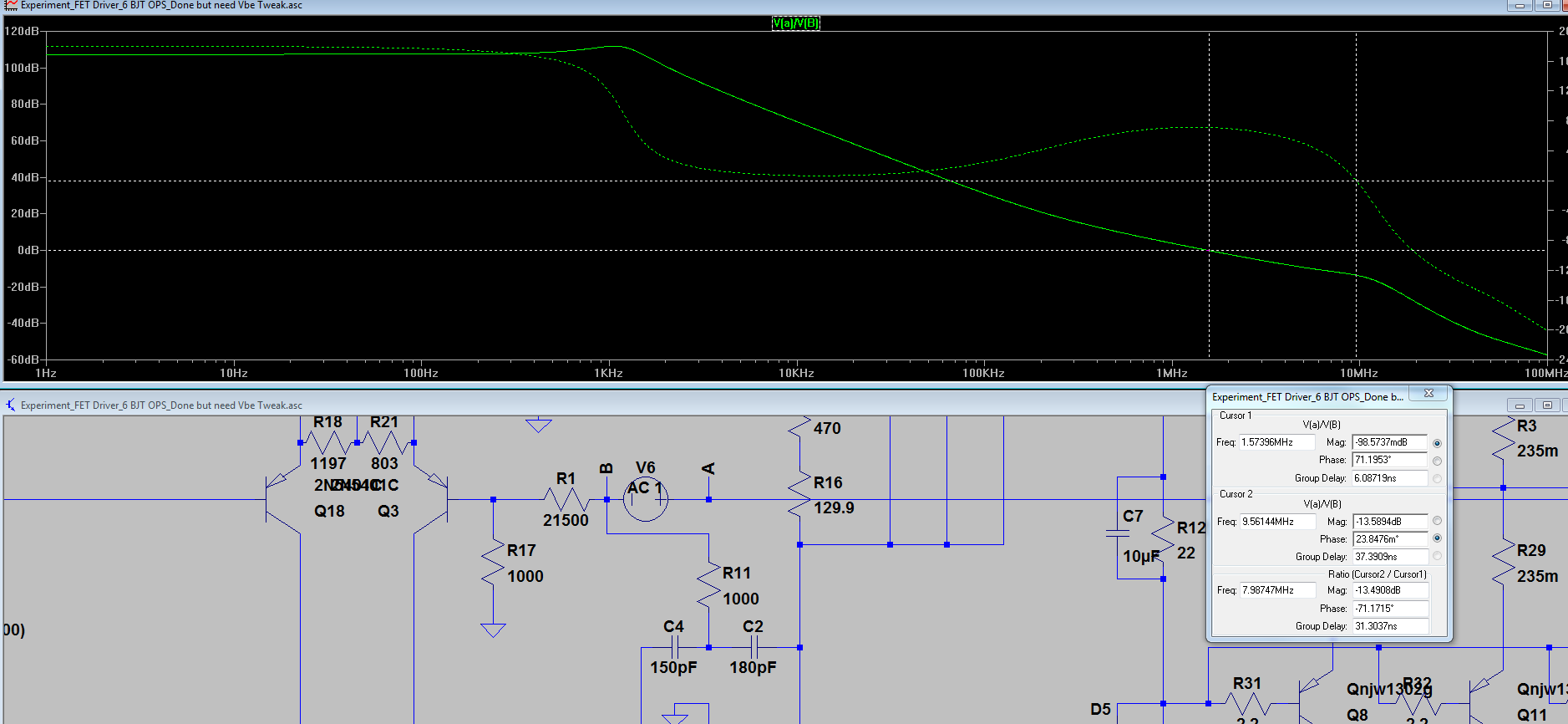

So you basically just have to use standard middlebrook probe but with the TMC resistor connected inside the loop? What about the weird phase dip you get with the TMC resistor connected inside the loop, should it really look like that?
What is the circuit between out_tmc and d_tmc for? Is that needed as well?
EDIT : The circuit is just the delay you added, it should be ignored, right?
EDIT#2 : Another thing, how would you then simulate OLG with the TMC resistor inside the loop?
EDIT#3 : Looks like the 0 degrees point on your plots is the point where you get positive gain, how did you set the plots up for that? It is usually the -180 degrees point that shows when you get positive gain. Do you have to look at it differently due to the phase swings the simulation shows with the TMC resistor inside the loop?
EDIT# : Phase starts out at around +180 degrees, is that why the 0 degrees point is now considered the point where you get positive gain? Secondly, can we count on the phase it shows using this method?
the delay can be deleted, tmc_d is just the delyed output, need to settle on just one of _c, _d when you remove the delay
the phase dip is unavoidable with the higher order loop gain - you will see it with 2-pole global loop gain as well as TMC measured "inside" both loops
once you have the simple Middlebrook or Tain LoopGain probes the open loop gain is less interesting - the huge inductor feedback isolation can give incorrect results where AC loading is important - the Tain probe is better
either Middelbrook or Tain probes in just the outer loop still measure the "global" feedback in that loop - just don't give a good indication of stability for TMC with its extra loop around the output stage
in spice is is also possible to just divide the amp output by the diff input V when the amp has a AC Vsource on the input if you want one type of gain

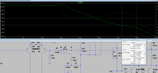

If I understand it correctly, the attached sim is done the correct way.
Shows 71.5 degree phase margin and 13.5 dB gain margin.
Ok, then the fact that the phase on the plots start at around +180 degrees instead of the ususal 0 degrees point, is due to having the TMC resistor inside the loop and it also means that you get positive gain at the 0 degrees phase point, instead of the usual -180 degrees point when you simulate CMC. Or rather, the plot shows it as +180 degrees, but in real life it is still 0 degrees?
Makes it easier and faster to get the phase margin.
Those delays you used, are they something you need to be careful of in real world applications?
Lots of questions so thanks for having the patience to answer them.
the delays are just one way to get an idea of what would happen if the Q you were using were slower (maybe close to saturation, under biased, worse than "typ" spec), or larger Cload (usually louspeaker cable caused) increased phase shift by reacting with output stage impedance
phase can be plotted with 360 degree ambiguity due to the software having to decide where to start "phase unwrapping" - I know people like to follow the formalism but I find a .tran will show if the loop phase is really "the wrong sign" and don't worry too much about which method uses what sign convention for AC loop gain plots
which reminds me - always start spice sim with extensive testing with .TRAN - a sim has to work in .TRAN before it is worth looking at .AC -.AC doesn't "sim" anything - no saturation, breakdown, clipping, reverse bias - it only finds the "linear" response at the operating point the DC solver finds for the circuit
So basically, if the phase starts at 0 degrees, the -180 degrees point is the positive gain point and if it starts at +180 degrees then the 0 degrees point is the positive gain point. Makes sense that the software decides where to start.

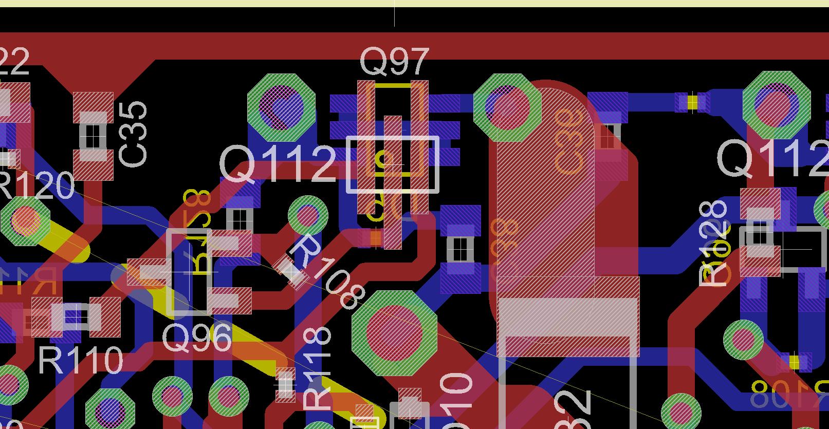

or glue a sot23 onto the wide part of the collector/drain output pin right next to the plastic package. This point is likely to be hotter than the sink and also to respond more quickly than the sink to changes in dissipation/temperature.
Short C to B if you want to convert that monitoring sot23 to a diode.

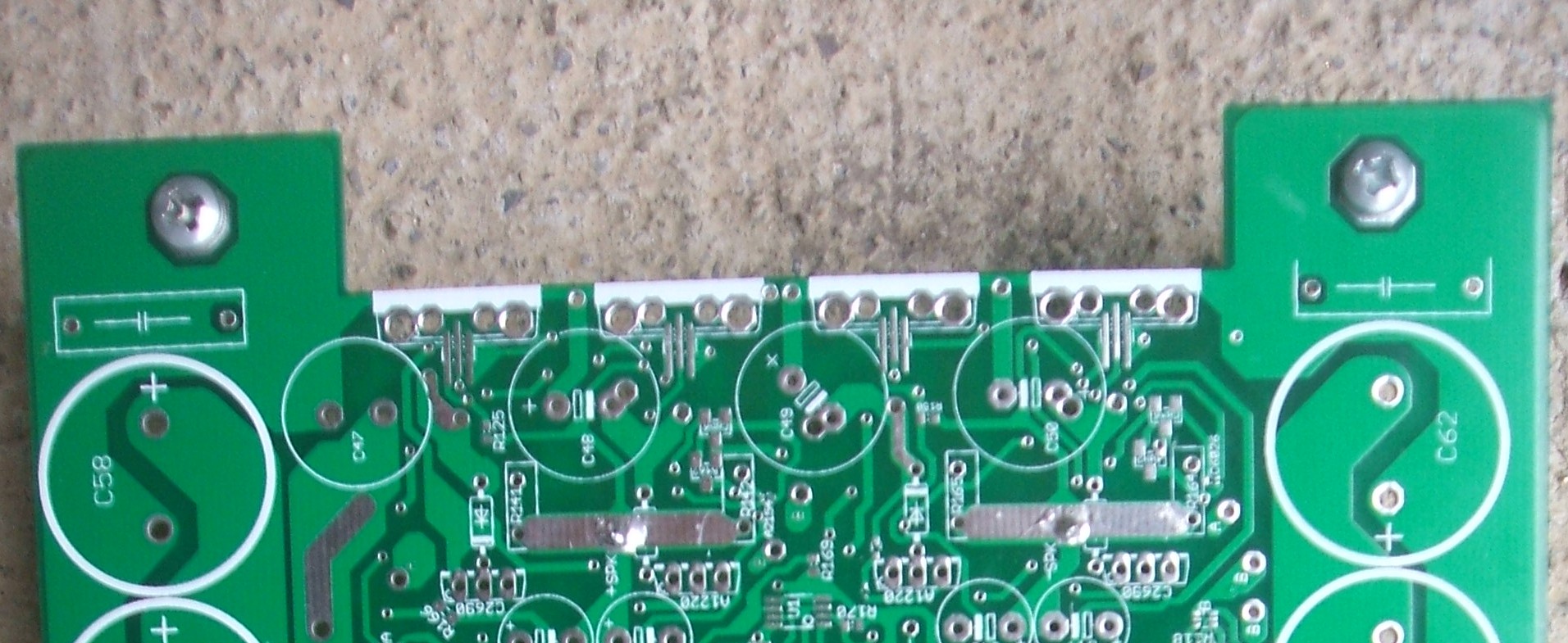

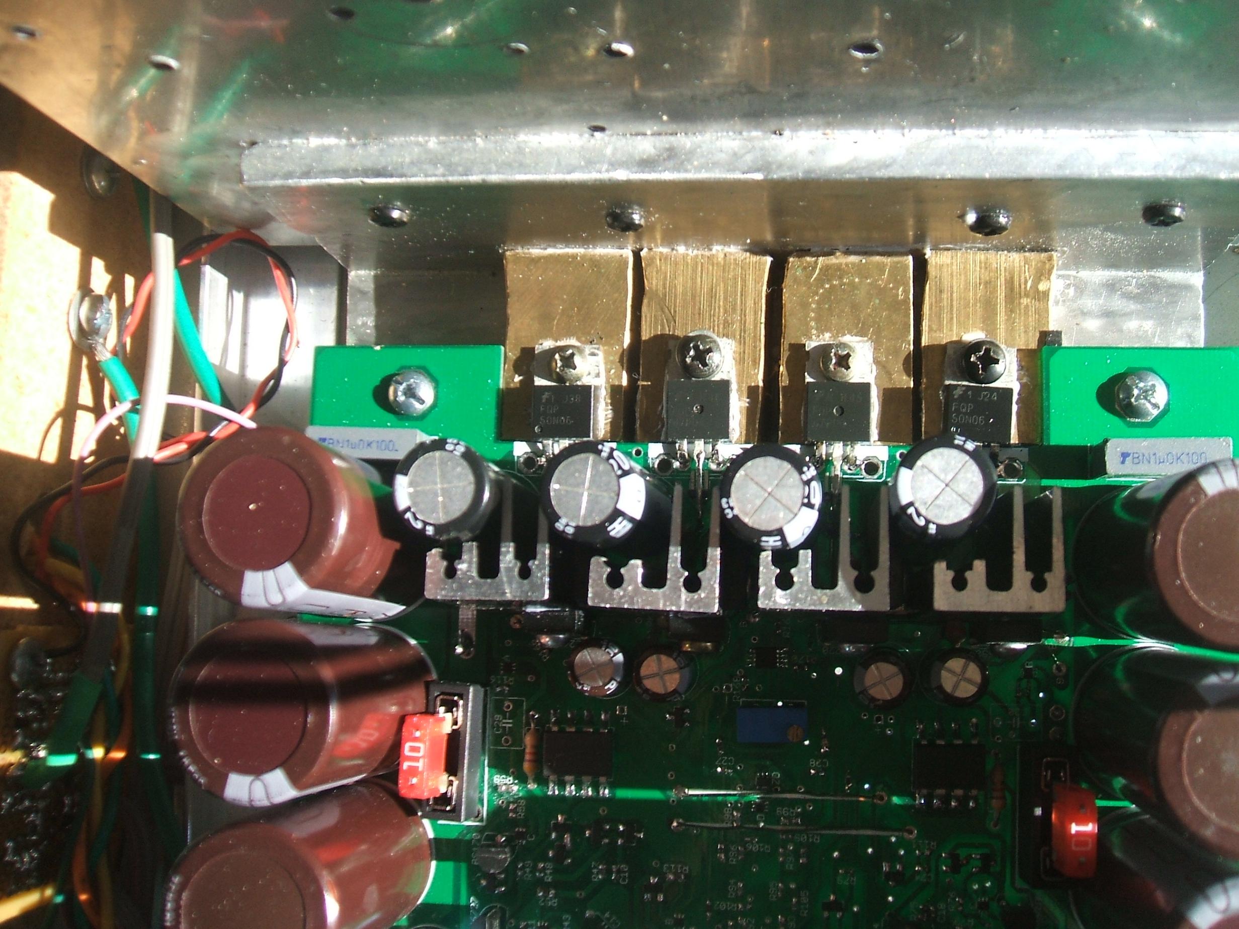

That's exactly the way I did the thermal comp in this amp proto-type. In this case the outputs are mosfets, the SOT-23 transistors are PCB mounted under the drain pins on a pad that allows me to move it about 5mm closer or further from the plastic case to adjust for best tracking. Oh yeah, and it works nicely.🙂
The Eagle drawing example below is from my next amp, here they are SOT-323, or SOT-23 mini, 2mm X 1.2mm. The TO-220 output device mounts horizontal to the PCB, the gate and source pins are shorter, the drain pin extends over top and contacts the SOT-323.
