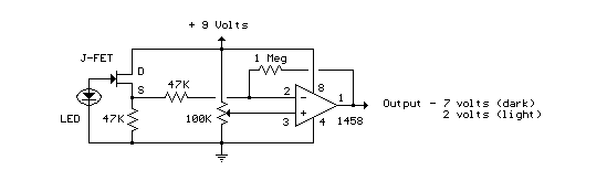

I've seen (and built- below) a light detector with forward biased LED. It's photo-sensitivity has to be amplified 1000 X for any useful purpose. A pair of glass 1n4148's would work as well. 🙂

Try running a milliamp through the diiode, then hit it with a high intensity modulated source. Set the opamp gain high. What you'll see is... nothing. My measurements confirmed the obvious physics.
The circuit as it sits is still looking at leakage currents, not a forward biased diode such as is used for voltage references.
I'd expect the photo current is still there - but 1 uA photocurrent on top of 1 mA would give only 26 uV delta in a Si diode, ~ 87 dB down re 650 mV forward drop
(1 uA is a really large photo current for "accidental" coupling to a packaged signal diode I got about that by sticking 2 smt leds together face to face and driving one with 10 mA)
