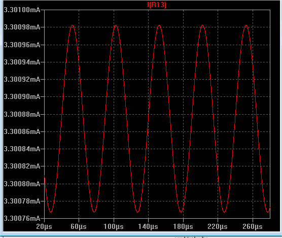

I'm not criticizing your design, on the contrary. For driving a subwoofer, the amplifier`s ability to deliver current and provide electrical damping are of primary importance. This leads us to a design like yours, a dedicated constant voltage amp with bipolar Darlington output in class AB. I just don`t see the need for the triple.
I'm jumping into this conversation late, but the major point of a triple (EF or otherwise) is to lessen the load on the VAS, lowering distortion. Bob Cordell's book goes into this in very high detail.
Cascoded VAS is high impedance - EF2 loads it down , even with normal loads. SO , either EF lateral or triple. In simulation , that luxman voltage stage does .01-.02% with an EF2 ,but does < .0001 to .0006% on any flavor of triple.
Hi WuYit,
Amplifiers with high current capability are not just needed for subwoofers. The Triple is important in delivering high current effortlessly, and greatly improves performance across the band. If you do some simulations, you'll see the difference immediately. If you build and measure an amplifier, you'll readily see the difference. One of the biggest mistakes designers make is in too heavily loading the VAS. In MOSFET amplifiers, for example, some designers see the supposedly infinite current gain of the MOSFET and think it is OK to directly drive them from the VAS, with no driver buffering the signal. Big mistake.
In most cases, the difference between a double and a triple is one pair of TO92 transistors, or maybe one pair of TO 126 transistors. One of the most cost-effective improvements one can make to a power amplifier.
Bart Locanthi popularized the Locanthi T circuit triple more than 40 years ago, and many great amplifiers have followed suit since then.
Bob
I can't imagine perceiving Cdg and it's effect on the voltage stage any different than with a overloaded "droopy" EF2. 😱 Instinctually , I at least used a MJE345/350 EF pair to drive my 2 pairs of original Hitachi laterals. The end result was similar to a Locanthi T circuit's effective load.
Either output stage solution accomplishes high current , no- loading design goals. The trade-off is in the V MOSFET's simplicity but higher cost vs. the BJT's lower cost. I have built both and they are audibly very similar. In either case , we just want to "hear" the unloaded voltage stage through as transparent a current stage as possible.(an "ideal" current amp)
As I said (last post) , any decent sounding IPS/voltage stage will both simulate and sound better , especially at LF ... on either of the above output stage solutions. You can also run your voltage stage @ 3-5ma , eliminating thermal considerations plus greatly increasing MTBF - a "free" side benefit. 🙂
