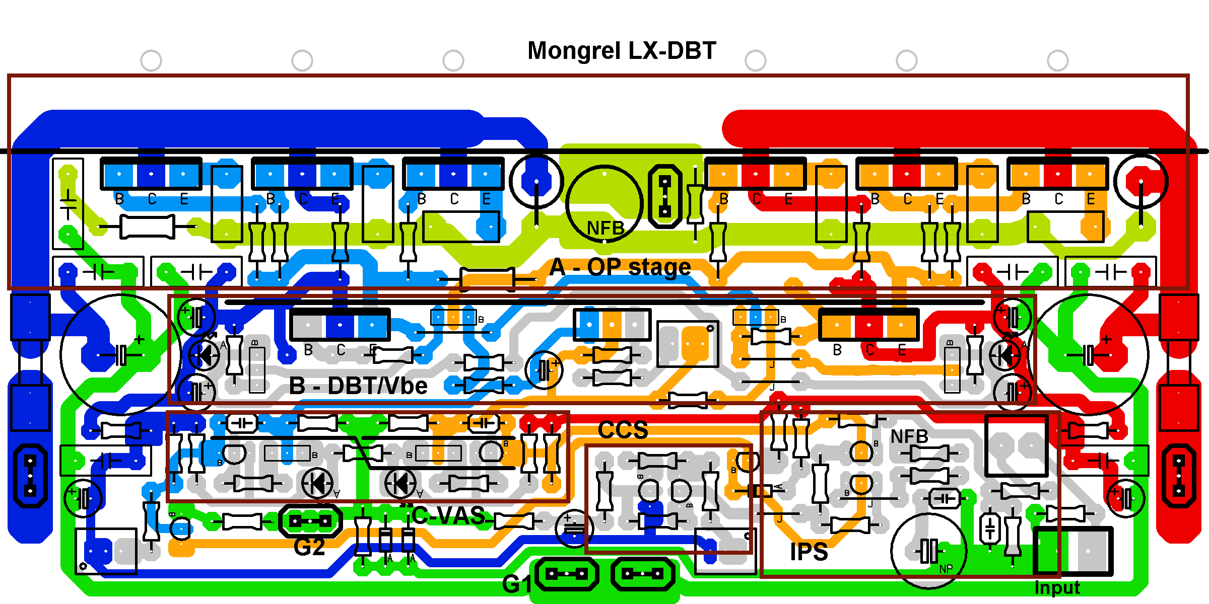

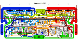

If you look at the PCB , P192 is as "real world" as it gets - just curious , did you build one ? It works EXACTLY as advertised !

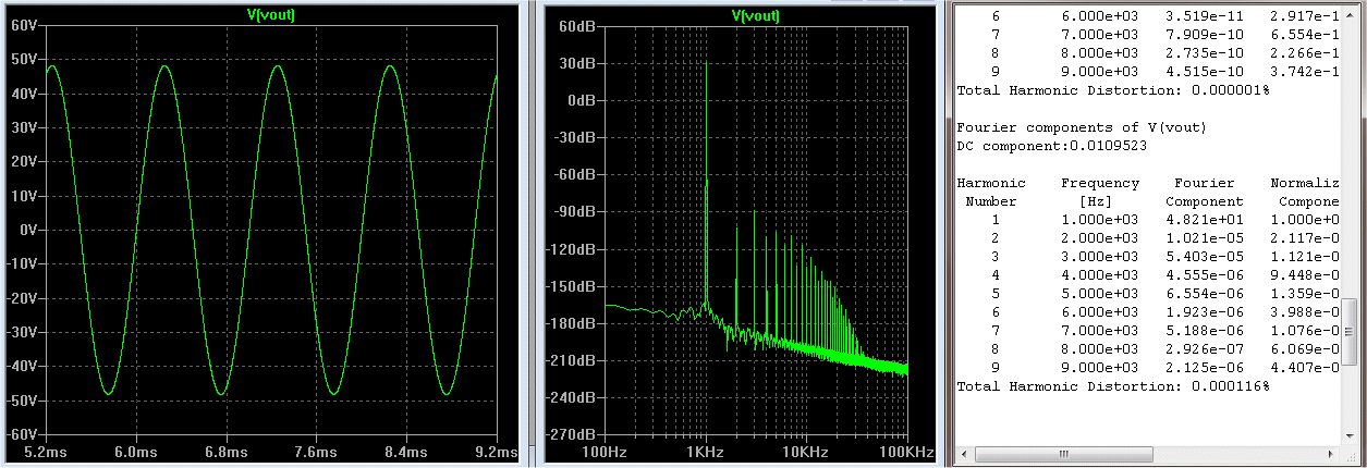

Certain high impedance voltage stages are best "serviced" by a triple. The standard "LIN" (ccs) stage is very comfortable running hot at 12-15ma , as is a leach type push pull. Both work well with an EF2. My LED biased hawksford cascode VAS runs best at 5-6ma. I ran it for 8 months on a EF2 , sounded good at low-mid levels , but lost it's goodness when ran hard. Not so on a triple.
So what if I lose 5V on my rails , I have 68-0-68vdc .... Also , my board can take boosted rails if I want that 5v back. I feel a 120v p-p capability will satisfy most demands - even a high crest factor source. BTW , the DBT only loses 2.1V off the rails and the hawksford w/ green led's another 2.4 = 4.5V. nothing to cry over. 😀

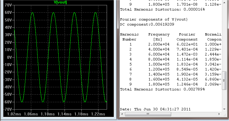

Well inadequate ?? They seem pretty standard , OEM ,classic pro-amp , and DIY 😕 Reduced performance ?? ... come on !!!! (below) I have never achieved 120v p-p @ 2R with 27ppm THD20.Such values are often well inadequate when using high frequency devices,

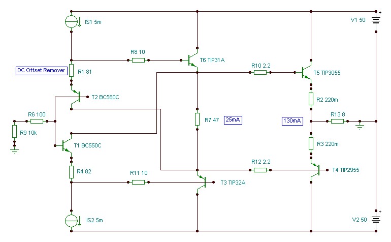

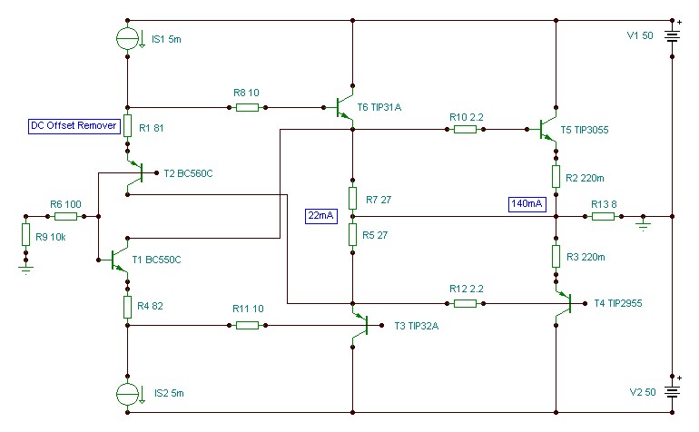

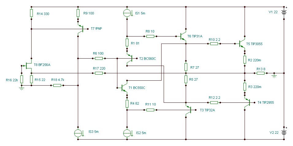

WuYit, i see problems with that, it will go into thermal runaway without a thermal compensation circuit.
Post #2051 , that is more like the Nakamichi. Either add a diode pair to both diamond emitters or a single diode and replace the diamond with darlingtons. Attach either to the main heatsink with the driver/OP's and the diamond will negate the OP's Vbe.

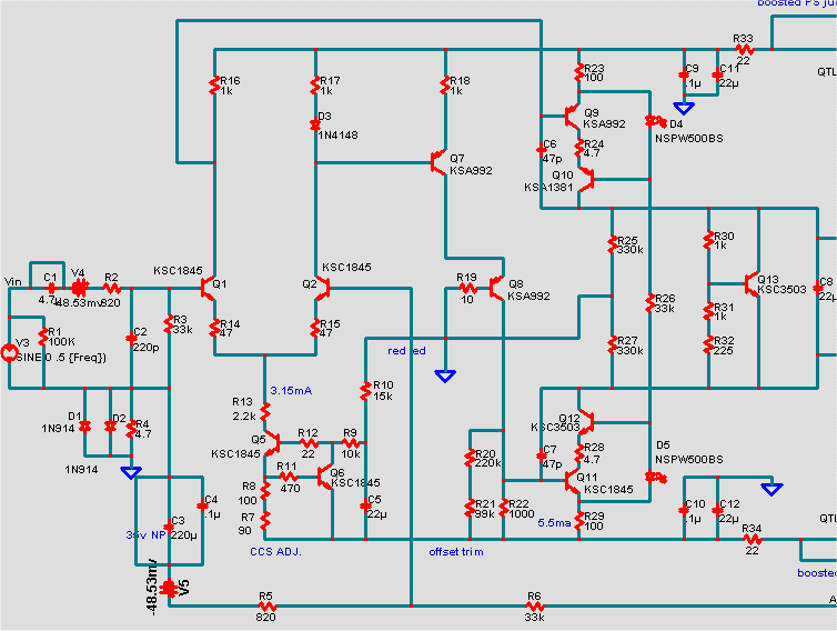

Also , Wuyit's circuit is a diamond (buffer) , Mine is just a "drop in" replacement for the good ol' EF2. Also, I see R5/7 hooked to the output. In simulation , this actually degrades THD by X3 (below 1) and has no effect on either stability or dc offset.
Stability is the one thing that kept me from this up till now , not only will it negotiate any transient test with any load in simulation but will clip "gracefully" ... introducing no parasitic oscillations even into a 10uF load.
I have found that the decoupling of the drivers/ccs and the choice of CCS is what gives stability in THIS triple. The CCS and what TYPE of CCS makes all the difference, as it does nearly all the work in the predriver stage. A 2Q CCS was not as stable as the red led version - too much gain. I'm sure with basestoppers on a 2Q I would be golden - but I like the warm glow of the 2 LED's 😀 .

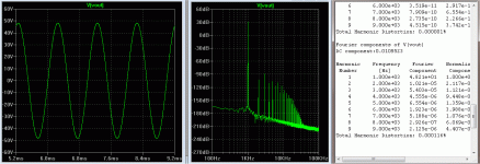

As it is (below 2) , it has faithfully driven my subwoofer for 3 weeks straight - and simulates like nothing else I have worked with (below 3). Good to go ! 🙂

ostripper likes keeping half of his circuit secret or out of view.😛
It's just too big to fit on the screen 😀 .
Nothing special , just the luxman/ hawksford voltage stage with a standard Vbe.
(Below) is what I ran for 8 months a year ago and have been running for the last 3 weeks. It references to page 144 - fig. 7.14 in the book , is similar to the Holman apt1 , but has the hawksford VAS.
R7 (ccs adjust) - you can set IPS/VAS currents , by trimming R21 - offset can be adjusted. Super simple - I have tried CFP inputs , but not the FET/cascode arrangement.
Would most likely be a very nice amp on a standard Lateral OPS - with drivers.

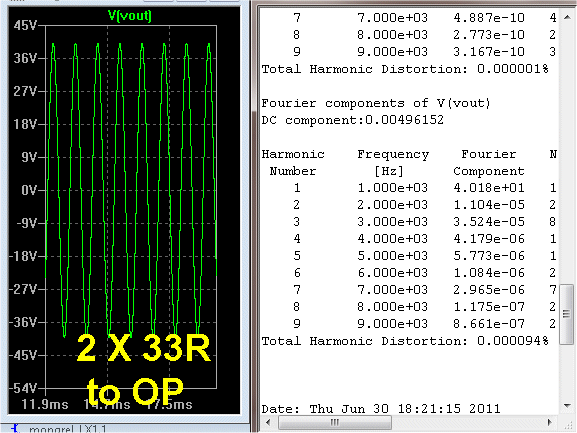

THD20 is stellar - can match or beat a TMC LIN with twice the loop gain(below2). EF2 gets a "whoopin'" at 2 and 4 R , as well (THD wise)

Tekko,
Unfortunately, yes, that in post #2050 more quickly. It´s a pity since it has advantages over the Vbe multiplier.it will go into thermal runaway

Hi WuYit,
Could you elaborate on what you consider the advantages over the Vbe multiplier are?
Bob
Bob,
I see the Vbe multiplier as a disturbance in the VAS load (a nonlinear element). In this way, no need for an in itself aggravating bypass capacitor to improve high frequency distortion and transient response.
Another problem with the triple (when composed of devices with the same polarity) is an alarming rise in saturation voltage.
