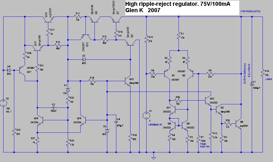

I'm away to breadboard a 60V version, unless there is a mk111 due out soon.
Yes! There is a MKIII version (I really can't help myself). I have now gone a bit nutty, having added a series pre-regulator.

If the pre-reg is that good, then how much of that improvement could be got from a 317?
I see you have reduced the CCS cascode now that dissipation is way down, since it does not have to cope with 105V on the input.
What voltage across the CCS gets best performance from it?

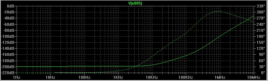

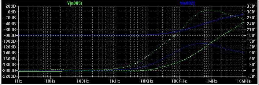

I have made at MK4 version, with a slight improvement to the series pass pre regulator, which now gives a few dB better ripple rejection with crappy MJE34(5)0 trannies. The pre reg simulates about 80dB ripple rejection out to 20kHz.
Look at the plot attached. The blue trace is for the output of the pre reg, the green trace is the 75V output. Haven't compared this with an LM317 datasheet but I'm guessing It's probably about 10 to 20dB better.
I'm running Q7 with about 5V Vce. If I lower it to a volt or so the ripple rejection decreases by a (minor) few dB, probably due to Cob going through the roof at low Vce. Anything above 5V makes no difference.

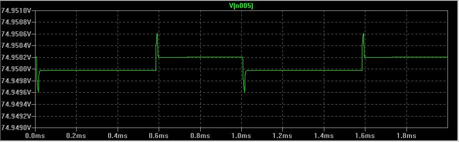

Due to a bigger output cap combined with smaller emitter degeneration resistors for the LTP in the shunt reg section, the 100mA load on/off response and output impedance has improved also:
This is definately the final version; I'm now laying out the PCB.

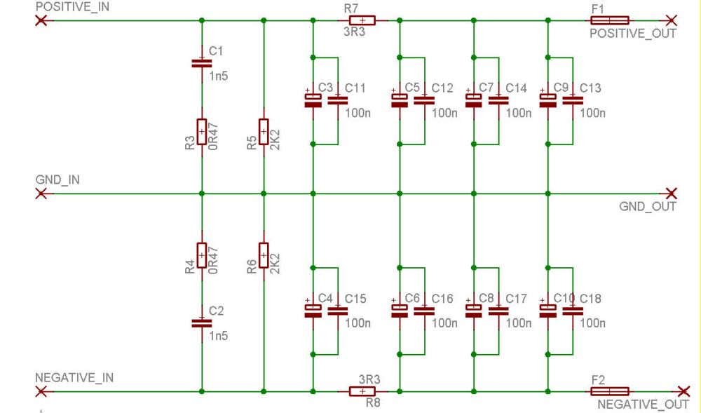

Hi all,
I need your opinion about this power supply. It consists of a 40-0-40V 400VA toroidal trafo with one metal bridge rectifier for both rails,each rail will have 4 x 10000uf/80v caps. The 3R3 resistors in each rail will have 40 turns of 1mm enameled wire on them (as a coil). It's going to feed a 150/300W 8/4ohm Class AB amplifier. Do I have to make some changes, according to your opinion-expirience?
Thanasis.
