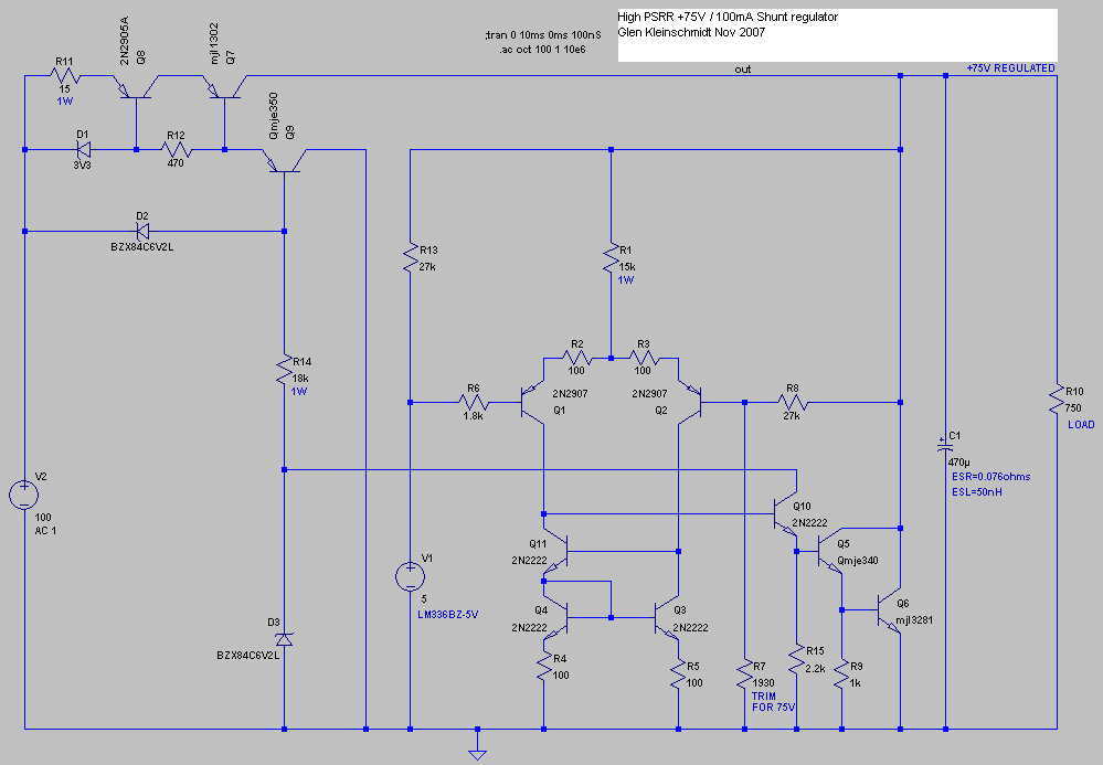

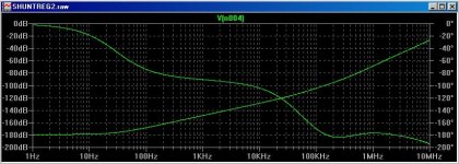

Here is a little shunt regulator I’ve designed to provide the low power +/-75V supply rails for a class A amp I am building. Shown below is the positive half. The negative half will be identical, except the NPN's swapped for their PNP complements and vice versa. Efficiency was not a design concern.

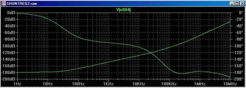

Stability is rendered unconditional by the 470uF output shunt capacitor and PSRR (or ripple rejection) simulates better than 120dB out to 20kHz.
Here is a dynamic load test. The 100mA load (750 ohm resistor) is switched in and out of circuit at a rate of 1kHz. The load/no load level shift is about 400uV, indicating a “DC” output resistance of 4 milli ohms.
The key to this designs performance relies on the fact that the intrinsic output impedance (prior to the application of NFB) of a shunt regulator is very high. This means that an output stunt capacitor can provide plenty of HF attenuation, thus providing the dominant frequency compensation pole and still allowing the use of lots of negative feedback to regulate the output.
I’ve seen quite a few shunt regulator designs where it is evident that the designer has not recognised this fact, and they have done a silly thing such as trying to frequency compensate the gain block by rolling off it’s HF response. This “dominant pole” then has to compete with the frequency pole provided by the output shunt capacitor, thus needing to be set really low, killing the performance - especially the high frequency ripple rejection.
In simulation the design here does not begin to oscillate until I increase the ESR of the 470uF shunt capacitor to a huge 7 ohms, indicating a pretty reasonable safety margin.
Well that's my theory anyway, so I have designed this thing to prove it to myself and I will build it for fun.

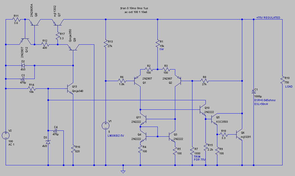

Hi GK,
could you explain the operation of the second part of the CCS (Q2 & R12)?
Could you try adding a pair of equal caps? One across V1 and the other across R8. Try 1uF film to start, then increase to 100uF electrolytic.
Is this just as stable?
Does it improve performance?

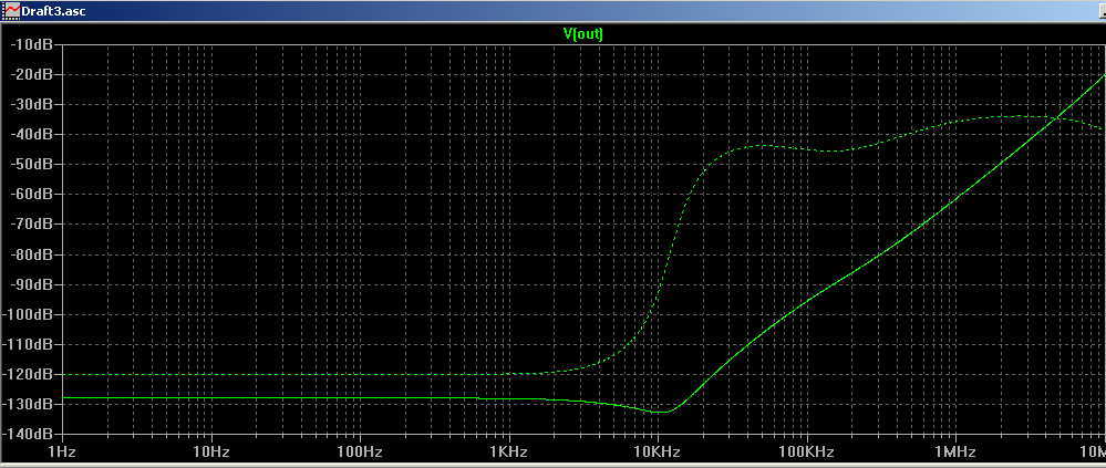

Q8 is the CCS, Q7 being its power dissipating cascode. This was done to improve the CCS’s ripple rejection. You cannot make a decent CCS with a high power transistor (high junction capacitances). Zener D2 is used as a secondary reference, buffered by Q9 to further improve the regulation of the CCS biasing voltage.
Unfortunately bypassing R8 with as little as 1nF turns the circuit into an oscillator. Bypassing voltage reference V1 in a real life version would reduce reference noise, but such a bypass capacitor would be best connected between ground and the other end of R6, taking advantage of the low pass filtering effect.

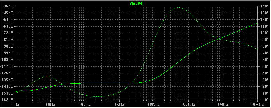

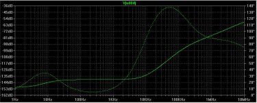

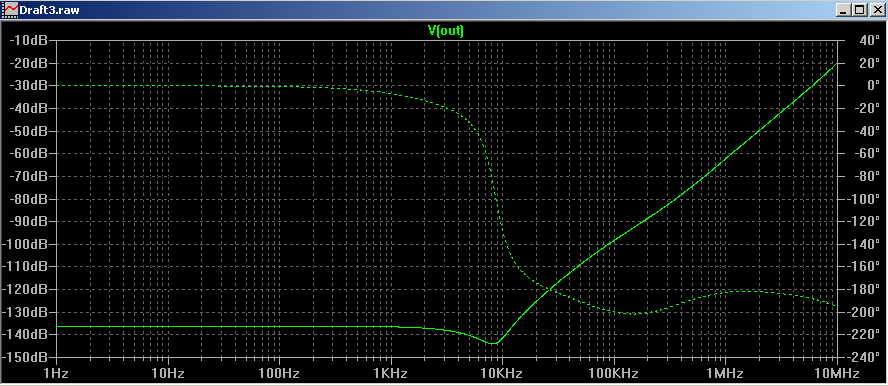

The best way to improve the performance is to parallel up more shunt capacitors on the output. Below is the simulated ripple rejection plot for an additional 470uF low ESR electrolytic - now better than 160dB at rectified line frequency (100Hz). HF output impedance is also reduced proportionally.
Glen

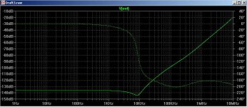

G.Kleinschmidt said:Below is the simulated ripple rejection plot for an additional 470uF low ESR electrolytic - now better than 160dB at rectified line frequency (100Hz). HF output impedance is also reduced proportionally.
The MJE340 driver was also substituted for a KSC3505 and the 750 ohm resistive load was substituted for a 100mA current sink.
EDIT: scrap that, I'm getting mt LTspice files mixed up. That last plot shows the ripple rejection of the regulator unloaded with two parallel 470uF shunt capacitors.

Bypassing R8 decreased the HF closed loop gain to unity. The regulator was not unity gain stable with a single 470uF output capacitor.

Hi Jan
I can get the 23dB (27k/1.93k) improvement in LF ripple rejection by bypassing R8 with a suitably large capacitor, but then the output capacitance ESR becomes critical, both for stability and transient response.
I can reduce the open loop gain to make amends for this of course (larger LTP emitter resistors or emitter degeneration of the shunt transistor), and hence the negative feedback factor, but that obviously defeats the whole purpose of bypassing R8 and just gets me back to where I started! 🙁
The circuit has a huge stability margin without R8 bypassed and is pretty insensitive to the output capacitance ESR and still simulates better than 140dB ripple rejection out to 15kHz with 70dB ripple rejection at 1MHz.
This is about as good (and more than good enough for the intended application 😉) as I think I can make it without making the regulator section excessively sensitive to layout and capacitor ESR.
Improving the CCS would be my preferred next step for improving the ripple rejection.
Glen
