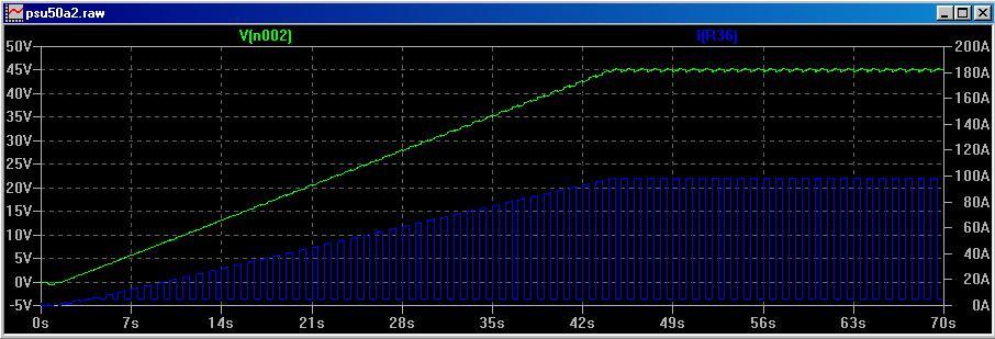

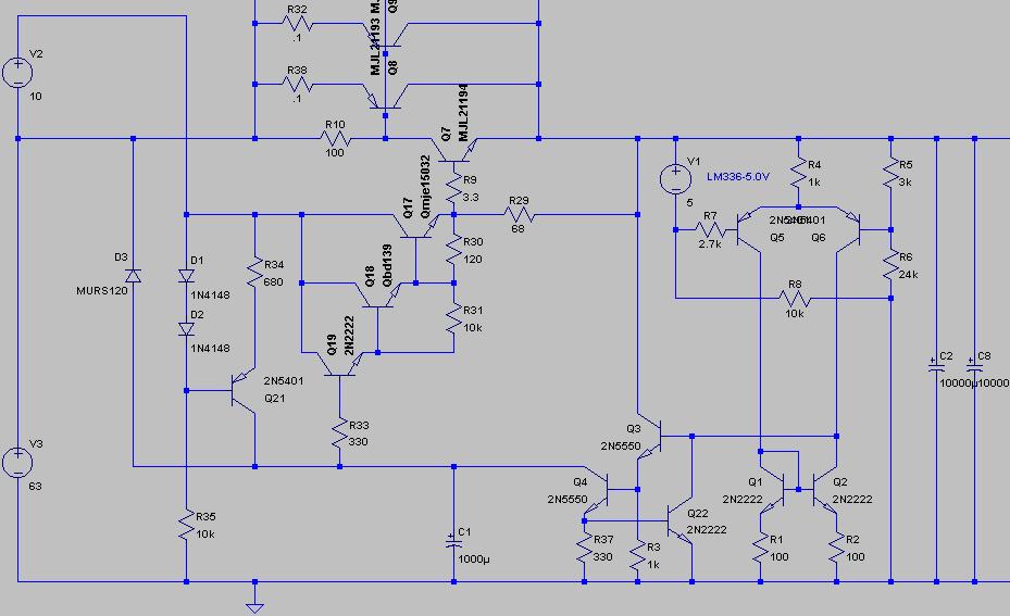

Here is a basic simulation schematic of the regulated +/-45V power supply I have designed for the power output stage of one of the three monster amps I am currently working on.
The amplifier is question is rated at 800Wrms into 1 ohm (40V peak) with a bias current of 5A for class A operation to 200Wrms into 4 ohms. Output current will be hard limited at 100A, providing full amplitude drive into a load resistance of 0.4 ohms.
Only the positive half of the regulator is simulated, the negative half being identical except that polarised components are inverted and the transistors are swapped for their N and P channel complements.
The design is unusual in that, while having a very high loop gain and therefore high (far better than required) DC precision, global negative feedback is not utilised to produce a low output impedance, as massive over compensation is used.

The series pass element consists of twenty MJL21193 PNP transistors in a CFP arrangement with one MJL21194 NPN driver transistor.
The CFP provides a lower output impedance than a straight emitter follower due to the local NFB loop.
The 20 parallel series pass devices ensure that the output impedance does not rise significantly at high load currents due to beta droop.
Q17, Q18 and Q19 form a triple emitter follower driver for the CFP.
Transistors Q5 and Q6 form the error sensing long tail pair, comparing a fraction of the output voltage developed across R5 against the reference diode potential.
Q1 and Q2 form a current mirror load for the LTP and Q3 and Q4 form a buffered VAS, resembling a common audio amplifier circuit.
Q21 is a 1mA constant current load for the VAS. C1 is the frequency compensation capacitor and the VAS current is limited to 2mA by Q22.
This results in a maximum push-pull charge/discharge current for C1 of +/-1mA, giving the global loop regulator a response .001/1000e-6 = +/-1volt per second.
This response is so slow that it ensures the regulator loop does not “fight” the audio signal current to keep the output voltage constant and provides unconditional stability into the excess of 20,000 uF of filter capacitance on the output (2 X 10,000uF + 1000uF + 100uF + 10uF + 1uF + 0.1uF).

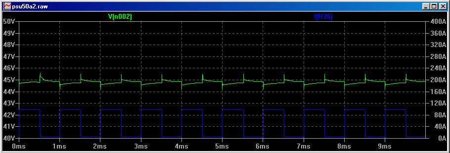

Attached below is an output ripple simulation with a load current alternately switched between 100A and 5A at a rate of 1Hz. Due to the 1V/s time constant of the feedback loop, the regulator takes ~45 seconds to ramp up to the +45V regulated output voltage.
