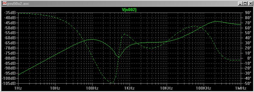

If you have a closer look at the schematic, this IS a more elaborate version of a capacitance multiplier (look at what C1 is doing!)
The only difference is that the output voltage is fixed and a greater voltage is dropped across the series pass devices. But this overcomes a major operating flaw of the capacitance multiplier - things go bad when the input voltage sags below the charge on the base (or gate) capacitor under high load current demands.
Also, power dissipation isn't an issue with my heatsinks and I've got 25 spare pairs of MJL21193/MJL21194 to use up 🙂
MOSFET's were ruled out because they give no where near as low an output impedance as the big bipolar CFP (Think of Vgs variation with Id of a source follower, then take another look at the simulated voltage droop of my circuit with 100A (!) load current.
You can of course make a MOSFET CFP with a bipolar driver for a follower, but it still isn't as good due to the much lower transconductance of power MOSFETs (especially HEXFETs).
Also, I will be using dual secondaries and dual bridge rectifiers, but the + and - regulators with be complementary mirrors of eachother. Not sure what the benefits WRT grounding are by using indentical (single polarity) regualtors in series)?

The super dooper OTT power supply will provide very clean rails for the output devices, with minimal rubbish to modulate the driver output via Cob (The rock stead rails will also work in conjunction with a VAS clamp to provide super clean clipping)
Below is the simmed ripple rejection (solid line)

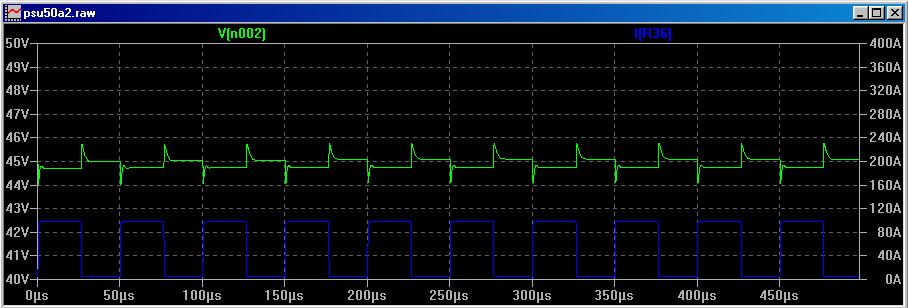

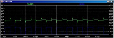

No! the over current protection system I intend to implement will simply crowbar and shut down the power supply completely and mute the audio input signal. It will stay that way until manually reset.
The series pass transistors in the psu will only ever drop approximately 15-20V while delivering the rated current, which gives a worst case peak dissipation of only 100W in each series pass device when delivering a peak load current of 100A.
The average current/dissipation is much less. When delivering a continuous full amplitude (40V peak) sinewave into the minumum specified continuous power load resistance of 1 ohm (for a peak load current of 40A) the average current drawn from each supply rail will equal 40A/pi = 12.7A.
With 20V dropped across the 20 series pass devices the average dissipation will only be a minescule 12.7W per device.
Also note that this dissipation is under continuous sinewave conditions, which no full amplitude music signal will ever replicate.
So, with music signals, the amp has enough SOA headroom to deliver peak currents of 100A into a low enough load impedance without breaking a sweat
