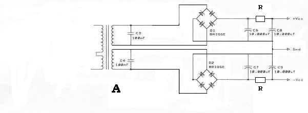

G.Kleinschmidt said:
So why does this gate signal have to come from an oscillator?
Why not just a resistor from a fixed potential of, say, +10V above A2?
Draw a proposed schematic with all the details (delay, etc...) and you'll probably understand yourself.
The new gate pulse has to come while the A1-A2 voltage is not zero. That's why the oscillator frequency can't be (say) 1MHz, it is to close to the zero crossing. It also can't be 1KHz, the triac would have time to turn off.

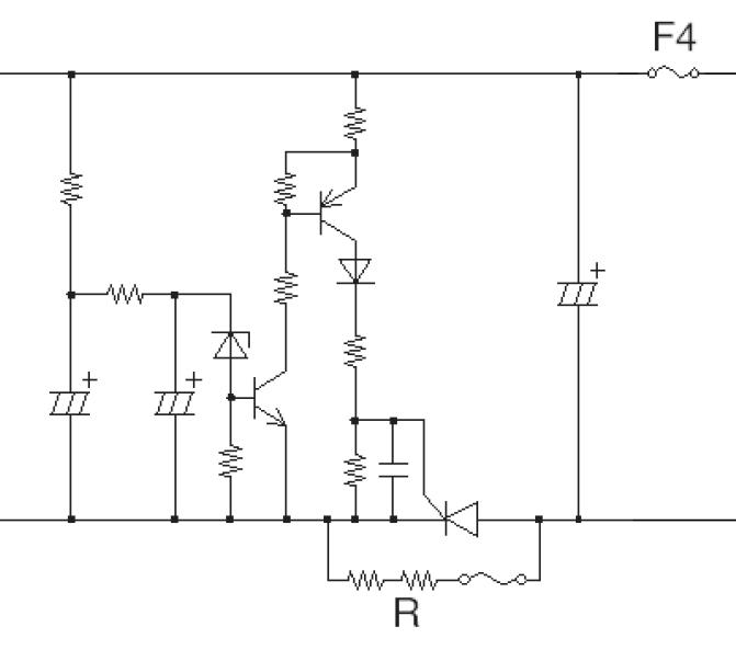

On a similar subject, has anybody figured out how the Bryston soft start circuit (schematic PDF here) works? This seems to use a technique similar to what Jan just described above, which avoids the power resistor. It uses the TDA1085C chip. I have tried going through the datasheet of this chip, but it's quite possibly the worst datasheet I have ever read.
I really like the idea of eliminating that power resistor.

andy_c asked
The TDA1085 is designed as a closed-loop motor speed controller. But in this case, the closed loop motor control is disabled - there is no tacho or analogue speed sense used. Instead the motor set speed is determined by an RC network (C6 - 100uF plus R17/18/20) so the set speed will 'slowly' ramp from zero to full speed after turn-on.

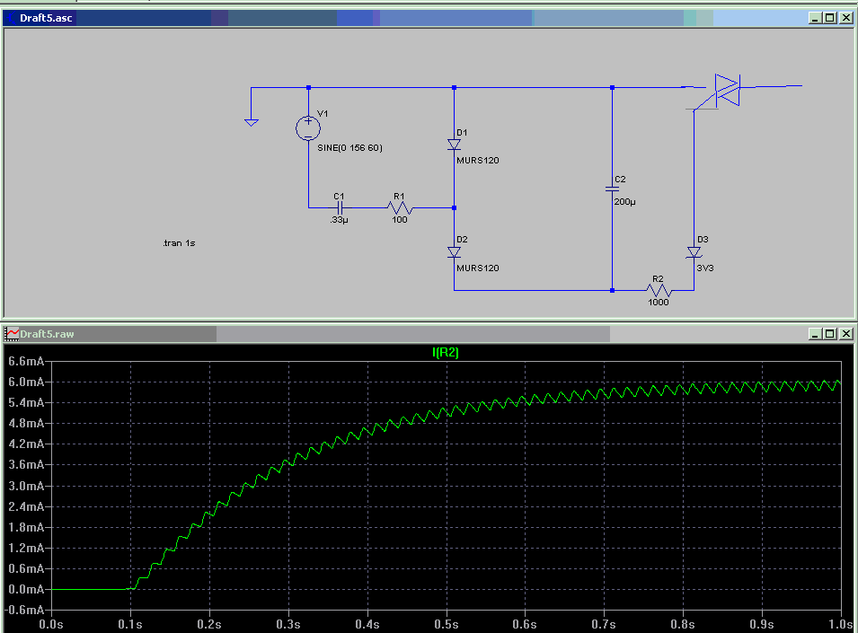

Thanks Glen, now I understand... Though, I would rather not do it this way. Reason is that the whole thing sits in the hands of C2 (electrolytic). As soon as C2 will dry out, the thing will crash and burn. In the original schematic, C2 has only to provide the gate current only during the pulses, that's why C2 can be smaller in value.
It seems like you don't have a good triac model; here's one:
Thanks very much! Maybe a good way to test it on the bench would be to have a variable DC into the speed control input using a pot. Then I assume by varying this voltage, the duty cycle of the AC will vary.
Yes. The chip is specifically designed for triac phase control - unlike the UC3637.
I'm not sure what you see as a disaster in that datasheet. It was clearly designed to be pretty application specific so if you do not have that application in mind then it may get a bit confusing. If you think that is a disaster - well, you ain't seen nothing!
It appears to have been written in a language other than English and translated by someone that doesn't appear to know engineering. Here's some examples:
"This half wave current is used to feed a smothering capacitor..."
"All along the main line cycle, the Pin 10 dynamic range must not be exceeded unless loss of regulation."
Granted the designer or translator may not have good English skills, but this sort of stuff should be proofread before being published. Also, the schematic in Figure 8 looks like some sort of practical joke.
It does look like a good part for the application though.

This is so in some phase control circuits also, which depend on a slow RC time constant. If the phase control circuit doesn’t fully reset during a brief power interruption, the TRIAC will likely turn back on at the worst possible moment and smoke if it wasn’t selected for a sufficiently high Itsm.
Many step-down transformers for low voltage home lighting (unless specifically designed for low in-rush current) are not recommended for use with simple TRIAC phase control light dimmers for this reason.
If you circuit does rely on slow RC time constant, a small relay with the coil energized by the AC mains after the power switch can be a simple solution – the normally closed contacts are connected across the capacitor. This way the capacitor is discharged immediately when the power is switched off or accidentally interrupted.
In my amplifier (which has a 240VAC/10A inlet for each channel due to the power requirement) instead of a power switch I am using a pair of multiple pole/contact relays to switch the AC mains prior to the PIC sequenced soft start circuitry.
The relays have 240VAC coils and are connected in parallel. They are connected to the AC mains via two series connected momentary push buttons, one a normally closed type and the other a normally open type. The normally open one is connected in parallel with a normally open pair or relay contacts and acts as the power ON button and the normally closed push button is the power OFF.
This is how small plant machinery is wired. The power ON/OFF buttons are only required to pass the relay coil current and the relay(s) drop out when power is interrupted, preventing the machinery from restarting.
Applied to the amplifier circuit, prior to the soft-start (I will either use TRIAC phase control or a pair of TRIACs in series/parallel with the in-rush limiting resistor so there is zero initial current to the 4kVA of toroidal primary windings), the relays only switch a small current (the supply transformers for the auxiliary control/sequencing circuitry) so contact wear isn’t an issue.
The AC mains switching relays also one level of redundancy in that a TRIAC breakdown or similar failure will not cause the amplifier power circuitry to draw current from the mains.
