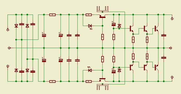

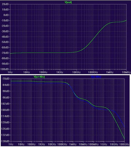

A simple study case, my simple "one stage" amplifier, folded cascode, has very poor PSRR at freq over 10kHz (see figure, above graph).
The second graph in the attached picture is the PSRR graph of the "super regulator" which is presented in the next post.
Shall I presume that the final PSRR will be the superimposed figure?
roender said:Super regulator principle schematic
Roender,
Not trying to rain on your parade, but that is not a superreg. All the superreg variations, its predecessor and followers had one thing in common: they use a feedback loop with an error amp. In this sense, that circuit isn't a regulator at all.
The term superreg isn't trademarked AFAIK, but calling all power supplies 'superregs' DOES cause confusion.
To your question: I would expect the figures to add ONLY if all the wiring, parasitics and mutual couplings were taken care of. I expect in reality that the result is less than the sum of the parts.

janneman said:
Hi Kevin,
There are several issues here mixing themselves up. Firstly, using a 2SC3281 for low current applications (100mA?) doesn't make sense for the reason you mentioned. BUT if you need a high current reg (say for a class A amp) that 2SC3281 does make sense and the low beta at low Ic issue goes away. In the 'superreg' a lot of people use those D44-types and they have good gain linearity at lower currents.
If you use the right BJT for a 'superreg', changing it out for a mosfet will most probably lead to lower loop gain and lower performance but I know I shouldn't make blanket statements here without knowing all the particular circuit details. Another issue with mosfets is the higher drive voltage required although the low-Vgs types may be better here.
Jan Didden

AndrewT said:Controversial is my middle name.
If the PSRR of the amp degrades to -40db @ 100kHz on the negative line and the PSRR of the cheap/easy single chip regulator also degrades to a similar figure @ the same passband frequency, then that is a total attenuation of near 80db on the output.
In the meantime the circuitry of the amp has had to handle all that non-correlated noise while trying to amplify the wanted signal.
I suspect some interaction and that the products of this interaction could be above the -80db level.
Now take your -100db below max output noise figure.
That's not good enough. It's an OK figure but we can do a lot better.
I would try for -90dbW and maybe even set the target at -100dbW.
The noise at the output should then come out as just about inaudible using 100db/Wm speakers (provided there are no exaggerations at any particular freqencies/bands).
Hi Andrew,
I'm glad my Devil's Advocate questions stirred up some discussion.
Note that the amplifier I was using as an example was already rated at 100 dB S/N wrt 1 Watt.
Of course, you are exactly right about PSRR of both the regulator and the amplifier itself degrading at higher frequencies. But this is the easy part to fix with even an IC regulator.
Take an LM337, which is the worse of the two. Its PSRR is as follows:
100 Hz: 75 dB
1 kHz: 65 dB
10 kHz: 50 dB
100 kHz: 30 dB
1 MHz: 10 dB
Now just put a 100 Hz first order RC filter in front of it on the source side:
100 Hz: 78 dB
1 kHz: 85 dB
10 kHz: 90 dB
100 kHz: 90 dB
1 MHz: 90 dB
That can be done with a simple 10 ohm input series resistor and a low-ESR 150 uF electrolytic shunting to ground.
