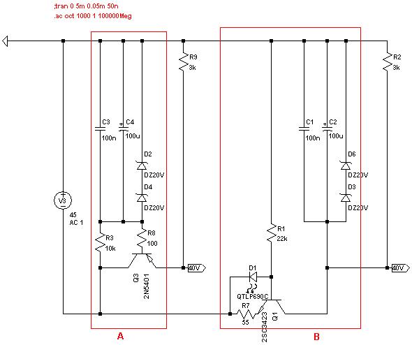

The right one is a nice one, it has a patent by Masao Noro, used in STAX amps. CCS+shunt regulator.
roender said:Which one from this two PSU for front end (LTP + VAS)?
I need good stability, low noise and and high PSRR
Why not run a sim for those attributes? Noise is simple, Zout is simple (just insert a signal current into the output, measure the signal voltage at the output pin, and divide). PSRR: put a signal source in series with the input battery, measure signal output, sweep over frequency. Divide and show in dB.
Personally, I think from a first glance that B is better.

I have done simulation but I don't trust to much the results. If you had experience with this two PSU, which one do you recommend me to use?
You may wish to build them both and simulate as well, as mentioned above. However, I think in fairness you also need to convince yourself that either of these is better than a properly-applied LM337.

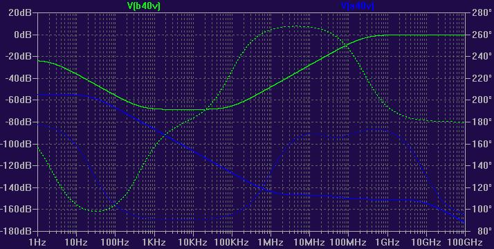

Green, PSRR for simple PSU
Blue, PSRR for super-shunt
OK, thanks. So I guess this is the supression of input ripple over frequency? Or Zout?
Jan Didden
