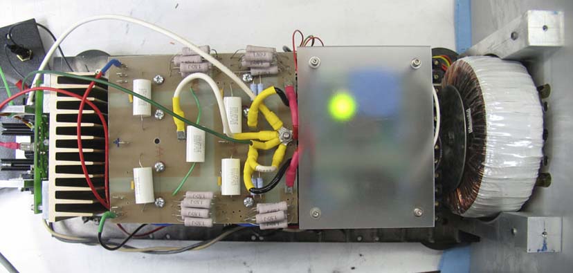

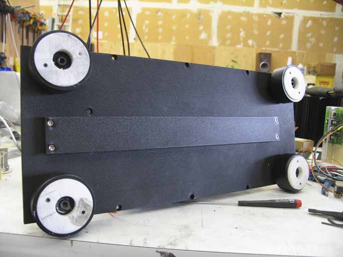

No, I do not see any problem to it. I did it in my recently finished amp:
Here is what I did to solve the problem of wiring that needed to go across the whole length. The wires are outside covered with aluminum channel. Dead quiet.

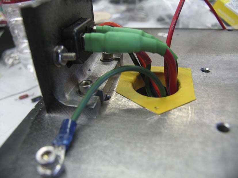

Here is the wiring going out of the box right from the AC connector. I was playing with liquid plastic/rubber - yellow portion around the hole and I was very happy. It serves the purpose of protecting the wires from the sharp edge of aluminum base.

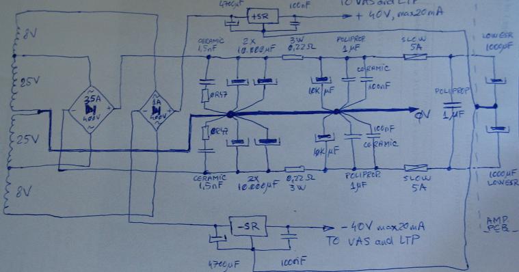

Hello all
Please help me with this PSU design. I'm not sure if the common 0v for VAS and LTP is correct connected to the main GND
The SR for first stages will be standard zener + bjt serial regulators.
The last 1000uF low ESR capacitors will be as close as possible to the output BJTs and the amp's PCB will be designed with internal starground
All suggestions are welcome
Mihai
