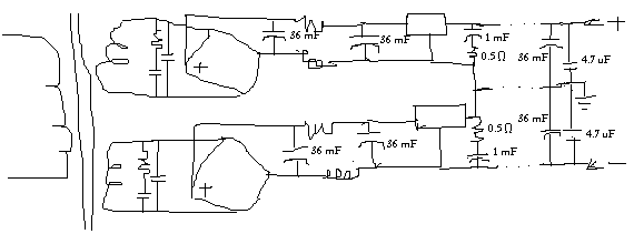

I use dual bridges, but I use transformers with dual secondaries, which is much more flexible than just center tapped ones. Note that such a configuration allows one to use two positive regulators (or capacitance multipliers) for regulation, instead of the positive and negative one required for a center tapped setup (all you do is configure the output of the lower regulator to be connected to ground). You can also use chokes instead of resistors on the ground side as well. Consider the attached example which is my Aleph-X power supply (the regulators are the discrete capacitance multipliers from Mr Evil's site).
Bah, I made a mistake, as I was thinking of another supply where I used two positive opamp-driven shunt regulators. Mr Evil's cap multipliers have both positive and negative: http://mrevil.pwp.blueyonder.co.uk/amp/amp4/sub/psu2.shtml
I have CAD files for the PCB if you want, though I took off the bridge and filter caps from the PCB since I wanted to use the CRC before it, and way larger caps.
Note that my Aleph-X supply is similar to the schematic I posted, just that the ground connects first in the +/- cap multipliers rather than the two positive regulators drawn. Part values are correct, but the snubbers on the secondaries are not finalized yet as I've not put the scope on and tested for ringing. I was thinking of adding the rail-to-rail instead of rail-to-ground cap on the end, but I'm not sure what value. mF is not a mistake but I mean millifarad.
Not show is what I put on the primary for almost all supplies I make: a MOV, gas discharge arrestor, mains filter with common mode choke and X and Y caps, fuse, a DC trap, and a thermistor.
