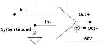

AR2 said:Here is the drawing of the power supply as I promissed with your input. Please note correctios if needed.
Thank you
AR2
dunno to whom this post is addressed.......but looks fine for me ;
just one thingie - why you grounded minus output?
I think he's just showing signal ground that way.Zen Mod said:why you grounded minus output?
I'm not sure ;
I know what he's building
It is probbaly lost in compression - connections are marked with small black dot. That was just wires crossing each other without connection. I will correct and make bigger dots, so if someone looking into it ... wouldn't make same conclusion as you are.
more milling ,less drawing......seems as best recipe for few days
edit:
I edited just two red circles.....nothing more 😉
