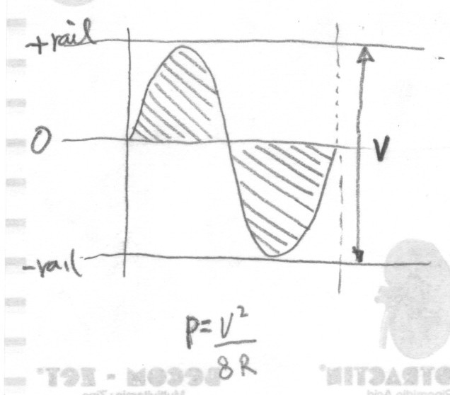

I'm thinking about this, don't know if it is right or wrong. It could be dangerous too (never done it before).
To know how many VA a certain power transformer can put into the speaker.
I assume the audio amp cct already has low impedance (to be neglected in the test), then the determining factor is actually the power transformer itself.
Connect the secondaries of the power transformer to dioda bridge rectifier (with its capacitor bank, to make +/-rail DC).
Then connect this +/-rail to dummy load (4 ohm or 8ohm, but I will have to provide about 1000W dummy for this transformer test).
Then I can measure the voltage drop on this 4ohm load, how many volts. From the equation P=VxV/R, if we know the V and R value, we can know the P output into 4ohm or 8ohm.
This is to get DC wattage. To get AC wattage (audio), what is the conversion factor?
More important : Is this dangerous to do?
Yep, because you may have a 99 % chance of overloading the transformer and a 1 % chance of getting the right VA rating.

hi,
you don't even have to employ rectifiers and caps, just put the dummy load accross the transformer secondary and see how fast the temperature rises, or how low the secondary voltage drops. that will give you a clear picture of the transformer's capacity...
Hi, Jacco,
Yes, it will be dangerous. I won't try it.
Hi, Tony,
If I want to know the transformer capability of delivering to 4ohm load, what is the R dummy size (ohm) that must be used for the test like you proposed?
In real amplifier (with -speaker connected to 0/gnd), the energy that is delivered to the speaker is just 1/8 of DC wattage, because it is sinusoidal area (shadded area).

David,
most toroid efficiency graphs show the highest efficiency rate at around 25%=> Pout/Pnominal.
Increase the output load and the efficiency rate starts to go down.
At a point beyond Pout/Pnominal = 1, the efficiency rate will collapse.
The nominal VA rating often is 90% of the output of the breaking point in the efficiency line, or the point where d(Pout)/d(Pnominal) suddenly changes is at 110% of the nominal VA rating.
