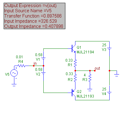

john curl said:Could you try it with .33 ohm and 50ma? That is what my cheapest Parasound design uses.

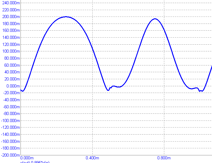

It looks something like this with 21193/21194, the models do not seem to have fatal error.
PMA said:
This is "optimal class B bias" (some 47mA) for lowest distortion NUMBER. Though distortion seems low (like 0.02%), its spectrum is horrible. No real NFB can cure it.

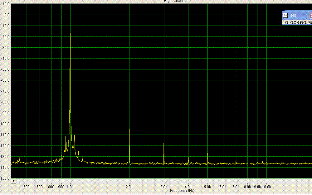

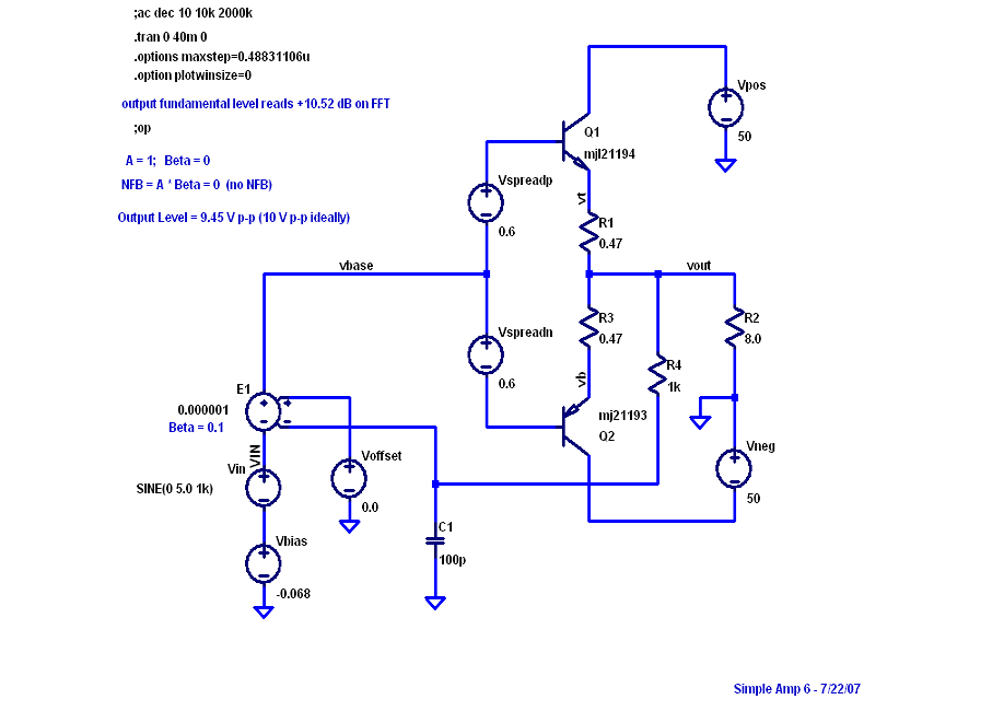

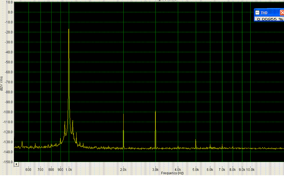

In my case, I used MJ21193/MJ21194 output transistors with 0.47 ohm RE and over-biased at 152 mA so as to exhibit gm doubling crossover distortion. The load was 8 ohms.
My results are shown below. They show a very well-behaved and predictable reduction in all harmonics as NFB is applied and increased. Note that this was a simulation at 1 kHz and about 10 V p-p into the load.
I wonder if the differences between our results are due to the use of different models or due to my operating into the gm-doubling regime. I did the simulation in the gm doubling regime because I usually prefer to err on the side of over-biasing an output stage (within thermal stability considerations), so gm-doubling distortion is what I am most interested in seeing reduced by NFB.
Bob

as I have explained earlier today, I found a significant error in the 2SA1302/2SC3281 models that I used in MC8. So please forget the post (image) you are referring at. The 1st valid simulation of crossover residual should be that of 21193/4 with 0.33 Re into 4 ohms:
http://www.diyaudio.com/forums/showthread.php?postid=1288036#post1288036

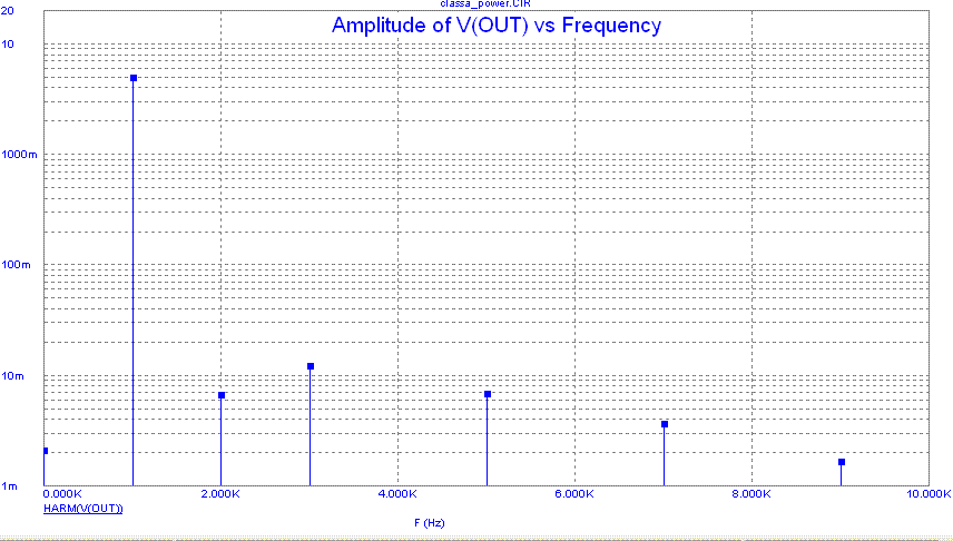

Now the graph for 3.5W/4 ohm. Again, only CFP output stage biased at 900mA. It is all quite fine until we get into AB. Then higher order h. start to rise, and only NFB can decrease them. Which is not the best way to do it.
