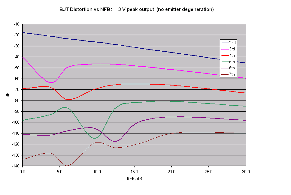

Hi Jan,
Yes, that is a good spot. There are two things to notice.
First, the amount of NFB where a given spectral component begins to fall with NFB is a number that is larger for higher order components. You can see this progression of the hump (maxima) to the right with ascending orders of nonlinearity. The 7th order distortion is indeed falling off at a shallower rate, and can be a cause for concern.
The second thing to notice is that this stage is being driven very hard, producing second harmonic distortion of fully 14%. Indeed, the collector current swing goes from a low of 0.81 mA to a high of 2.61 mA. When a stage is pushed very hard, it is more difficult to get rid of the higher order terms.

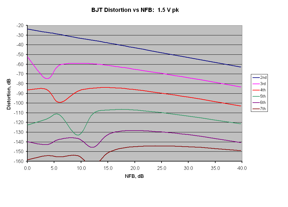

Now look at the plot below. Here we have operated the circuit at a level 6 dB lower, down to 1.5 V peak. This is a much more reasonable level. The collector current swing is now 1.17 mA to 2.07 mA; still a healthy value, but much more reasonable. The second harmonic distortion is now down to 7%, as expected.
Also, in the plot below, I have shown the NFB going out to 40 dB, so any trend is more easily seen.
We now see that the 7th harmonic does indeed decrease with increased NFB, but still with a slightly shallower slope.
BUT, note that, now, at its worst, at 23 dB of NFB, it is down 144 dB!
Bob

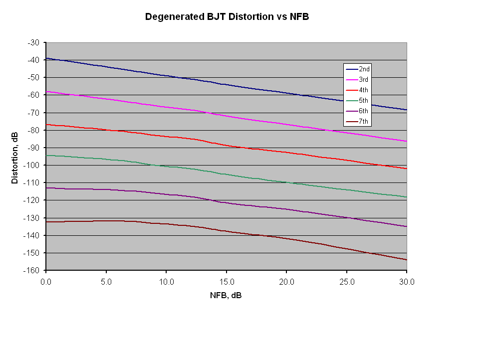

The plot below shows the distortion for a BJT stage that is degenerated by about 17 dB of emitter degeneration.
On this plot, interestingly, the decrease in 7th harmonic with increasing NFB is more in line with that of the other spectra. It gets way down there.
This is more reflective of the real world because most engineers elect to apply some emitter degeneration to a bipolar stage.
