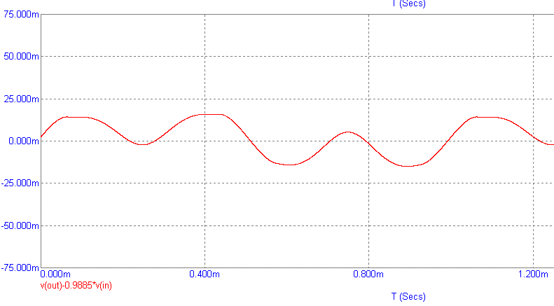

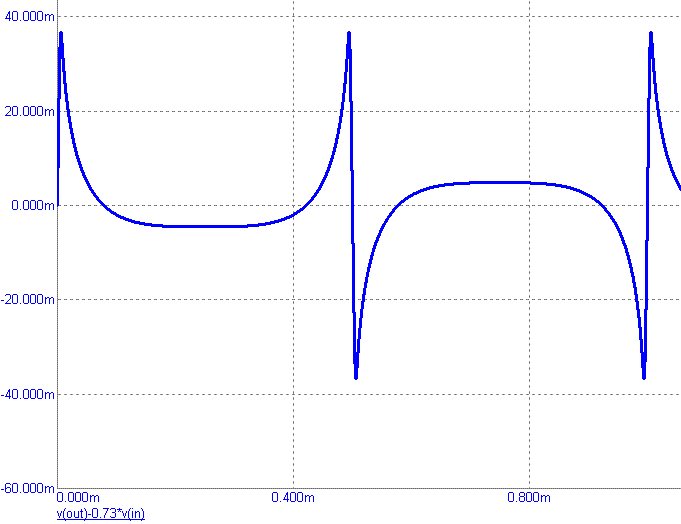

Simulation is pretty helpful, it enables to subtract output - (input x exact multiple of "steady state" transfer coefficient). The subtraction must be tuned precisely and then you can see what feedback has to control ;) . This is "optimal class B bias" (some 47mA) for lowest distortion NUMBER. Though distortion seems low (like 0.02%), its spectrum is horrible. No real NFB can cure it.
Hi Pavel,
Didn't you say that the emitter resistance was 0.1 Ohm? Self's optimum bias for that resistor value is 215 mA.
For a comparison, MOSFET output stage with error correction, Ibias = 350mA. 17Vp output into 4 ohm.

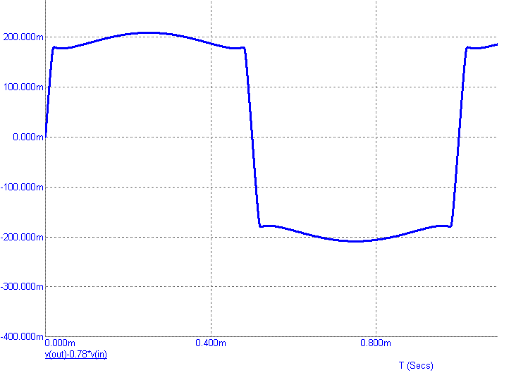

Hi Pavel,
Is there some attenuation between the voltage source and the EF circuit? The reason I mention this is that the scale factor for the input subtraction is 0.78, which seems low. Seems like it ought to be in the range of 0.9xx or so.

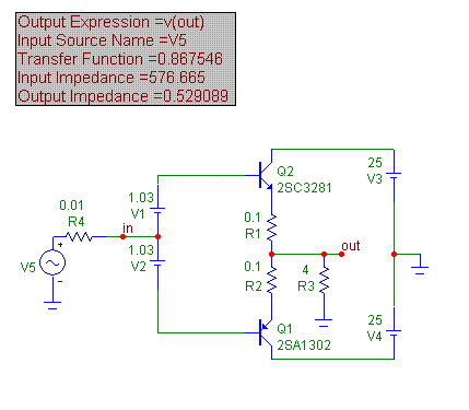

PMA said:
Hi Andy,
it is like this image. Transfer depends on load, it is 0.91 for 8 ohm and 0.87 for 4 ohm. The coeff I use is tu subtract 1kHz base sine to minimal residual. This depends on amplitude and load.

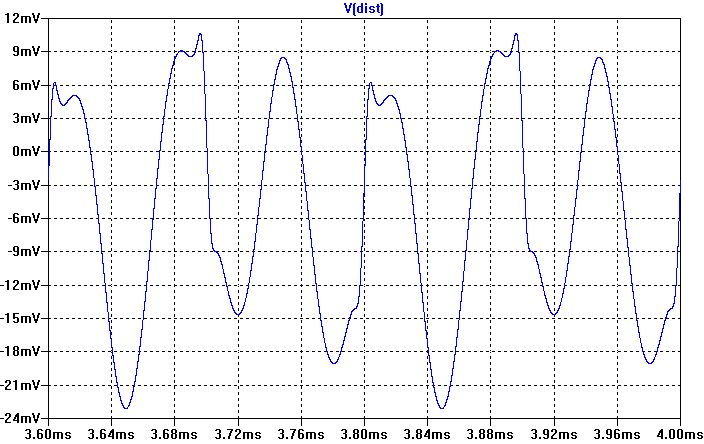

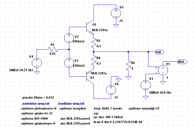

Hi Pavel,
I'm seeing results that are a lot different from this. Schematic is shown below - 25 Volts for Vcc, bias is 0.632 Volts per device for around 215 mA. I use the "dot FOUR" directive, which allows me to see a text representation of the amplitudes and phases of the fundamental and harmonics. I first set the input to 20V peak, then looked at the fundamental of the output. Based on this, I had to readjust the input fundamental to 20.75 Volts to get 20.00 Volts output fundamental component. So this gives me a large-signal gain of 20.0/20.75 = 0.96.
I'll post a zip of the simulation, which will include text files of the MJL1302a and MJL3281a from my web pages
