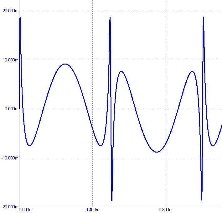

john curl said:Wow, PMA Now that is a challenge! I haven't seen a waveform like that in years.
It is not easy to see it on instrument screen. Simulation is pretty helpful, it enables to subtract output - (input x exact multiple of "steady state" transfer coefficient). The subtraction must be tuned precisely and then you can see what feedback has to control 😉 . This is "optimal class B bias" (some 47mA) for lowest distortion NUMBER. Though distortion seems low (like 0.02%), its spectrum is horrible. No real NFB can cure it.
