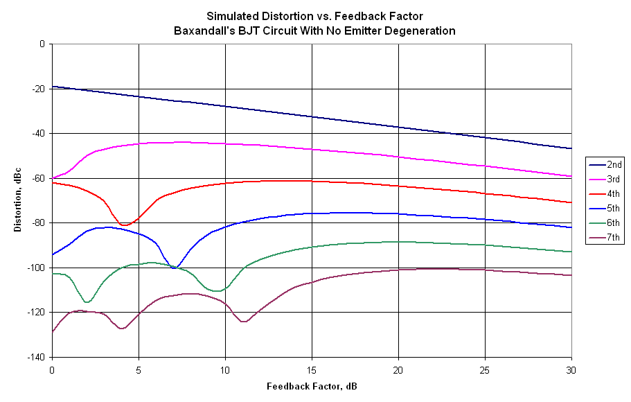

I just tried a sim of Baxandall's BJT circuit with feedback factor from 0 dB to 30 dB in 1 dB steps. Here is the graph I came up with. I'll just post it without comment.
Let me explain to everyone WHY I care so much about this. First, I was exposed to the mathematics of the 3'rd harmonic notch with negative feedback, back in the early 1970's. I was amazed, BUT it IS in the equations. Now where is the notch at 3dB feedback? IF SPICE ignores it, then SPICE is next to useless in this application. This is important to me, because I am told that I should be using SPICE on a regular basis, but I must know if it is reliable or not, if I can use it for anything that I am interested in.

John, I don't think I've ever told you that. I've always been of the view that people should use only the tools that they are comfortable with. If you are not comfortable with SPICE, it's not my concern. The solution to that problem is not to use it if that's the case.
But the formula for third-order distortion with feedback is what I was asking about. There are certain assumptions that need to hold for it to be valid. Baxandall himself, in his article, admits these assumptions are violated, causing significant errors in certain portions of his graph. In order to be able to say that a formula proves something, it's necessary that the formula not be used outside the set of assumptions under which it was derived.

That may be true for some folks, I don't know. If you check out my web pages, you'll see that I've devoted some effort toward providing some much improved models for the OnSemi XJL1302 and 3281 power transistors. It turns out that the models that OnSemi provide are way off from the actual device performance. In order to fix this and create better ones, one has to know... you guessed it... the real equations for a transistor. So in doing that, one is not running away from the fundamental issues, but facing them head on. People who proactively face those issues might be a bit miffed if they are characterized as being someone who blindly trusts the tool. That's where I'm coming from.
You do realize that SPICE uses all the same fundamental equations regarding transistors that you do when you do a pen and paper analysis? SPICE just happens to also take into account numerous lesser effects that would impractically cumbersome to include in a hand computation.
SPICE is just computer assisted math with an interface optimized for circuit design. It seems just as likely that your analysis is incomplete as it does that SPICE is making things up.
It should be noted that Bob's sim appears to have been done with a complete transistor model, not an idealized one. It is possible that the internal Re of the virtual 2n5501 provides 3db or more of feedback already, which would of course hide the effect you are looking for.
I stand corrected. The 2N5551 is a very poor part for this example and it is operating at a non favorable current to accurately convey any real information. It is the example, rather than the simultation that is giving the misleading results. The 2N5551 could, in fact, have up to 2 ohms emitter resistance, which is very high for most any part.
