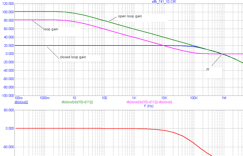

PMA said:The 2nd: the same stage in OA (OPA134) feedback:
Now the same for LM741. Compared to OPA134, one can see how uneffective is cross-over distortion reduction in this case. The reason is very low frequency of the 1st rolloff breakpoint, resulting in low loopgain at higher frequencies. The 2nd reason is low slew rate.
Most of the concerns about feedback in the seventies were based on low SR and low fT. Of course there was a problem. But to disclaim feedback completely, based just only on these drawbacks was quite misleading.

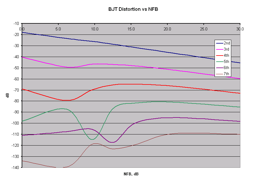

BJT distortion vs NFB - no degeneration
Here is the plot of distortion harmonics as a function of amount of NFB for a single-ended BJT with no degeneration in the same arrangement as Baxandall's.
Notice that the behavior is the same as Baxandall's graphs he obtained from lab measurements, including the roller-coaster behavior and "notches" at amounts of NFB below 20 dB.
This is very good news, because it suggests that SPICE can be used to answer these kinds of questions and that it can be used to explore the design space with some confidence.
It also shows that the presence of the degeneration in the earlier sims that I showed did indeed "mask" the effect of the NFB at low amounts of NFB, so in that regard I stand corrected and am appreciative that this behavior of the BJT in Baxandall's work was pointed out. This is how we all learn, even if sometimes we have to eat a little bit of crow.
But, remember, there is a silver lining here that still brings into question the position of the feedback-averse designers. In most real circuits, BJT stages have some degeneration that will make them behave very nicely as in my earlier simulations. Bear in mind that this circuit that shows this odd behavior and some NFB-enhancement of some distortion products is a completely undegenerated, single-ended, resistively-loaded BJT showing a gain of 200 and operated hard in terms of its signal current as a fraction of its bias current. Second harmonic distortion of this circuit without NFB is about 12%.
Also, look carefully at the vertical scale, that runs from -10 dB distortion all the way down to -140 dB. Above 20 dB of NFB, the 7th harmonic remains below -109 dB (0.00035%) across the board.
At least two interesting questions arize:
1) How much local degeneration is needed to get the circuit to the point where the application of NFB around it will only result in a monotonic decrease of distortion products?
2) If the application of degeneration is itself NFB, then do we see any enhancement of distortion products as a function of the application and increase of NFB when it is only in the form of degeneration?
Stay tuned.

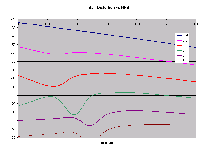

I was curious to see what happens to the behavior of the undegenerated BJT above when it is not driven quite as hard. I therefore reduced the drive by 6 dB so the output is now 1.5 V peak.
The unusual behavior is still evident. Be sure to note the different distortion scale, which now ranges from -20 dB down to -160 dB. Under these conditions, we can still see NFB-enhancement of the 7th harmonic, but the seventh harmonic never gets above -145 dB.
Bob
Bob, the level of 4th, 5th and 6th harmonic it the simulation are 10-20dB less than measured by Baxandall. I noticed a long ago that the SPICE gives too optimistic figures, so I don't use it for nonlinearity analysis.
Bob
Very very interesting, indeed. It is also very important that you speak in absolute terms - "seventh harmonic never gets above -145 dB", rather than point to enhancement without any quantification.
Pavel
Where is the notch at 3dB feedback in the third harmonic? The math says that it should be there.
