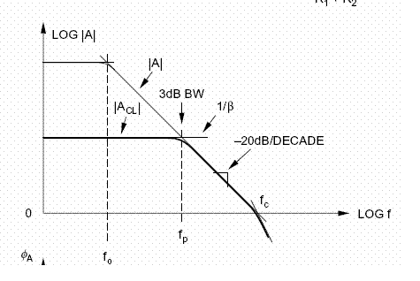

I'm guessing 20 dB at 20 kHz, with a 4 kHz open-loop bandwidth, resulting in 34 dB at low frequencies, and I'm guessing an essentially dominant pole rolloff. This based on some of the speculation by others. Please correct me if I am wrong.

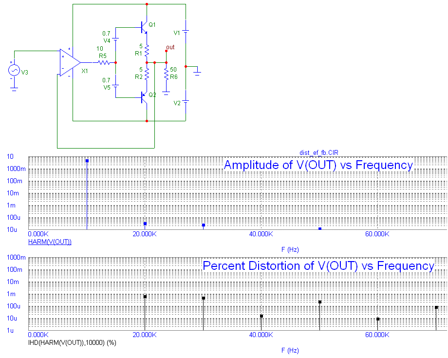

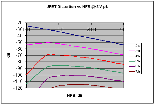

Those results are really nice! Great minds think alike. You beat me to the punch! For the last week or so I've been running simulations to answer the same question. I'll try to post my plots this afternoon, but here is a summary of what I did and found.
I first took the approach of duplicating Baxendall's results for the JFET in simulation. I wanted to duplicate the results to give confidence in the simulation approach. I was not able to find SPICE models for his exact JFET, but the one I used appears to be very similar, and the behavior of the circuit is like that of Baxandall's results.
The second harmonic distortion was down 25 dB from the fundamental (about 6%). Third through 7th harmonics start out very small without NFB, then increase as NFB is applied and increased, then beyond some key value of NFB they begin to decrease. That key value of NFB at which distortion peaks increases with the order of the harmonic. Third peaks at 6 dB NFB, while 7th peaks at 15 dB NFB (to put it in perspective, this seventh "peaks" at -115 dB).
Having verified that Baxandall's results could be duplicated with confidence in simulation, I then asked the question of whether his results were generally applicable. After all, he just did it for a well-behaved square-law device (and just a single stage).
Would it be the same for a BJT with an exponential characteristic, recognizing that the BJT would start with significant distortion products at all harmonics, even without NFB?
Would it be the same for a BJT differential pair? This is very relevant because it is a balanced circuit that is representative of so many complementary amplifier topologies used these days.
So I then did the simulation using a single-ended BJT instead of the JFET. The results were dramatic. There was no enhancement of harmonics as NFB was applied and increased. ALL distortion components decreased monotonically from the get-go as NFB was applied and increased. This really brings into question the relevance of the baxandall results in the general case in the real world.
Baxandall was brilliant, and there is nothing wrong with what he did. It's just too bad he was not able to take it further to more general cases. Of course, this is understandable because the analysis quickly becomes intractable much beyond a second-order nonlinearity.
I next did the simulation using a BJT differential pair. Pretty much the same, except that one can see a little bit of enhancement of the more benign even-order products that were very low to begin with. All odd-order products decreased monotonically as NFB was applied and increased.

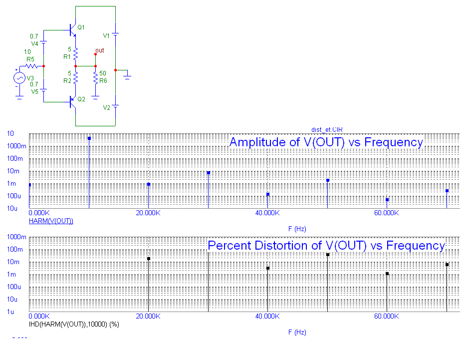

The next thing I'm trying is to see what the application of NFB does to the distortion components of an output stage in regard to its crossover distortion. Stay tuned.
Because the Baxanall results are a key underpinning of the concern about NFB expressed by feedback-averse designers, these results cast some new light on the controversy. All that can be said now is that if one builds a single stage, single ended amplifier with a JFET, one needs to take into account the Baxanall results. Anything else is likely to be a different kettle of fish.
No, he did this also for BJT in the last paper of the series, Feb next year
Please check your simulution as Baxandall _measured_ results for BJT exhibit enhancement of harmonics as NFB was applied
