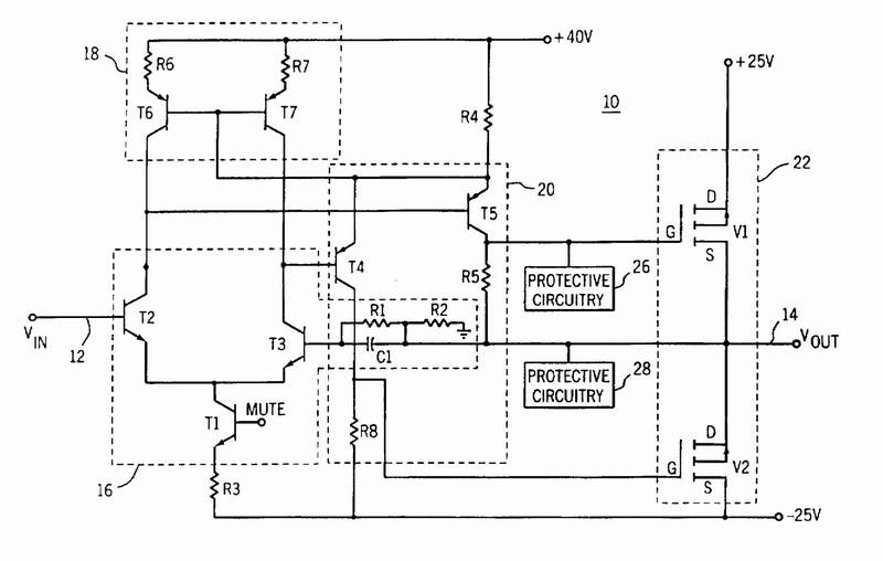

Hi, Mr. Cordell,
I wanted to ask you about this scheme. Your MosfetEC amp seems to use a sister of this scheme. It is from patent #5783970.
The goal of this patent is to get a very stable 2nd stage bias current.
While indeed this goal is achieved (through local feedback of VAS and 1st stage's current mirror), there is something that I'm not very clear.
T4 and T5's bases are driven from high impedance (collector of T6-T2).
Is this OK?
Shouldn't bases of T4-T5 is driven by low impedance (in ordinary amp, just a resistor to rail of differential legs gives low impedance to drive the VAS' base).
