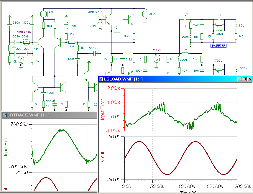

Pavel,
Did you check Graham's simulation in post #703 ?. I find it puzzling, probably you may see whether it makes justice or not to the EC output stage as presented there.
Rodolfo
Hi Rodolfo,
I have seen it, and the result is different from my simulation and especially from my measurements.
I also have seen that Graham used very different CCS current, and probably another component values. This may lead to very different results.
PMA [/i][B] Mikeks vs. Estuart: not very interesting to read said:Pavel,
Rodolfo

Edmond,
With no intention to offend in any way, I agree with Pavel there are other matters far more interesting to discuss than to watch personal exchanges. This is why I brought the simulation issue. 😉

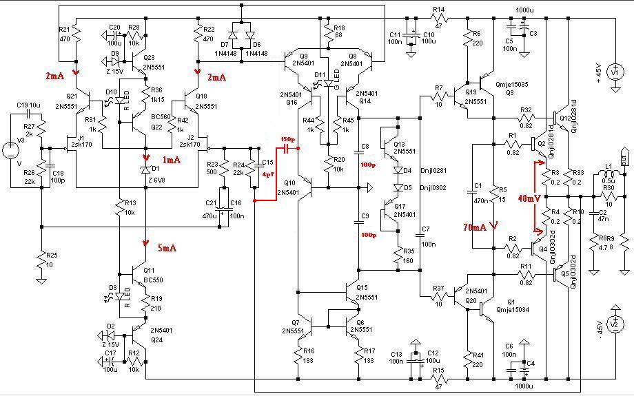

Hi all,
What do you think about this FB compensation methode?
http://www.diyaudio.com/forums/showthread.php?s=&threadid=99142
janneman said:
Widlar 😀
Looks similar to the LM108, as seen in this historical paper (.pdf format), in case anyone is interested:
http://www.analog.com/library/analogDialogue/archives/39-05/Web_ChH_final.pdf
Pete B.
roender said:Hi all,
Sorry guys, I made a drawing error.
This is the correct way and it's working, I just tested and it is stable.
