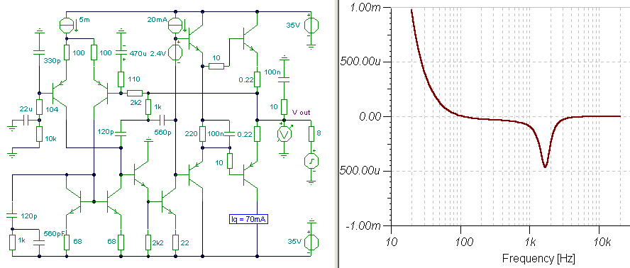

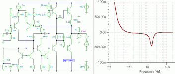

A modified 'blameless' type circuit was shown above with two additional components around the VAS. Mike and I showed that the inner loop showed a degree of peaked response. This response will improve 'thd' at say 10kHz - but - for steady sine only - not loudspeaker music reproduction - though the Sims do not show this !!!

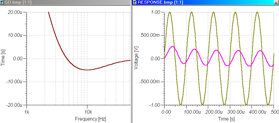

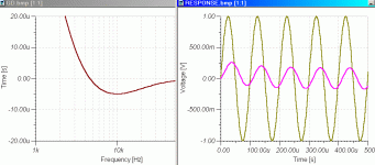

See from this attachment what that arrangement does to group delay for the damping response.
Where group delay varies, then all coincident waveform amplitudes become affected due to fractional voltage superimposition, and I am actually quite shocked to see such a large variation where our hearing is so sensitive.
I know from years of Simulation that this is due to a phase shifted damping response due to bandwidth control within the global NFB loop - and yet SO MANY current designs still do it !!!

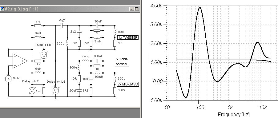

When loudspeaker back-EMF causes leading current flow wrt to voltage drive, the 'group delay' can become negative.
I illustrated this by computer simulation with a virtual loudspeaker causing group delay to become negative in my 2004 EW writing, and was sumarily castigated for showing 'voltage waveform arriving at a louspeaker before it left the amplifier'; a resultant which can actually arise in the real world too. Thus amplifier circuitry can/does cause hf waveform distortion wrt the fundamentals we hear when the loudspeaker system is reactive at those fundamental frequencies, this being on an independent - per channel - basis which can affect the stereo image.
C+L+R filters, networks and loudspeaker drivers/cabinets do not behave like propagation/waveguide blocks prior to steady wave development ( ie. when the waveform is music ) and where this impacts upon amplifier capabilities, these 'conventionally linear' components can generate extremely non-linear interaction responses within 'NFB linearised' amplifiers, esp when the natural open loop response is rendered inadequate at AF by stabilisation componentry.

An amplifier like some of Nelson's producing a purely current output wrt voltage input, is thus not going to generate NFB induced reactions due to loudspeaker characteristics, but then the loudspeaker itself will resond differently when compared to voltage drive. Thus different loudspeaker types produce different responses with the two different amplifier types, and not all types of loudspeaker are equally suitable to both types of amplifier.
Of course 'pure voltage follower' output stages will not generate the same NFB (SS) sound within their class-A operating range either if the NFB loop does not enclose them, though followers running in complementary class-AB might still pose some loudspeaker back-EMF related problems.
And there is always;-
http://www.diyaudio.com/forums/showthread.php?s=&threadid=42259&highlight=
though my choice has been to use NFB, but specifically minimise load current induced voltage reactions in time.
Above I wrote that I had not thought of testing 'reverse' group delay for amplifiers, though I have done it on my own recent circuits. It is just that mine don't react like that in post#788 above, so I did not think any more of it in relation to circuits I was not interested in.
Cheers ....... Graham.

Here's another. A simulated perfect amplifier driving R and a virtual LS via series output choke//resistor. Flat group DELAY with the resistor; group delay due to LS varies +/-2uS wrt to R voltage, and actually becomes negative due to LS resonance.
This can affect crossover in class-AB circuits also NFB loop responses. Room length cables have similar inductance in series with their low R. Thus LS terminal V is not coherently corrected wrt source voltage at the amplifier's input socket.
C+L+R circuits cannot be viewed as if radiation waveguides or propagation mediums.
Cheers .......... Graham.

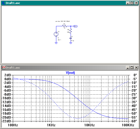

Hi Adam,
If one were to consider a constant group delay with frequency, then a negative group delay would imply a non-causal system which is of course unrealizable. But it's quite easy to give an example of a simple circuit which at some frequencies will have a negative group delay. All that's required is that the slope of phase vs. frequency be positive at some frequency or range of frequencies.
The simple circuit below has a negative group delay at frequencies above about 5 kHz.
Hi Andy,
Att. The group delay for your circuit, and the response we all know.
There will be those who say you musn't test with a suddenly starting sine, but failing to do so merely covers up the problem.
A debate could also be about what degree of group delay change becomes audible at any frequency, though where it becomes important is with loudspeaker loads and NFB loop controlled voltage amplifiers; esp. class-AB.
