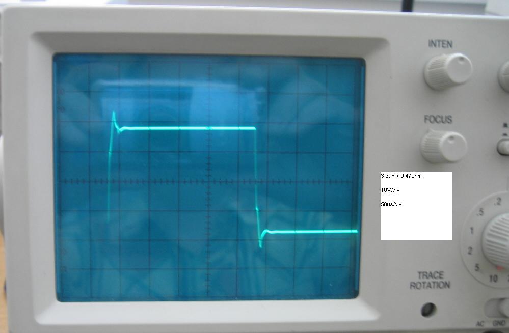

This is quite similar to what I actually test, and I get lower overshoot without the output coil. I can repeat the test after I catch some time and then I can show scope pictures.

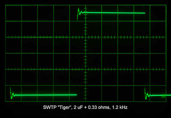

Well, I ran the series of tests and discovered something interesting- I don't seem to need an output coil at all. Also, testing with inductors showed nothing at all, and I used some pretty nasty high Q devices you'd never find in audio equipment of any type. But...
The worst case was the 2uF and no 8 ohm parallel load. (I used .33 ohms in series, because that was what was in the junk bin). Though the overall overshoot and ringing wasn't bad (I dunno, you guys tell me), the character of it disturbs me a bit. Here's the long view- the amplitude doesn't seem to matter, it always looks the same, but this was 2V/cm:

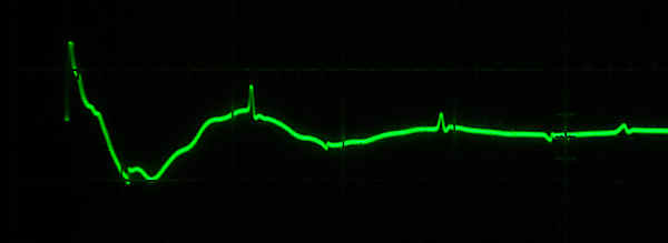

Blown up on the scope and in the computer afterwards, you can see the small spikes on each cycle. I don't like this. Do you think it means anything, or have a clue as to what causes it? BTW, my "scope camera" is me standing in front of the scope with a camera!
Also, FWIW, I messed around with the bias, worried that stability would be bias dependent. No effect at all.

Conrad Hoffman said:Blown up on the scope and in the computer afterwards, you can see the small spikes on each cycle. I don't like this. Do you think it means anything, or have a clue as to what causes it? BTW, my "scope camera" is me standing in front of the scope with a camera!
Hi Conrad,
I wonder if those spikes might be some kind of crossover distortion occurring in the output stage as the ringing current changes polarity. I admit that I don't see how this could be, since the square wave current would still seem to dominate and keep the other side from turning on.
If I understand correctly, this photo was small-signal square wave observed at the amplifier output with no coil, and loaded with 0.33 ohms in series with 2.2 uF?
Thanks,
Bob
Conrad Hoffman said:Well, I ran the series of tests and discovered something interesting- I don't seem to need an output coil at all. Also, testing with inductors showed nothing at all, and I used some pretty nasty high Q devices you'd never find in audio equipment of any type. But...
What was the signal source? Could D/A artifacts be the culprits? They look suspiciously regular in time (tell about the time scale in the photos).
Rodolfo

I have no output coil. And measured without input RC filter.
Pavel
P.S.: Hope to measure again during this weekend.

Interesting thread on the Tiger amps, and so as not to derail this one, I'll add some comments there, if I still can. IMO, Universal Tiger circuit stability has far more to do with layout and wiring, than it does with the circuit itself. I've only recently (after using mine trouble-free for 30 years!) come to fully appreciate this.
This weekend I'll look at the current in various locations and see if I can figure out what those spikes are. I have some guesses, but it's too soon to say anything. The generator used was a Wavetec 185 analog type with a 50 ohm output. I terminated the cable at the amplifier end with a 50 ohm terminator, so the edge applied to the amp was about as good as one would hope for. With and without the input network was slightly different, but the basic problem was still there. Note that the amp will happily drive a 3 uF cap without any series resistance at all. The cap sings and a polyester cap will actually heat up, but the amp does just fine and the waveform isn't much different than shown above. Still, I think it's a good idea to keep that .5 ohms (.33 in my case) in series with a 2 uF cap, so as not to abuse the output stage too badly. No, my amp has no active protection other than an output fuse. "I built it. If I blow it up, I can fix it."

Conrad Hoffman said:....
This weekend I'll look at the current in various locations and see if I can figure out what those spikes are. I have some guesses, but it's too soon to say anything. ...
If - as I guess it is - there is a CFP output, and moreover uses MOSFETS, take a look at the gate (base) - rail voltage and see if there is an abrupt transition coincident with the spike.
Rodolfo

Conrad,
I would not worry about those small perturbations. (I know the feeling, but don't be a perfectionist like me - as divorced from realism - it makes life awful!) If your amplifier is stable under all conditions that you can think up, all these can do (very academically) is cause overload some 0,5dB before the real overload - big deal! But as DIYer I also investigated where I had similar appearances, and I found them on the power rails, different at different parts of the layout, even different depending on where I earthed the scope probe. An extremely small capacitor somewhere sometimes helped, but as said, necessary??
