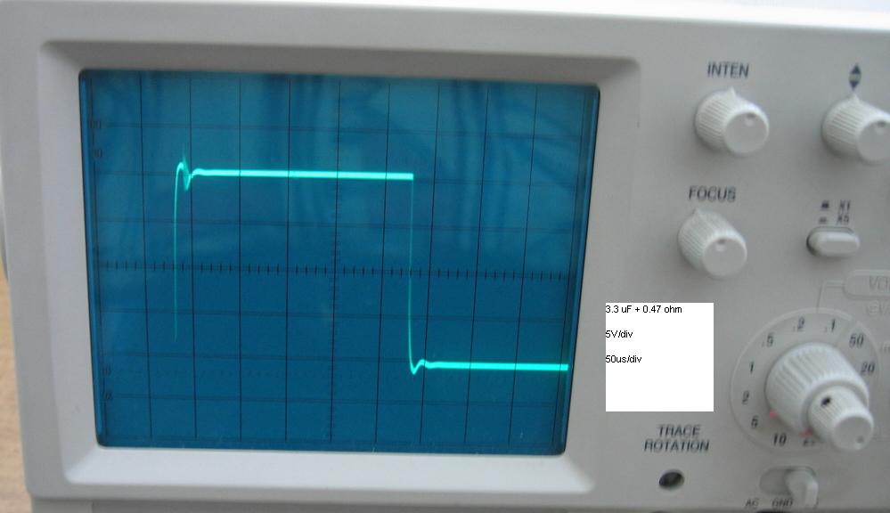

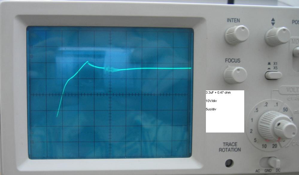

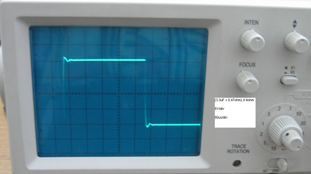

PMA said:Load (3.3uF + 0.47ohm) // 4ohm
5V/div, 50us/div
Due to 4ohm resistor in parallel to R-C fast oscillations disappeared.
(no coil, no zobel, no RC)
Thick traces mean only shaking camera in my hand, not oscillations.
Thanks for providing these informative shots. I'm guessing that where you saw the oscillations, it might be where the amplifier came out of slew rate limiting, but I'm not sure. It might also have been coming out of some kind of current limiting situation. Good work. I wonder what the small-signal shots would have looked like.
Bob
Bob
The small signal shown is about 40-45% of the maximum output amplitude. For smaller output signal, the step response starts to look exponential-like. Probably slew rate limitation or dI/dt limitation (as you have already said) causes peaking of the step response.
Pavel
