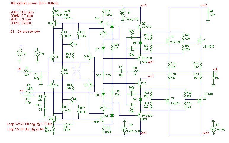

Re: Re: Re: Re: Re: Re: Re: Output impedance of Hafler DH220
Or this one. It outperforms a blameless in many aspects, despite its simplicity.
Bob Cordell said:Hi Glen,
The Hafler is the most well-known MOSFET amplifier on the planet. Measurement if it is sufficient to blunt your overly-broad generalization about MOSFETs.
You will always be able to conjur up an example of where your assertion is correct. There are plenty of less-skilled designers out there who can screw up a perfectly good MOSFET amplifier to get the high output inductance scenario you mention, but there are just as many fools who can get terrible performance out of BJTs.
I thought we were here to discuss design tradeoffs among technologies that are applied with at least some amount of reasonable engineering.
Bob

Re: Re: Re: Re: Re: Re: Re: Re: Output impedance of Hafler DH220
So this is, along with the DH-220, is another design which negates my comments, as restated here: ????
http://www.diyaudio.com/forums/showthread.php?postid=1228856#post1228856
estuart said:Or this one.
