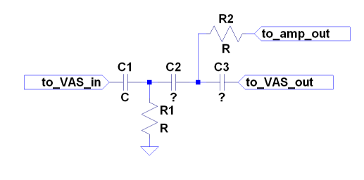

Mike,
I just tried a real quick sim of this comp network and saw some distortion improvements. I made C2 and C3 each equal to 2C (don't have any idea if that's right or not BTW - it was just a quick guess). It looks promising. Puts the output stage in the local VAS feedback loop at low freqs but gets it out of the way at high freqs So it prevents the local loop instability that output-stage-inclusive compensation has (Cherry's "world's cheapest oscillator" trick 🙂 ).
mikeks said:
Have you examined major loop transmission at 20KHz for before/after improvements?
Yes. It was actually about 4 dB less with the modified configuration above than the original (standard two-pole comp). Unity loop gain frequency was about the same. I think more improvements are possible. I want to understand this better - not just component values, but maybe the topology itself could be improved. Ideally, I'd like the major loop transmission to be unchanged, and have the output stage get out of the minor loop at maybe 1 MHz or so (not sure).

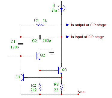

And for those who are intending to run a sim, please use a VAS, as depicted below. Don’t use a Darlington, by tying the collectors of Q2 and Q3 together. The Early effect and Cob modulation of Q2 spoils the whole thing.

Hi Mike,
Apparently, you doesn’t understand much of my compensation. At least Tim__X does. At one point you are right: Enclosing a power BJT output stage provokes local instability, that is, at fairly high frequencies, 10…20MHz. However, at frequencies that high, my circuit behaves just like a traditional Miller compensated amp and is rock stable. Maybe you should have a closer look at my diagram (it’s clear enough I think) and discover that I don’t use just a single resistor to prevent instabilities, rather an RC network. As a result, below 230kHz, determined by the time constant R1*(C1+C2), my arrangement behaves just like Cherry’s thing, above that frequency, it slowly revert to a conventional and safe scheme, as I said before.
Regards.

Hi, Estuart,Your schematic in post #497, how to determine the value of C1-C2-R1? Is there any paper/article about it?
Hi lumanauw,
The equivalent series capacitance of C1 and C2 should be equal to the original Cdom. The are no strict rules for choosing C2 and R1, but the impedance of network C2 & R1 should chosen such that it is not too much loaded by C1. So, if C2 is 5 to 10 times C1, it’s OK. Regarding R1, see my previous post.

estuart said:
Exactly, that’s the crux. Chapeaux!
See below for this simple but valuable trick.
Note: It doesn’t work without a preceding beta enhancement transistor in the VAS stage. Probably, that’s why D. Self misunderstood the potential of this subtle modification.
Who originally came up with this form of compensation?
It seems to be a fairly nice and inexpensive trick. As described by others, it looks basically like Miller compensation taken from the output of the power stage, but then bypassed (transitioned) to use the more stable output of the VAS itself by C2 and R1 at a frequency on the order of 250 kHz. I think that this topology might benefit from connecting C2 to an emitter-follower (fast) buffered output of the VAS. This would isolate the VAS from currents flowing in R1. This emitter follower could just be the first guy in the output triple.
Double pole compensation has value, but it needs to be used carefully. There are not too many truly free lunches. However, careful selection of its component values allows one to exercise a tradeoff between minimum phase margin and amount of loop gain enhancement it delivers at 20 kHz.
A more generalized approach is to seek a loop gain rolloff on the order of a constant 9 dB/octave, which gives a phase margin on the order of about 45 degrees. This is just a compromize between the conservative 6 dB/octave and the deadly 12 dB/octave. Indeed, double pole compensation ("T" compensation as it was called at Bell Labs in the 1970's where we integrated it into op amps) can be thought of as just one form of approximation to 9 dB/octave compensation.
