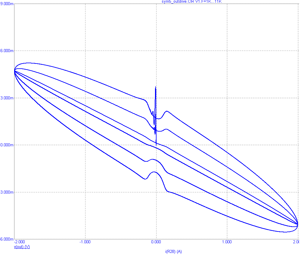

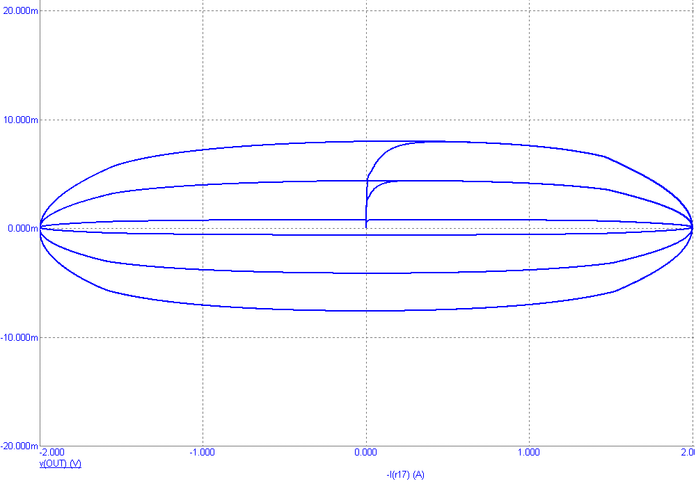

Hi PMA,
I find it disconcerting that you argue against me and then post your own useful reverse driven amplifier investigations with a suddenly starting 10kHz sine.
The first graph (class-AB) shows the applied current producing an initial error due to propagation delayed (C.dom or choke?) NFB control failing to maintain control, and then cycling with phase shift and showing crossover distortion.
The second appears to have a good low output impedance damping of an initial sudden start (or is this bandwidth limited?)and a good damping phase response, though maybe not linear. The error amplitude appears to be approx 7mV (~ minus 66dB) for an equivalent of 16V at 8 ohms, though of course the amplifier output stage has it easy when it is merely attempting to maintain zero output volts.
Cheers ......... Graham.
Hi Graham,
I am sorry if my behaviour looked like you described, it was not my intention.
I posted the pictures to show the method that I found useful for evaluation of output stage crossover behaviour and its frequency dependence. When you plot these curves for increasing frequencies, you can see broadening in Y axis (lowering DF for higher freq.). The plots shown are for 10kHz. Accidentally the plots show initial transient as well, as the sine is started with zero voltage and current.
Best regards,
Pavel
Hi PMA,
You wrote >>Accidentally the plots show initial transient<<
Actually, the examination of that initial spike, although no signal will do this in real life, is an essential pointer as to how good the amplifier is likely to be !!!
Low bias amplifiers rely upon NFB to actively generate a low output impedance, and the initial spike of a suddenly starting 10kHz sine used to reverse drive the output teminal of an amplifier is an excellent way of examining NFB loop controlled amplifier capabilities.
The less the bias and the slower the amplifier (bandwidth) the higher/longer the spike.
Fast class-A amplifier spikes are more shallow and short, whilst of course the error curve is smooth due to lack of crossovers.
Also the nature of the spike on any reverse driven crossover error settlement inicates stability and speed of the NFB loop. A shallow or very quickly controlled class-AB spike could likely prove inaudible.
What is noticeable in your first plot is the amplitude asymmetry of the crossover plots arising long after the sudden start. I have outlined before that a leading back-EMF can reverse drive an output stage through a fraction of its output bias voltage at zero current crossovers before the NFB loop can re-establish control, and your first graph shows this happening.
The suddenly starting sine, whether forward or reverse, really is a good amplifier examining tool and there is nothing 'accidental' about it.
The second plot also concerns me because the error is greatest when the applied reverse drive passes through zero, the maximum rate of change !
A good amplifier plot ought to pass close to zero on this simple test, so here there is a loss of zero recovery or zero reference, possibly due to slewing inability or some form of feedback/feedforward control.
Cheers .......... Graham.

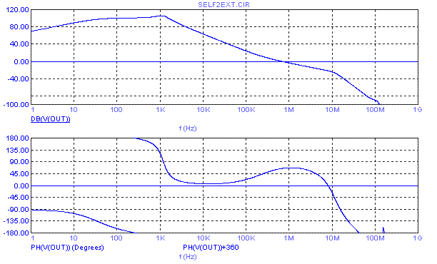

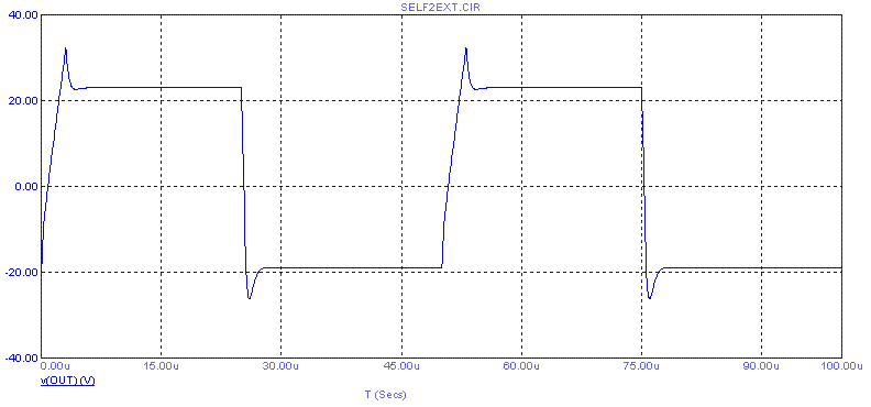

Re: Re: Class-XD
mikeks said:
Any particular reason why it's ''....not a favourite....''?
Hi Mike,
Look at the phase response of the global feedback loop and at the step response. That's why.
Cheers.
