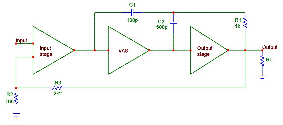

Hi Mike,
Let’s go back to alternatives for class-XD.
I wonder why D. Self hasn’t opted for a far more simple solution, consisting of a slight modification of the Miller loop. Only one additional C and R are needed, giving a thd reduction of 80% or more. (No, it’s NOT a two pole compensation). It’s a very old trick, as far as I know, first pioneered by Baxandall. Curiously, D. Self does know about it, but for some reasons, he has rejected it. Why?! That is my point.
Hi Mike,

Re: Class-XD
Hi Edmond,
I assume you're referring to a C-R connection between the output and the inverting input of the amp.?
If so, then it is lead compensation, and it was not, as far as I know, first developed by Baxandall.
Alternatively, if it is assumed you're referring to the connection of a small resistor in series with the Miller capacitor, then you'll accomplish exactly nothing in respect of linearity, since this resistor's only raison d'etre is to provide nominal cancellation of the RHP zero occasioned by the HF feedforward path through the Miller capacitor. This, incidentally, is of no consequence in an amplifier with a BJT transimpedance stage.
estuart said:Hi Mike,
Hi Edmond,

Hi Mike,
Nope. Neither of the two. I’ll give you one more change to figure it out.
As an expert on this subject, I’m convinced you will find the answer.

I'll defer to you: enlighten us.
estuart said:
Hi Mike,
PS: Now, I'm going to my local pub, see you later.

I think Estuart is referring to a Cherry-esque second miller loop containing the output stage, with an R in series so that the traditional miller loop becomes dominant at high frequencies to maintain the original stability.
Tim__x said:I think Estuart is referring to a Cherry-esque second miller loop containing the output stage, with an R in series so that the traditional miller loop becomes dominant at high frequencies to maintain the original stability.
Enclosing a power BJT output stage provokes local instability even with a series resistor.

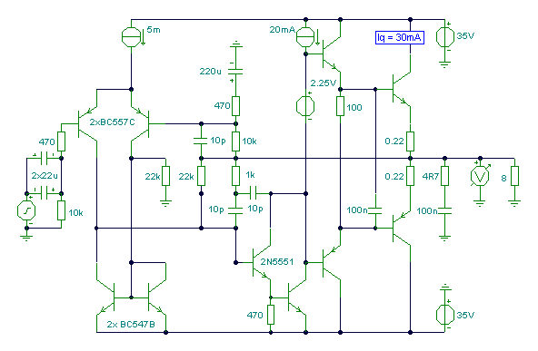

Exactly, that’s the crux. Chapeaux!
See below for this simple but valuable trick.
Note: It doesn’t work without a preceding beta enhancement transistor in the VAS stage. Probably, that’s why D. Self misunderstood the potential of this subtle modification.
Using a resistor from output to Darlington VAS base can also help to reduce output stage crossover distortion and improve NFB response by flattening the open loop bandwidth.
Using an equal value resistor from other half of mirror to ground prevents start-up thump and preserves differential input balance.
This is a Sim demo cct only.
Cheers .......... Graham.
estuart said:Exactly, that’s the crux. Chapeaux!
This accomplishes nothing as far as linearity is concerned: loop transmission at 20KHz is typically 25dB~30dB, while DPC can be persuaded to deliver ~60dB at the same frequency.
