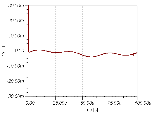

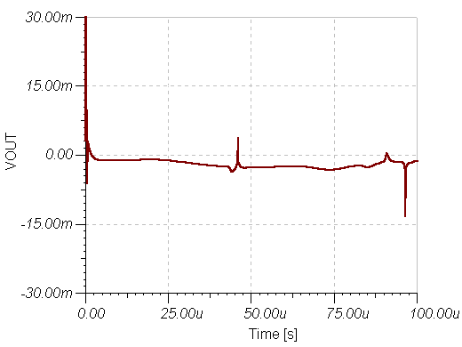

Hi lumanauw,
Yes sure. But actually I don't understand your question, as Lars Clausen's amp as well as mine, don't already has Miller compensation (directly) around the VAS. So, could you be more specific?
Hi Edmond,
You are challenging Mike but ignoring my (amatuer) simulations of your own feedback circuit shown above.
Connecting such high a C to the VAS collector is deleterious.
Connecting a C to the output node and introducing a phase shift back to VAS base 'tunes' the internal NFB response to give a measurable steady sine measurement improvement at higher AF.
The global response is not changed, but the inner loop is. This renders the output stage susceptible to transient error and fractional phase shift load induced reverse crossover bias slewing due to phase shift between output node and VAS base before the global loop can re-establish linearity via the differential pair.
Please show us how you established your findings in case there is something else here we need to study.
Cheers .......... Graham.
darkfenriz posted before I could correct.
'Connecting a C to the output node'
should have been
'Connecting a R-C to the output node'
(Ground connection for the intermediate resistor has same effect on dynamics, though a different THD result.)
I tried these schemes in the 70's and whilst it was possible to 'spec chase' as far as THD is concerned, the improved figures were of no benefit to reproduction and could make the sound less natural.
Cheers ........ Graham.
