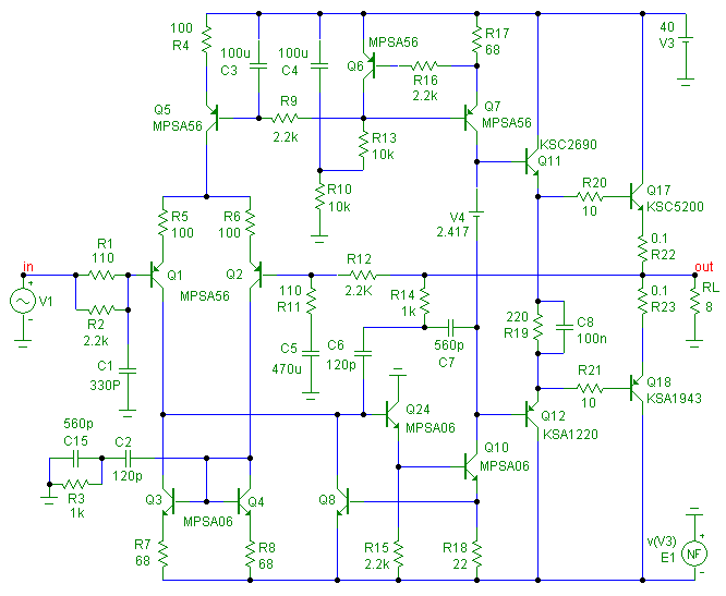

Hi Graham,
Look at this, I hope it helps.
darkfenriz said:Edmond
How is stability on capactive loads affected?
Hi darkfenriz,
Almost nothing. With a relative large capacitor, directly tied to the output, that is, before the Zobel network, ringing becomes slightly more.
Notice: Although not shown in the diagram above, I simulated the effect of the twisted leads tot the output devices as well by means of series inductors of 50nF, mutually coupled with K=0.8.
btw, I'm eager to hear the comments on the role of C2, C15 and R3.

This passive network seems to symetrize impedance to ground of LTP collectors and probably improving PSRR, but I am not sure it works as intended.
andy_c said:
I think the intent of this circuit was to behave more or less like single pole comp, but including the output stage - while eliminating the instability problems of Cherry's proposal of simply hooking the Miller cap to the output. In that sense, I like the idea a lot. It's also good that it's stimulated some discussion and further thought. That keeps things lively and interesting. Cherry's response was simply one of denying any problem. But anyone with LTSpice with its loop gain probe can see that his proposed solution is potentially disastrous. In contrast, this is a constructive approach offering a solution and providing much food for further thought.
It appears to me that the high loop gain advantages of two-pole comp could be realized, along with stable inclusion of the output stage in the minor loop. I touched on a possible approach in an earlier post but haven't developed the idea fully yet. But I think this will take three capacitors. Such a solution could be compared unfavorably with a hypothetical three-pole comp in terms of the loop gain- but would that be fair? I think not.
In fact, I think the extra capacitor is a small price to pay for being able to include the output stage in the minor loop without incurring minor loop instability. In my view, this whole idea deserves lots of study and could lead to improved designs.
Andy, I agree completely. The concern about two-pole compensation was not that it did not provide good distortion reduction, it was with respect to its phase margin characteristics. This approach may not provide quite as much distortion reduction, but does not appear to compromise phase margin as much.

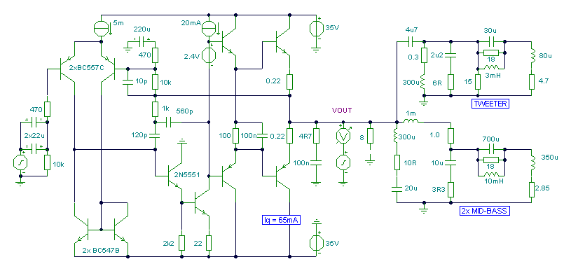

Hi Edmond,
You have lower input resistances at the diff-pair which I too prefer, and I see the capacitors at the mirror having much lower value than one of my own circuits (maybe tuned again) but there is otherwise little significant difference to the circuit I checked out.
As below.
Thus I feel the main difference between our approaches relate to examining output stage behaviour, and simulating with a load capable of introducing complex phase shift for a couple of cycles after sudden start (of which the first quadrant may be ignored for those who would wish to limit bandwidth considerations).
My test circuit uses an approximation for the DIY 'Ariel' loudspeaker (which has a higher crossover frequency than many simple designs) and I subtract an equal amplitude but fractionally phase shifted potential from the output voltmeter reading to view the output residual.
The steady sine THD figure was approx 0.002%, but the crossover spikes were not insignificant.
Cheers ........... Graham.

The thread moved on whilst I added text and copied the test circuit
Edmond wrote >
These components balance mirror action out at the rail wrt (signal) ground.
I use resistors on both halves of the mirror as illustrated in #498 above - resistors keep the local output feedback linear so that the effect of dynamic loudspeaker loads does not generate a reactive response within the global loop; ie. clean sound.
The 10pFs in this illustrative circuit are likely too low, and will need to be properly established.
Cheers .......... Graham.

andy_c said:
The sim I did with the minor feedback loop I showed was of my own amp design - not anything anyone posted here. Furthermore, the network I posted had no component values at all. So I don't think you can reach any conclusive results, because the info I posted was not sufficient to do so.
I'll put a loop gain probe in the inner loop, re-run the sim and post the results tomorrow.
Hi Andy,
Actually the component values are rather easy to sort out. For a start the series combination of all three capacitors in your modification should be equal to the equivalent single-pole Miller compensator if the forward-path's unity gain frequency is to remain unchanged.
For the same reason the component value in Edmond's arrangement should be identical to those selected for the equivalent DPC network.

Andy, below is conceptual circuit of your arrangement with the net loop gain experienced by the output stage available by merely plotting the following expression:
-1/(1-1/(2*(I(Vi1)@1*V(x)@2-V(x)@1*I(Vi1)@2)+V(x)@1+I(Vi1)@2))
