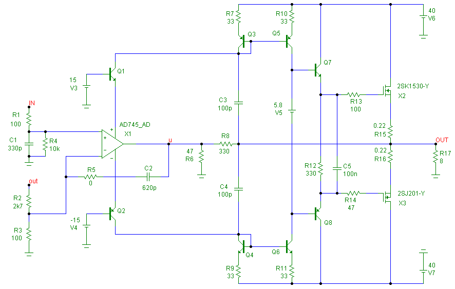

Hi Glen,
Here's the original Alexander amp:
http://www.analog.com/static/import...tes/58052492001115525484056221917334AN211.pdf
(contact me for a less cluttered schematic)
And below a very basic NDFL variant stripped down from all bells and whistles for clarity, hence a mediocre performance.
Edmond.
PS: I can't remember how I've calculated the various RC values, as it is too long ago, but the step response looks okay.

That's a pretty good summary, and mirrors my understanding as well. With one amendment: to me, NDFL is nothing more than a particular case of NPC (N pole compensation) or otherwise put, TPC is a particular case of NDFL. Or even otherwise put, NDFL is a TPC generalisation.
Edmond.

Thanks Edmond, I'll give it a look.
Glen
At your service.
But don't put your expectations too high, as it was only meant as an explorative experiment.
Edmond.

Bob,
The Halcro patent is US 6798285.
He is basically describing an NDFL involving 1st and 2nd order filters.
Attached is an LTSpice model to play with, using the component values and CL gain of 30 as per the patent. I've assumed a 10MHz bandwidth OS. The circuit applies 144dB of excess gain at 20kHz and it rings like a bell with these values.
In an earlier post I estimated that the critically damped excess gain of a simple four (1st order) stage NDFL is 102dB, assuming a 30dB CL gain.
Brian
