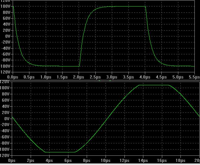

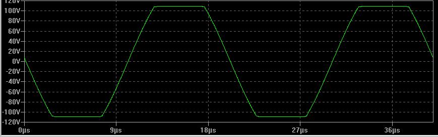

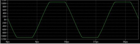

Regarding "transient perfect" amplifiers, do you remember my K12A TMC amp, fully differential with the I-mirrored LTP's?
Well with the type of compensation above applied that is exactly what it is.
It also has ship hot slewing performance because the VAS peak current limits at 6 times the standing current (thanks to those current mirrors on the LTP's).
I'm developing a quad of these (modified for +/-80V rails) for a monster fully balanced (bridged) stereo amplifier I'm putting together, christened the "Beast".
Here is what I get for the squarewave and clipping response with excessive (to be on the conservative side) compensation and load capacitance on the VAS collector

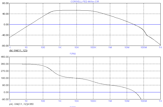

Take that schematic of BC's amplifier attached. Suppose the Miller loop is to be compensated with an RC from the VAS collector to ground instead of as a shunt on the LTP.
Where does the loop gain probe go to investigate the Miller (not the global) loop phase margin? I'm getting results that don't make much sense at the moment.
Glen
As I said before, at the obvious place.
If the new R=100 Ohms and C=100pF the result is not really promising. PM = only a few degrees.
edit: probe between C4 and R13
LOL!
That is the same result I got, but I didn't think it was right as I needed such a huge capacitance on the VAS collector to get a decent Miller loop phase margin.
Bob Cordell suggested compensating the Miller loop this way to avoid the rail sticking caused by the RC on the LTP (I raised this issue in this thread a month or so ago). However it seems rather ineffectual for some reason. It is midnight now and my brain hurts, but I wonder if in trying to compensate the Miller loop this way one is fruitlessly fighting against a pole-splitting effect?
